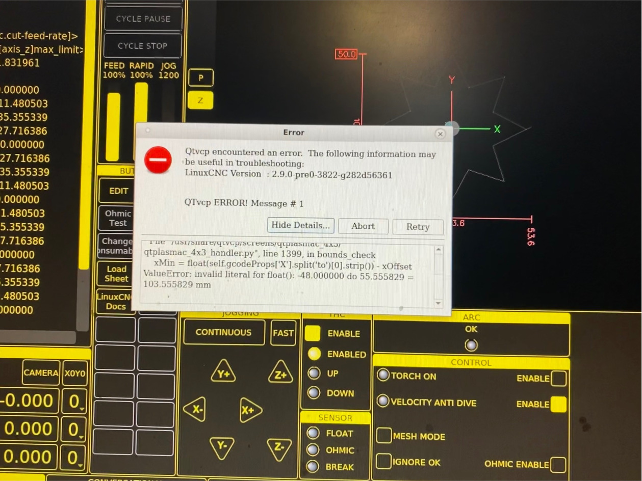

What version of QtPlasmaC are you on? It is located in the header of the window. It should be v1.0.x
Also, assuming you are on a later version, could you post the g-code you are trying to run?

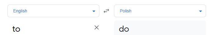

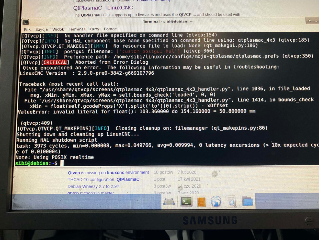

Sorry had a break in the meeting I am in so I took a look at this a bit closer. What language have you chosen for the machine?
It looks like it's because it expects 'to' and your string contains 'do', which I am guessing is from the language of the PC.

Linuxcnc is in Polish, I will try to convert everything to English. I'll check when I'm at the machine. Good lead, it might help. Thank you very much. I'll let you know later.
