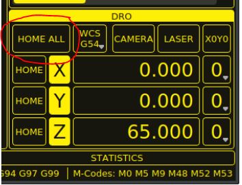

hello all,
couple questions.
so trying to switch to the new qtplasmaC, when start up i get some errors , see attachment. anything to be concern about?
second - do i need to add a axis home button?
third - how does one change the colors in the GUI, not a big fan of the yellow,myself '
thank you,

1. Nothing to be concerned about. Standard warnings.
2. I'm not sure I understand your question. Are you asking about A axis, or "an" axis home button?
3. see "GUI SETTINGS" in this section: linuxcnc.org/docs/devel/html/plasma/qtpl...ml#qt_parameters-tab
Lots of good stuff in the manual, definitely worth the read, even though some of it is a bit dry.

Thanks for the info, question Two referring to homing button for all the axis.
Oh will re read the manual again...

What!!! Man I how did I missed that! When I get home I will double check. It’s the yellow color
