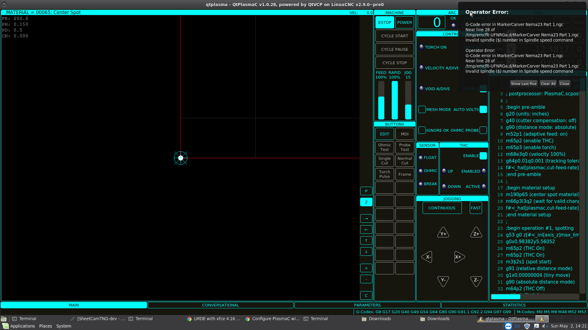

I seem to be having an issue with multiple tools. I've enabled multi-tool in the plasmac_connections.hal file and have Phil's sheetcam config. I get the following error when I have a center-spot tool enabled in my gcode however.
Also there seems to be some sort of bug when you M3 $0 on an MDI. watch your z-axis as it goes up and down on it's own. The cycle-resume is flashing. weird.

I do see the weird stuff with torch start in the MDI.
M3 $0 actually works for me. M5 $0 cancels it
M3 $2 S1 in the MDI causes problems as M5 $2 or M5 $-1 or esc do not cancel it. And you are right, if it gets to the bottom cycle start will blink (and escape won't reset it here either).
A better way to start the torch manually would be with the F9 key.
I imagine it may be best to disallow M3 commands from the MDI.
At any rate, I tried adding M3 $2 S1 to a g-code file and that worked.
Is it possible for you to post a backup of your config (made in the parameters (or settings if it's there) tab), and the gcode file you are trying to run?

whats weird is that M3 $1 works. but not M3 $2. So no idea.

and I just found the issue. in qtplasma.hal SPINDLES = 2 should be 3

EDIT: I think you mean qtplasma.ini. qtplasma.hal points to the traj section of your ini file.
I believe you can get rid of all of these as well.
Replied by snowgoer540 on topic qtplasmac multi-tool
Just came to post that, good thing I refreshed first.
DEFAULT_SPINDLE_0_SPEED = 0
DEFAULT_SPINDLE_1_SPEED = 0
MIN_SPINDLE_0_SPEED = 0
MAX_SPINDLE_0_SPEED = 1
MIN_SPINDLE_0_OVERRIDE = 0
MAX_SPINDLE_0_OVERRIDE = 1
MIN_SPINDLE_1_SPEED = 0
MAX_SPINDLE_1_SPEED = 1
MIN_SPINDLE_1_OVERRIDE = 0
MAX_SPINDLE_1_OVERRIDE = 1
