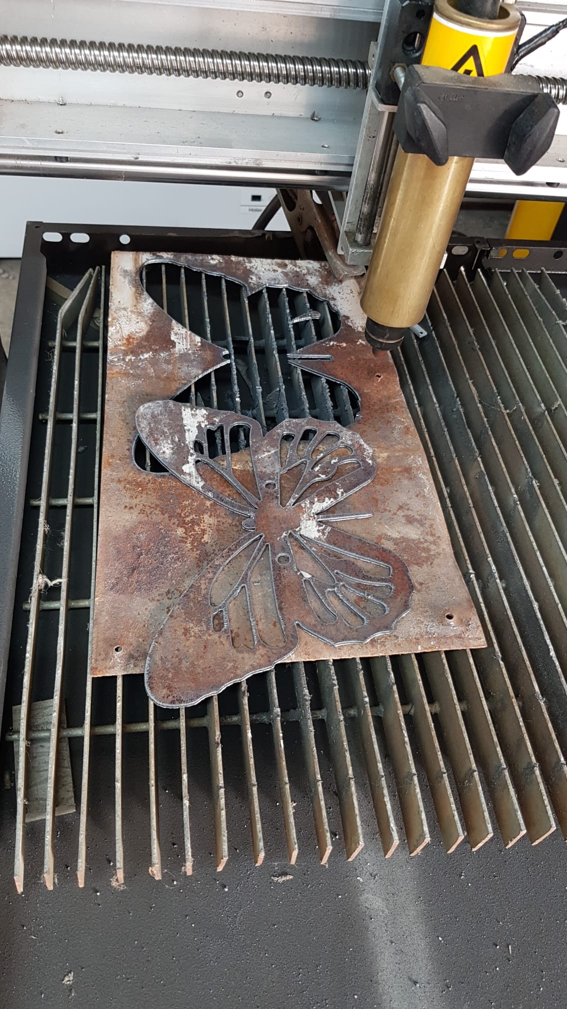

14 Jul 2021 10:37 #214714
by billykid
Replied by billykid on topic qtplasmac error
surely it is a simlink problem .. i will solve it. this cut was made days ago with plasmac, the thc did its job well on an old twisted sheet more than 10 mm thank you !
