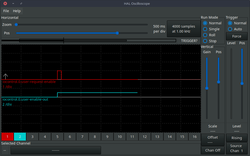

This took a bit of sorting out but I eventually found the bug.
When you use estop latch, it requires a reset signal to take it out of estop.
According to the documents, and posts by Bevins and BigJohnT, this reset signal should be connected to
If you fire up an axis sim or even an early QTplasmac sim (pre estop modes) and monitor this signal in halscope, you will observe a pulse on this signal when the GUI estop is pressed. This is what resets the latch.
When I monitor this signal in QTPlasmac, there is no pulse so the latch is never reset.
Myself, Bevins and BigJohnT are some I know who use estop-latch. In my case I use it to create a chain for 3 estop buttons which has worked flawlessly until I tried to use QTplasamc.
Surely, it not prudent for a GUI to not fully support estop functionality.
Can this be fixed please?
I know it could be worked around with some hal logic, but really the features of estop latch are there for a reason so I don't really want to do something half arsed with estop.

QtPlasmaC uses a stock QtVCP actionbutton for estop. The estop modes only affect how the button appears in the GUI and whether or not the button is enabled, not the function of the button.
In the sim it may have been hal connections that did the work. A look at the Axis code shows no reference to iocontrol.0.user-request-enable so it may well be hal connections there as well.
I just switched mine to estop mode 2 and when you press the estop button to go out of estop it pulses iocontrol.0.user-request-enable.

Replied by phillc54 on topic QTPlasmac and estop-latch broken (no iocontrol.0.user-request-enable)
I couldn't see it in halshow but it is consistent in halscope, probably a bit quick for halshow.
