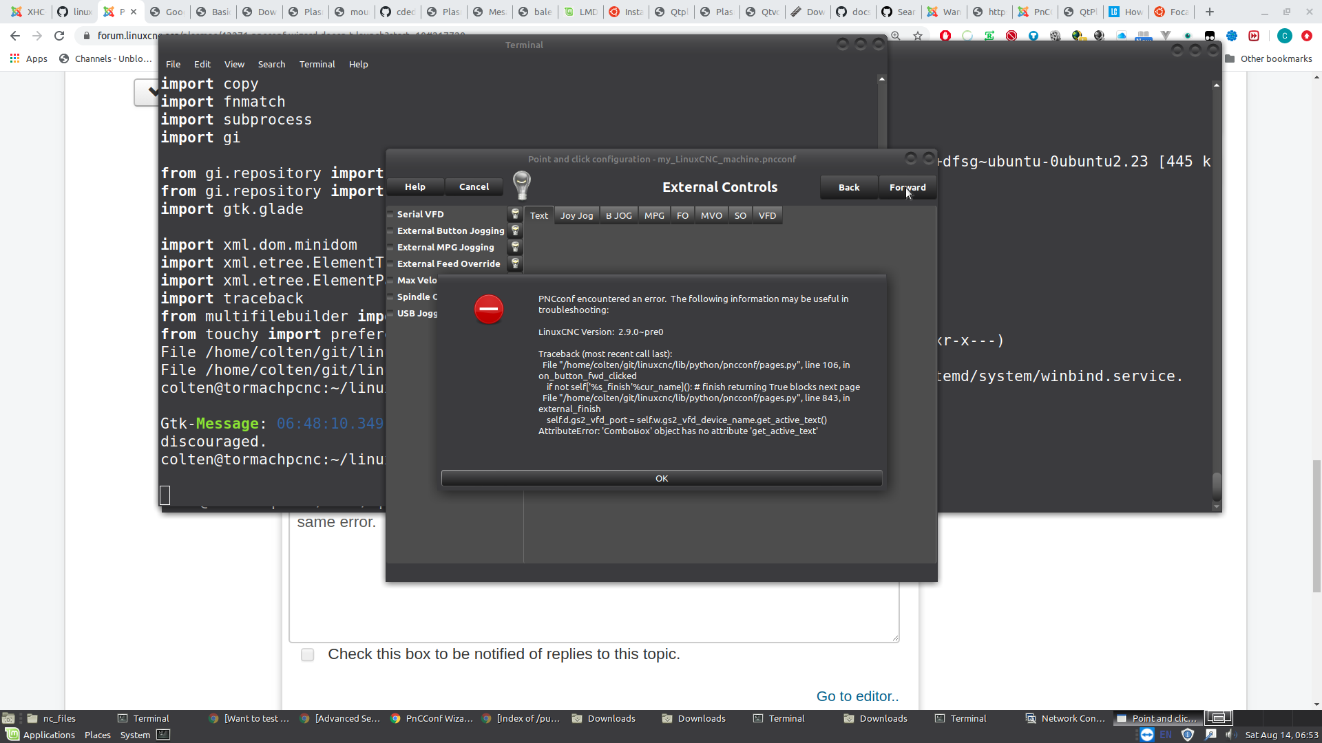

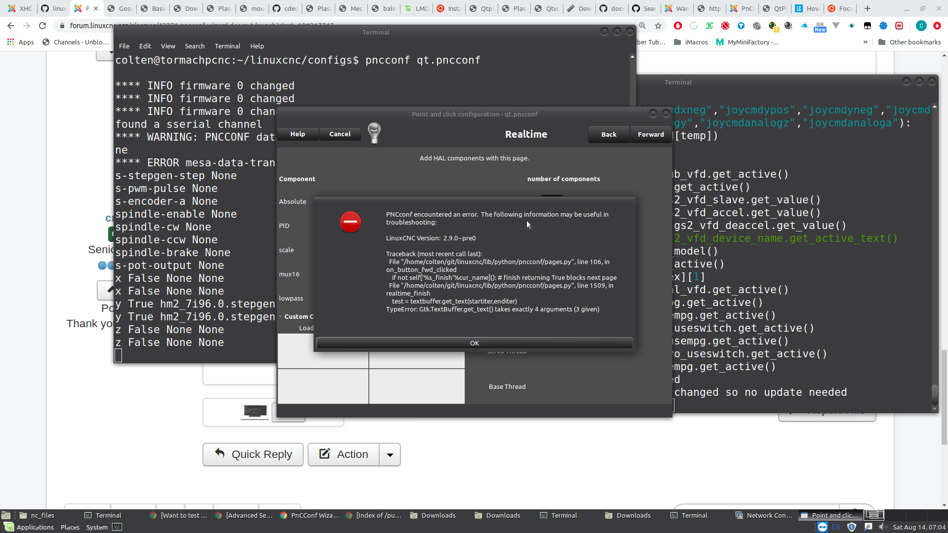

- crowloy
- Posts: 80
- Thank you received: 19
14 Aug 2021 12:57 #217747
by crowloy
Replied by crowloy on topic PnCConf Wizard doesn't launch
I just pulled the latest update so I can use pncconf again. I get to a certain point in the program and then it fails. once it does, I have to cancel as forward/back give the same error. And of course I need pncconf, since I have a new 7i96 board I want to install in my CNC router box.
- phillc54
- Posts: 5711
- Thank you received: 2100
14 Aug 2021 13:09 #217749
by phillc54
Replied by phillc54 on topic PnCConf Wizard doesn't launch
Are you using a VFD?
If so I think I know what is wrong, I should be able to fix it tomorrow.

14 Aug 2021 13:20 #217750
by crowloy
One last error. I'm also not using a vfd. Just trying to get past that screen

15 Aug 2021 15:58 #217821
by crowloy
I was able to completely finish a run of pncconf and create a config. Thanks
