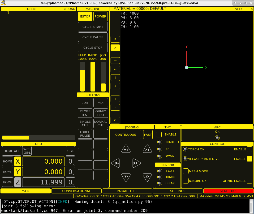

I have a basic machine config working on AXIS interface. Machine home itself ok. It's a gantry type (XYYZ).
Then I have the same config (.hal and .ini files) running on QTPlasmaC.
I can home X and Y with success on QTPlasmaC.
For some reason, When I try to home Z on QTPlasmaC I get errors like :
[QTvcp.QTVCP.QT_ACTION][INFO] Homing Joint: 3 (qt_action.py:96)
joint 3 following error
emc/task/taskintf.cc 947: Error on joint 3, command number 125
I tried to check configs between AXIS and QTPlasmaC, but could not find differences.

In your QTPlasmaC .ini file
[AXIS_Z]
MAX_VELOCITY = 25
MAX_ACCELERATION = 40
should be
[AXIS_Z]
MAX_VELOCITY = 50
MAX_ACCELERATION = 60
[AXIS_Z]
MAX_VELOCITY = 25
should be
[AXIS_Z]
MAX_VELOCITY = 50

Thanks, will try that.
But I completely ignore why that should be.
I'm not in front of the machine now, but I had been reducing max_vel and max_accel of Z trying to make it work without success.
So now I end up with something like this:
[AXIS_Z]
MAX_VELOCITY = 25
[JOINT_3]
MAX_VELOCITY = 25
MAX_ACCELERATION = 30
STEPGEN_MAXACCEL = 50
HOME_SEARCH_VEL = 22
HOME_LATCH_VEL = 5
HOME_FINAL_VEL = 30
I can think of HOME_FINAL_VEL been 30 might be the culprit.
But again, it works in AXIS, I don't know what would be different in QTPlasmaC

The steplen and stepspace in your .hal files are not the same for both setups. I am showing Joint 3 as an example, but each Joint has the same issue.
Axis, Joint 3:
QtPlasmaC, Joint 3:
I am not an expert with STEPGEN (here's the manual linuxcnc.org/docs/devel/html/man/man9/stepgen.9.html) but it looks to me like the periods for QtPlasmaC are much longer, and are perhaps the source of your issue.
That's what I see as being different though.
Axis, Joint 3:
setp stepgen.3.steplen 2750
setp stepgen.3.stepspace 0QtPlasmaC, Joint 3:
setp stepgen.3.steplen 5000
setp stepgen.3.stepspace 5000I am not an expert with STEPGEN (here's the manual linuxcnc.org/docs/devel/html/man/man9/stepgen.9.html) but it looks to me like the periods for QtPlasmaC are much longer, and are perhaps the source of your issue.
Last edit: 12 Aug 2021 16:39 by snowgoer540. Reason: accidentally had a old link to the 2.5 version of stepgen

Also the [AXIS_?] MAX_VEL & MAX_ACC need to be twice the corresponding [JOINT_?] value for all axes.

Thank you all, I will correct those configs (make then the same) and report back with tests on AXIS and QTPC.
I have set lower values for Z MAX_VEL & MAX_ACCEL and got the Z working again without errors.
@snowgoer540: I think AXIS config is using double-stepping, maybe it explains why higher velocities are been possible

I have correct that diff and followed those rules about VEL & ACCEL and everything is consistent now.
Thank you all!
