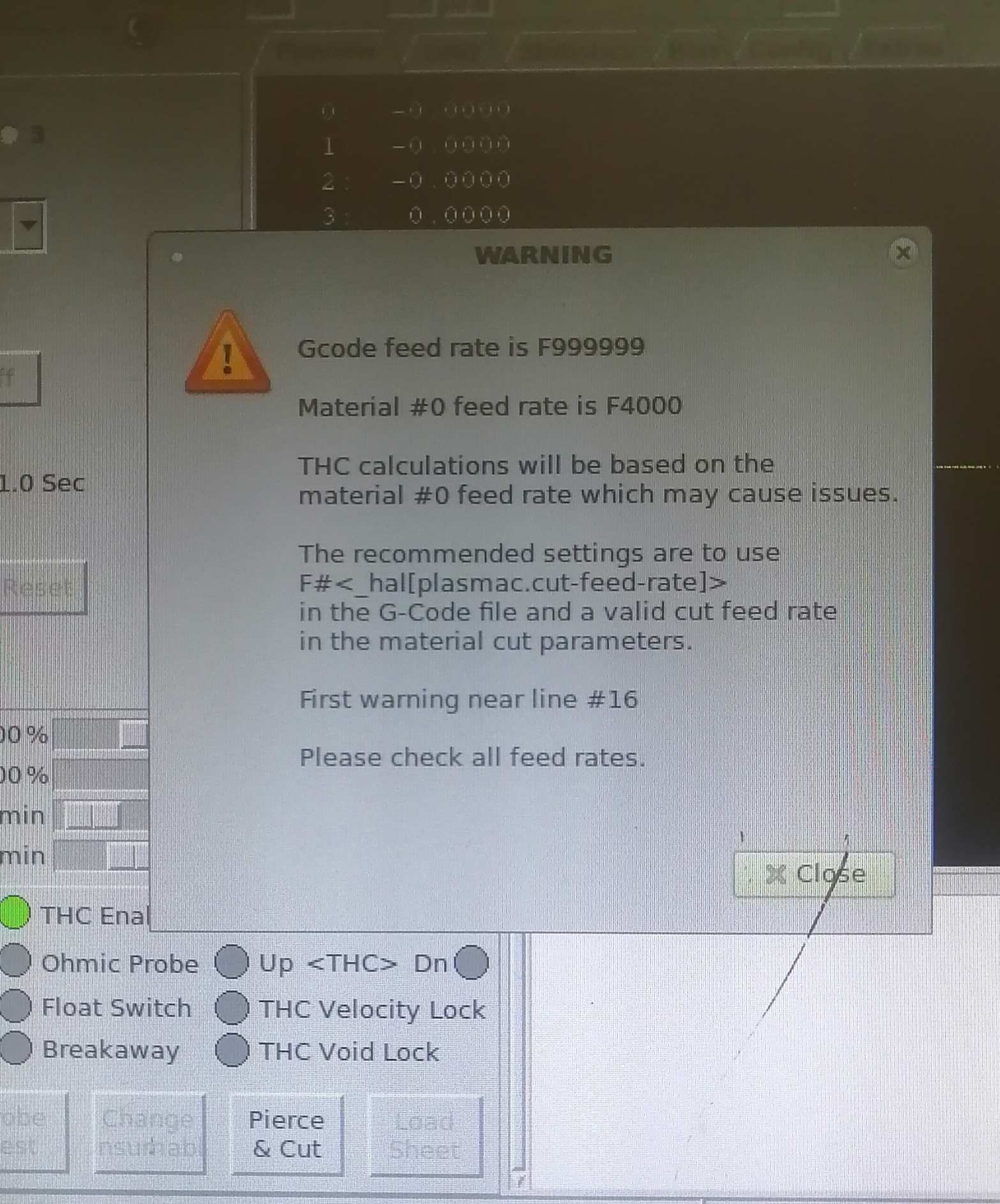

Greetings to all. I am using the Fusion 360 pp to generate the g code for Plasmac and when I open the file in the machine I get the following error, could someone help me?

Can you post the gcode?

This is my code G. .. And if I'm using the tutorial file in pdf.

N50 F999999.
That has to be edited to correspond with the feed rate set in PlasmaC, in your case you have it set at 4000.
Editing the post processor should be easy enough, so if possible add :
F#<_hal[plasmac.cut-feed-rate]>
instead of
F999999
That way PlasmaC will adjust the feed rate based on material being cut.

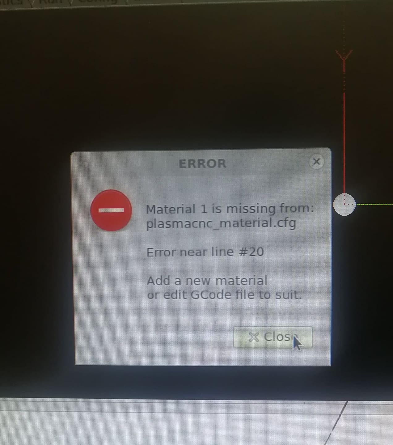

Ok thanks for your help, I corrected that error now I have this reference to the material attached an image, line # 20 is the following: N55 M190 P1.

This is selecting material number 1 (M190 P1) . It seems you do not have a material number 1 in your material file.
Replied by phillc54 on topic Fusión 360 and Plasmac
N55 M190 P1.
N60 M66 P3. L3 Q1.
