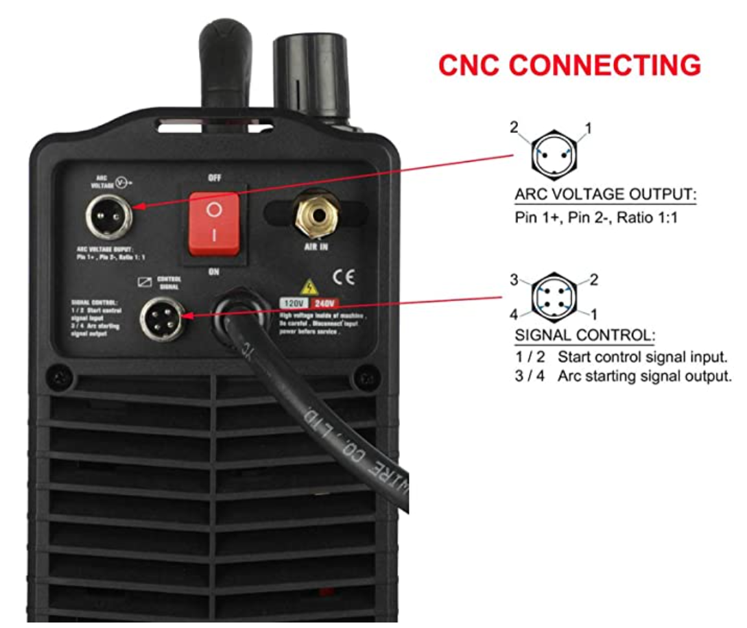

I need only the calculated resistors or those kindly mentioned by PCW, or I also need to place the 2 resistors of 1M in the inputs of + and - of the THC ?, supposedly the output of the plasma machine is ready to use and I should not expect explosions or smoke
in my th-cad

28 Aug 2021 05:05 #218978
by billykid
Replied by billykid on topic THCAD-10 and voltaje divider ratio.
As Rod said there should be some resistances on the arc voltage socket. you should measure with a ohmmeter between pin 1 and ground and between pin 2 and the torch electrode.

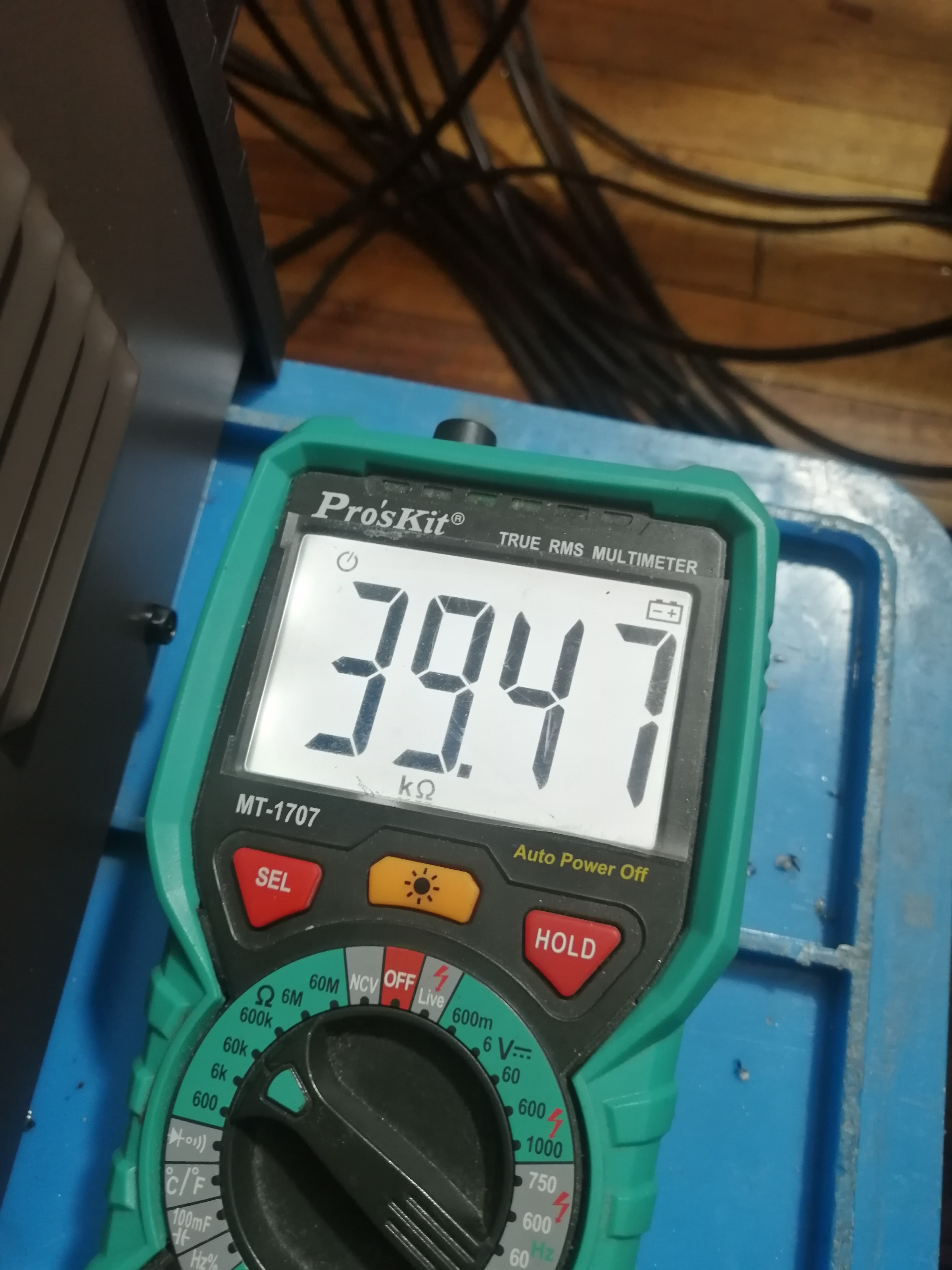

- paulsao
- Posts: 233
- Thank you received: 22
11 Sep 2021 17:30 - 11 Sep 2021 17:31 #220265
by paulsao
Replied by paulsao on topic THCAD-10 and voltaje divider ratio.
I finally have the plasma cutter in my hands, I made the respective measurements and I get a resistance of 40k between the cnc output pins and this is 40k.
Last edit: 11 Sep 2021 17:31 by paulsao.
- Posts: 12178
- Thank you received: 4155
12 Sep 2021 06:14 - 12 Sep 2021 06:17 #220289
Replied by rodw on topic THCAD-10 and voltaje divider ratio.
So assuming you have 40k resistance on both electrodes, you need to count the sum (80k) in the resistance you use for the thcad scaling.
