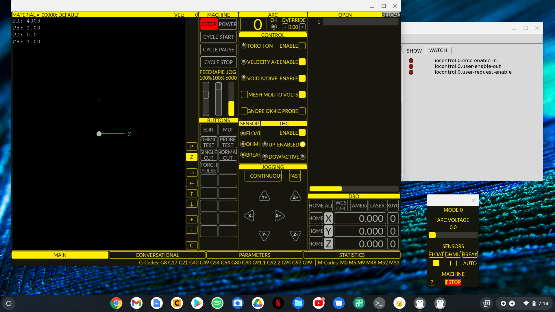

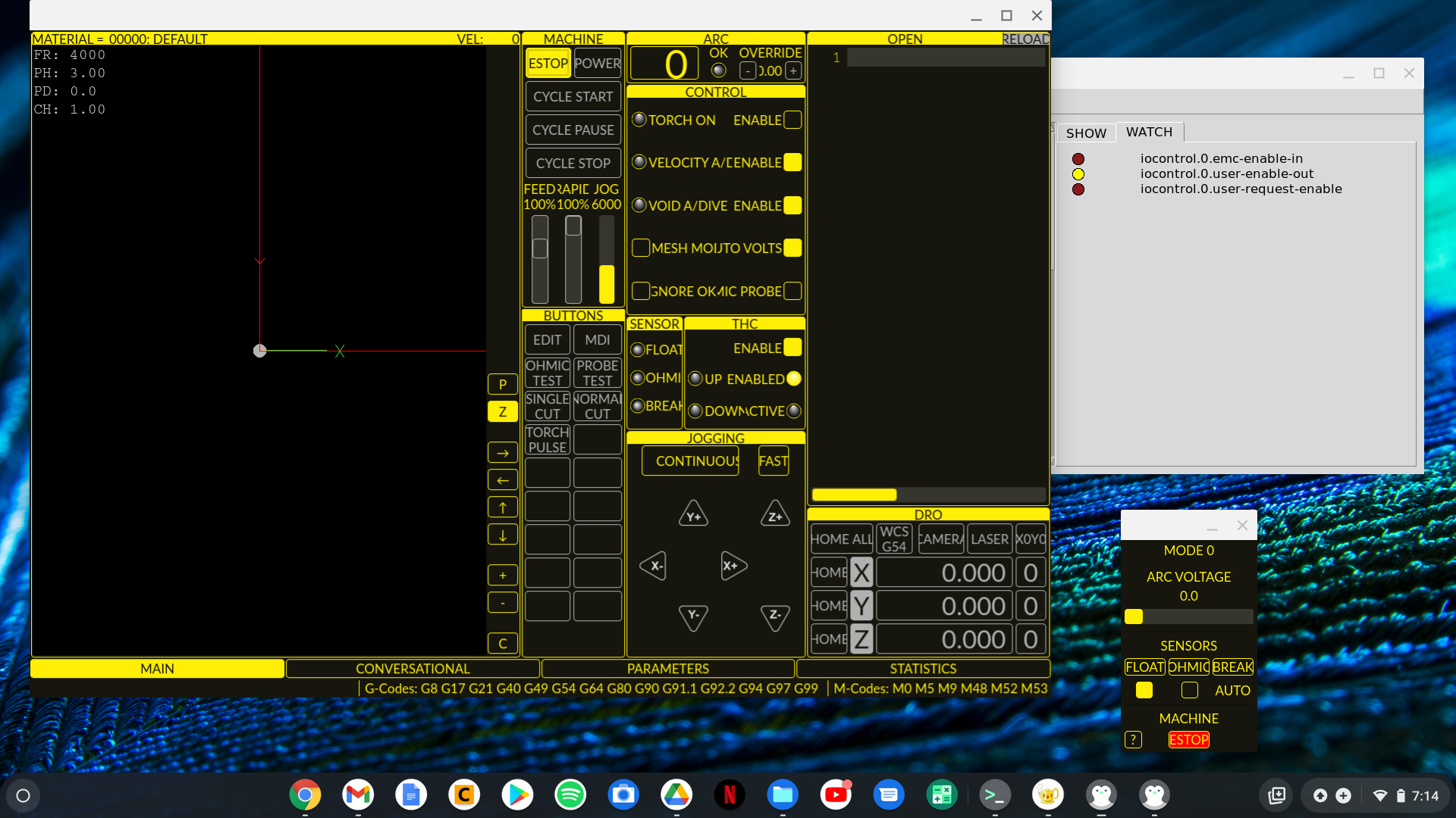

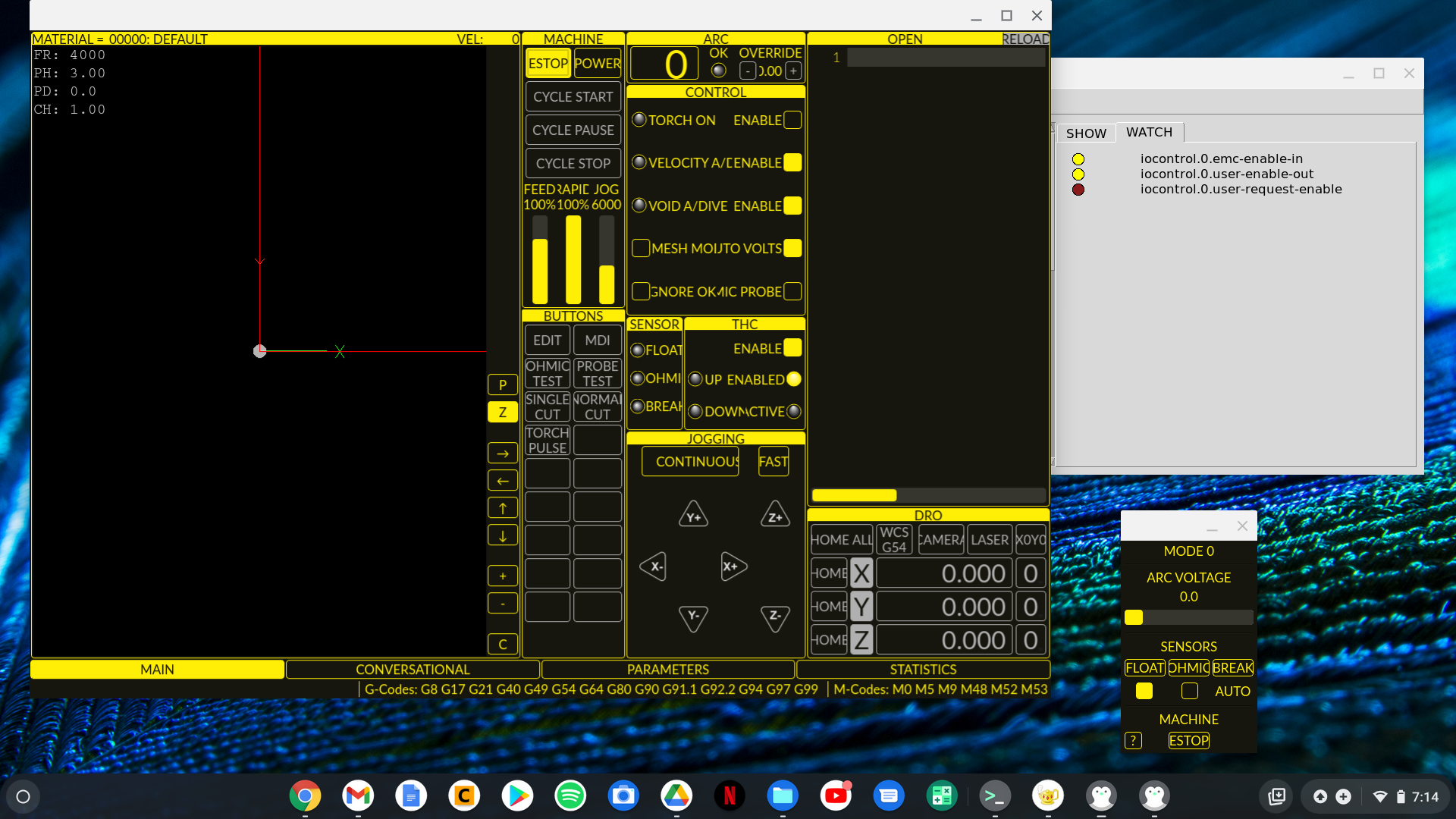

30 Oct 2021 21:25 #224731
Replied by rodw on topic QTplasmac, Estop Mode 2 and estop-latch - a safety issue
You can demonstrate the issue in the sim if you change the estop mode to be type 2 in the SIM ini file.
This shows the state on power up.
This shows the external estop is off but the screen button is enabled. This is the bug. The state of the estop button should be reset to red in this case.
This is with the machine on
So linuxcnc behaviour is correctly respected but the state of the GUI button is allowed to be inconsistent with the machine state.
It would be good if this was reviewed.
