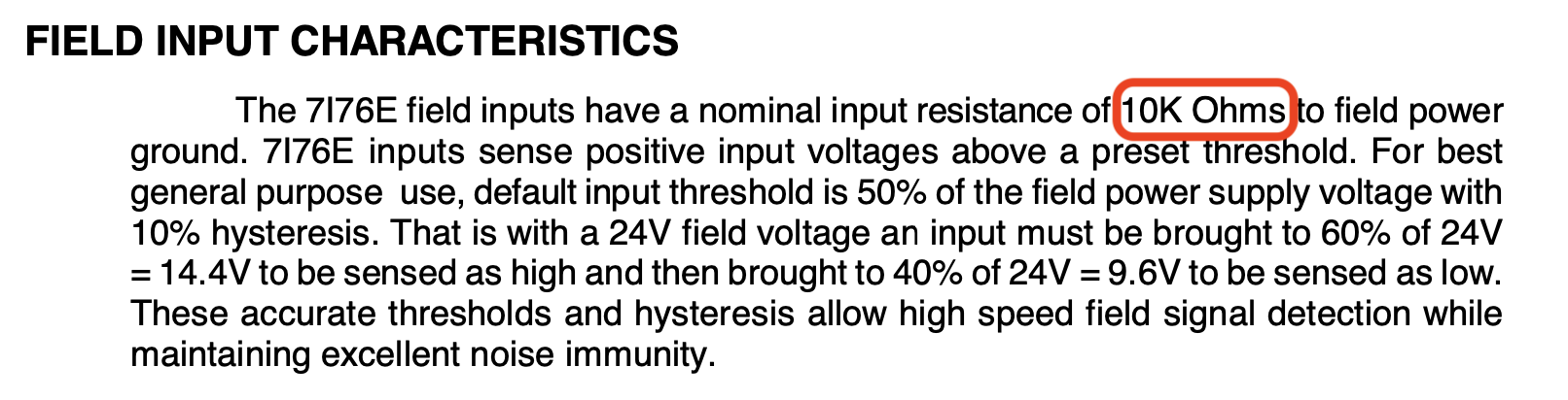

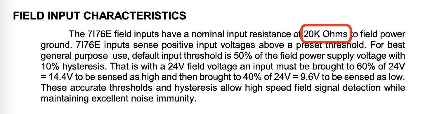

In the section contact load
linuxcnc.org/docs/devel/html/plasma/qtpl...html#qt-contact-load
It states:
If using a Mesa card, the input resistance could be 5000Ω (7i96) or 10000Ω (7i76E), giving a contact current of 4.8mA or 2.4mA assuming a supply voltage of 24V (I = V/R).
But the 7i76e Manual states:
The 7I76E field inputs have a nominal input resistance of 20K Ohms to field power ground.
Where does 10000 ohm come from?
That should be 20000 ohms and 1.2 mA to me.

27 Mar 2022 16:39 #238487 by tommylight
Replied by tommylight on topic Documentaion Error?
Not the same thing, the first is reffering to an External resistance wired in series to the input on the Mesa board, the second refers to actual input resistance in relation to ground, meaning if you measure with a DVM set to Ohm between the input and ground it will show 20KOhm.
The latter also means that if you connect directly 24V the input will draw 1.2mA.
7i96 and 7i76E inputs and outputs are different types with different ways of connecting and use, so referring to them in one sentence should be avoided.
27 Mar 2022 18:39 #238497 by phillc54
Replied by phillc54 on topic Documentaion Error?
It seems that this has changed since I last downloaded a copy.
The following user(s) said Thank You: rodw, snowgoer540

27 Mar 2022 19:26 #238499 by rodw
Replied by rodw on topic Documentaion Error?
Only referring to the 7i76e. You have to look at resistance to ground on it as thats how the circuit is closed.
27 Mar 2022 19:31 #238500 by snowgoer540
Replied by snowgoer540 on topic Documentaion Error?
I had read somewhere that PCW is sourcing different chips due to availability issues.  It could be the reason for the change, or perhaps it was a typo and just got fixed.  The manual I have saved says 10k as well.
I’d be curious to hear from PCW which of the above scenarios is the reason for the change.

27 Mar 2022 19:34 #238501 by rodw
Yeh, I went back to my 2017 copy stored in Google Drive and it says 10k too.
I actually revised the maths above based on specs of another similar relay that said minimum current 5v 100 mA, 24 V 30 mA. I do remember PCW mentioning this. I think this makes sense as it would be tied to the contact material. Reworking on 30 mA, I came up with a 620 Ohm Resistor with power dissipation of a fraction under 1 W so a 3 or 5W resistor should be used. This resulted in a current of  39 mA.
