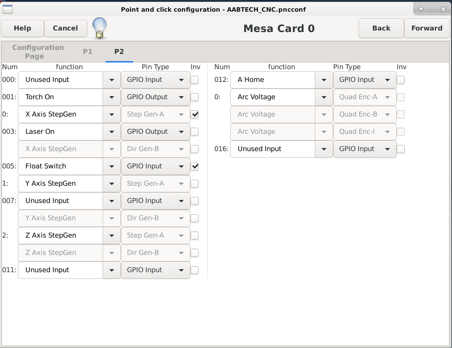

1.Hi, I got my self a new 7i92 board and is not working properly I have changed the IP address to 10.10.10.10 but if I ping 10.10.10.10 it working correctly.
my IP address for the setup was 10.10.10.11 gateway 10.10.10.1 and my netmask 8. If I try to do
mesaflash --device 7i92 --readhmid and
mesaflash --device 7i92 --addr 10.10.10.10 --readhmidIs saying no 7i92 board found, but I have set My pncconfwizard and X , Y and Z are
moving correct but input and output pins not working.

Also, all pins not used for stepgen/pwm will be set as inputs, to use them as outputs they must be set as such in hal, or in PncConf.

30 Apr 2022 09:52 - 30 Apr 2022 10:57 #241716
by aabtech
Replied by aabtech on topic Mesa 7i92 board problem
Last edit: 30 Apr 2022 10:57 by aabtech.

Replied by PCW on topic Mesa 7i92 board problem
Are you sure you have the BOB pin mapping correct?
for the "5 axis Mach BOB" , the mapping is

How to use Input-P10 13 IOPort None
because it is not showing in PNCconfig?

Those would be GPIO 13,14,15,16
in the hal file:
hm2_7i92.0.013.in
hm2_7i92.0.014.in
hm2_7i92.0.015.in
hm2_7i92.0.016.in
