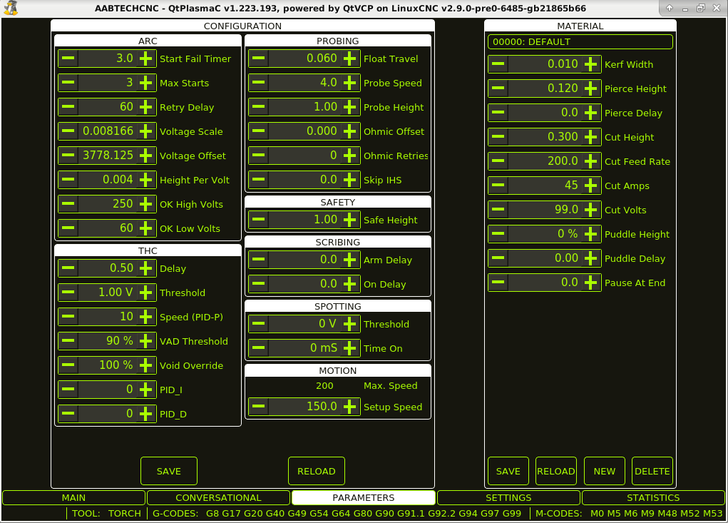

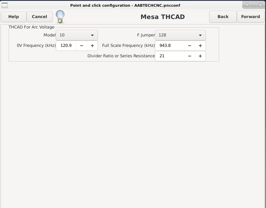

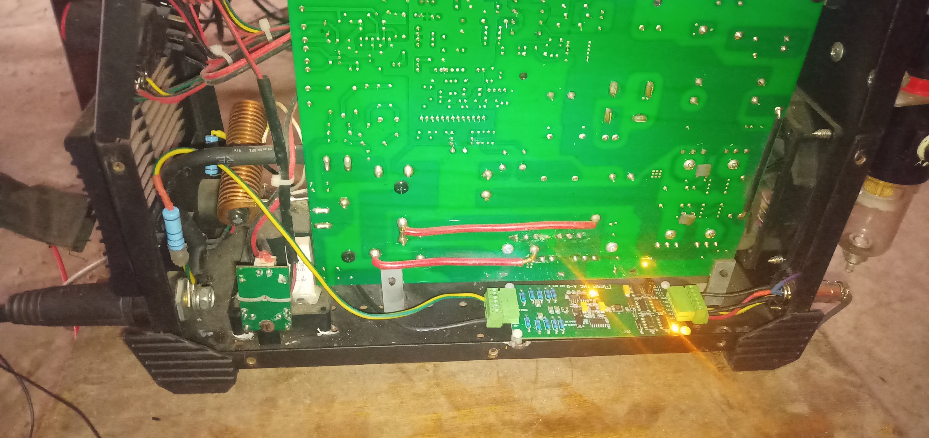

Hi, I am having mesa 7i92 with Chinese BOB my arc voltage pin is connected to pin 11 on BOB which is Encoder A . I am using raw arc voltage from my plasma which is 230v DC and I have used 1m ohm's resister for each leg which gives me 21:1 divider ratio but if I am cutting the THC can't sensor the arc voltage.

You probably need to change the THCAD jumper to 128 and the scale and offset parameters to suit.

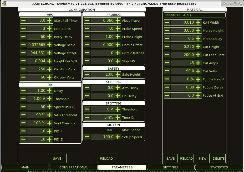

i change the jumper to 128 and random torch raises or dives during stable cutting was not working.
