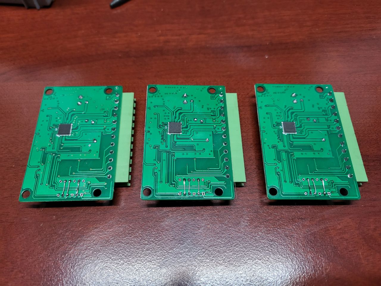

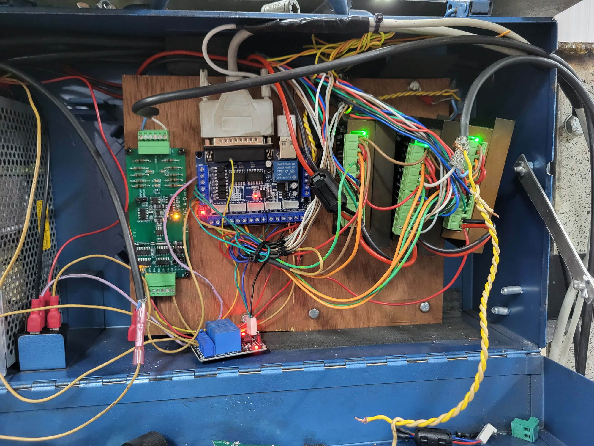

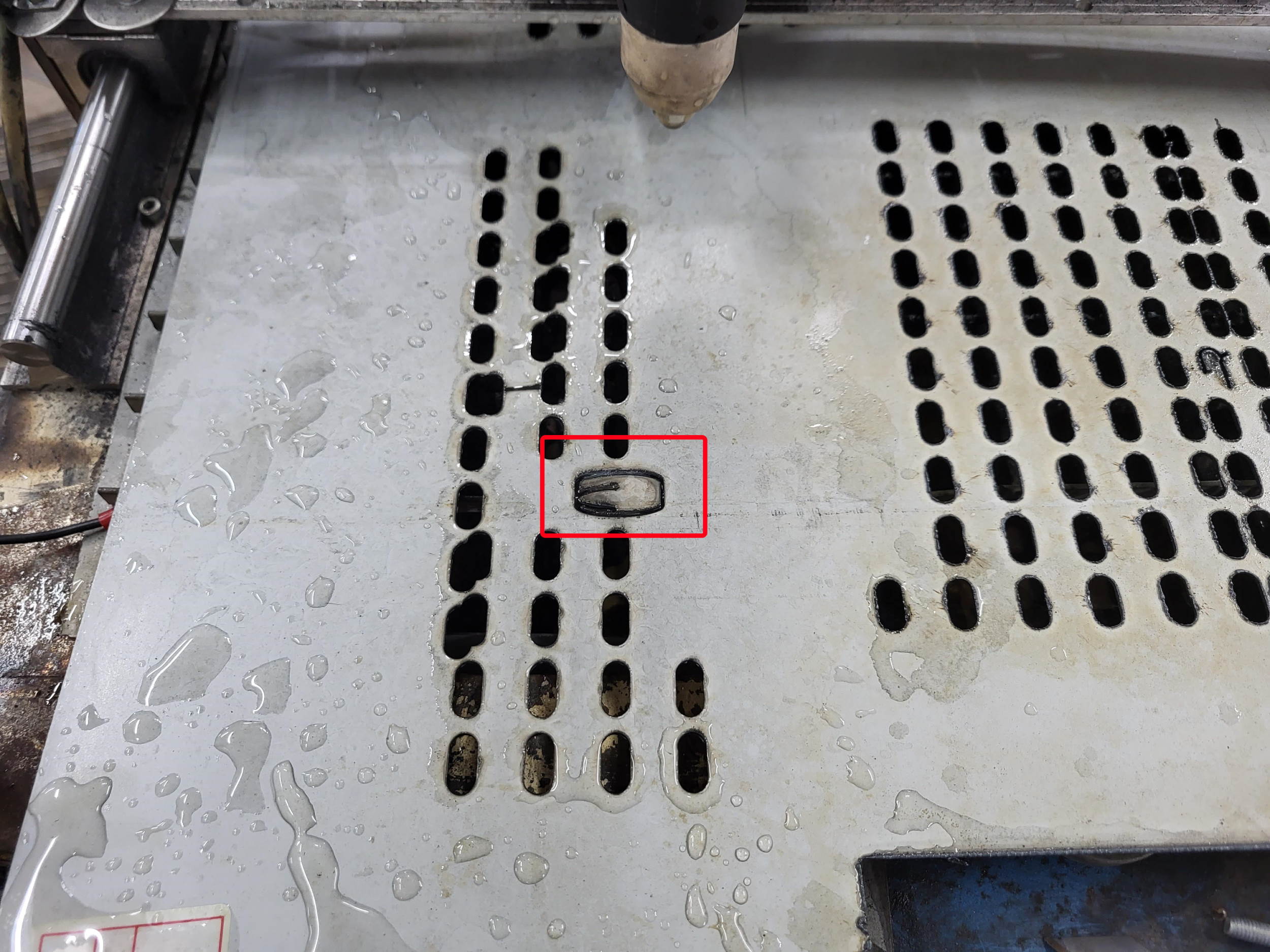

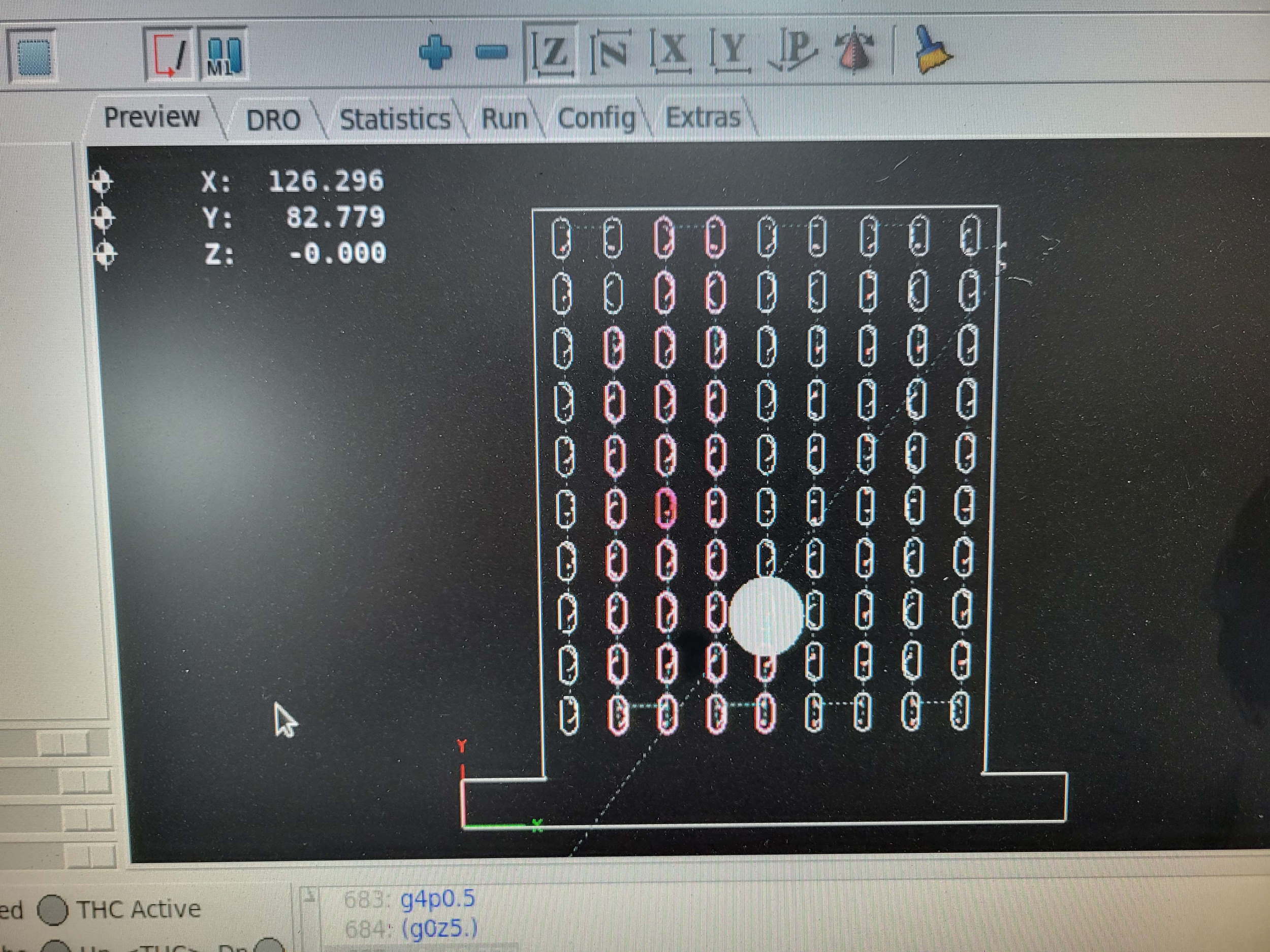

Hello! first time poster since I Really need some help this time around I've build my own cnc plasma cutter with PlasmaC. When it works, it works like a charm.The problem I have is that once in a random while the X or the Y axis goes super fast while the plotter on screen shows it followed the normal rout (see pictures)
I've changed motor driver, cables, pretty much every setting in the HAL and INI (apart from the right one probably) I even changed out the whole computer! nothing seems to make a difference. I really hope someone on this forum can help me out!!
(The motor drivers are hanging loose in the picture and have a debug wire going to a oscilloscoop since I have been testing stuff)

Hmmm this is all a guess:
Those are "TB6600" drives that do not use TB6600 but sommething with TB nnS109, a much better Toshiba chip, chinese ones, is that correct?
Also you have them set at 1/32 microstepping, or maybe 1/16 ?
Set the drives to 1/4 microstepping, change the scale in the ini file, do some test cuts, the issue should be gone.
If that is the case, there is no easy solution, the DIP switches on some of those drives are very bad quality and will ocasionaly touch inside switching from 1/32 to 1/4 microstepping.
I have 24 of those, 16 work perfectly, while 1 of the latest batch had this issue, took me a week to figure it out as the machine was some 12KM far.
I did open the offending one and all that came in that shipment and cut the traces going to DIP switches, then added wiring for the ground plane as it has to be cut. Now they are pegged at 1/32.

Thanks for your reply and insight!i already had a hunch it could be the switched but didn't find anyone else mention it.I've opened them up and now hard wired them. Also a great time to add some new thermo goop! And these are indeed the S109 chips.I will test them out tomorrow and give you a update!Thanks for sofar! Greetings, Kenneth
