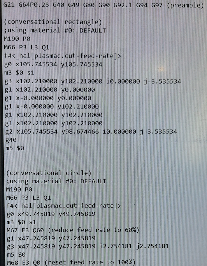

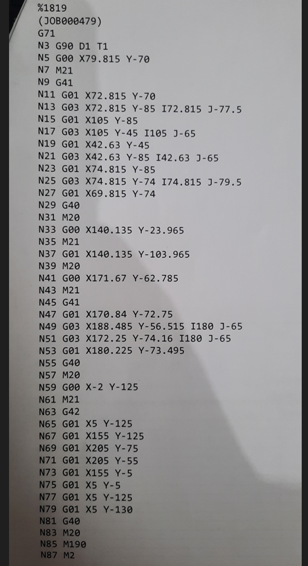

My current question is, how can i ensure that when filtering the gcode generated by Lantek, the Kerf width compensation is automatically made like it occurs in QTplasmac Conversational. In image 1, we have the code generated by Conversational for cutting an identical geometry as shown in image 2, wich represents the code generated by Lantek. Te objective is for this filter to adjust the Kerf width compensation, just as it happens in Conversational. Im using the custom_filter.py.

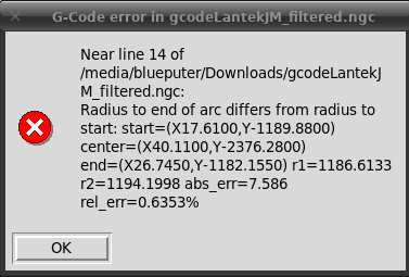

The problem is the G03 moves. Lantek exports this arcs with some error in the arcs and i get: radius to end of arc differs from radius to start linuxcnc
What could be the problem?
Here is a sample of ALMOST zero problems: (The error i get is always the same)
Is there any way to merge the arcs or add a line before/after that will enable me to remove this difference?

The ARC_BLEND parameters that you are changing have nothin to do with G2/G3 arcs, they ar for look ahead trajectory planning.
There is a CENTER_ARC_RADIUS_TOLERANCE_MM here:
linuxcnc.org/docs/devel/html/config/ini-...sub:ini:sec:rs274ngc
I tried adjust this earlier with some gcode that you posted but it did not resolve the error.
forum.linuxcnc.org/plasmac/49697-compati...-end-software#276995

just tried it. changed to 10 no luck

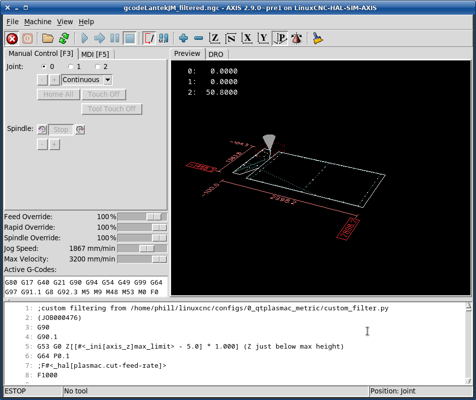

I converted the file from your earlier post so it would run on an AXIS sim and the same errors happen.
I also ran this file on an online gcode simulator ncviewer.com/ and it ran fine.
I think that I am unable to help any further. It may be worthwhile posting on the G&M Codes section of the forum.

Does by chance Lantec uses absolute coordinates and not relative on arcs?
