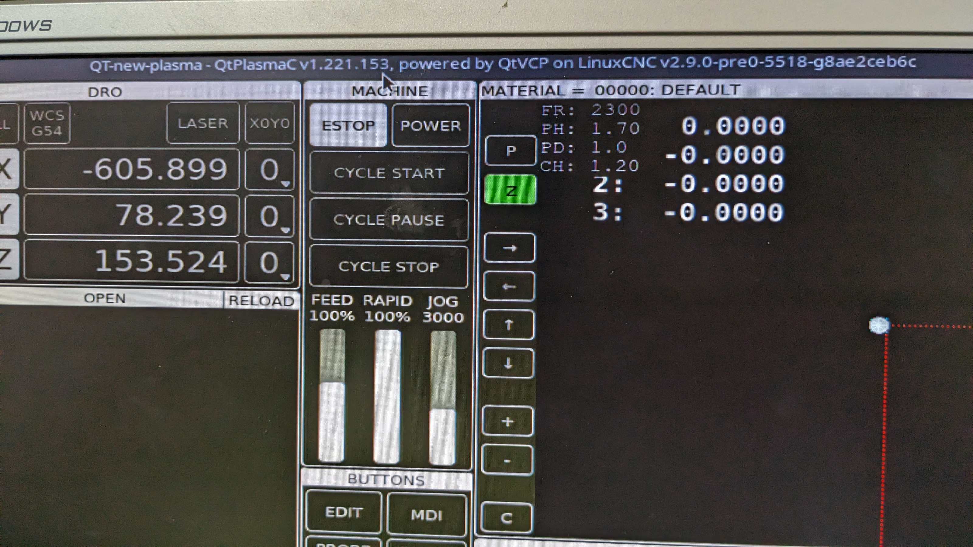

I was wondering how difficult it would be to bring my version of QTplasmaC to the latest version.
I am on version  QTplasmaC C221.153  linuxcnc V2.9.0 -pre 0-5518 – g8ae 2ceb6c

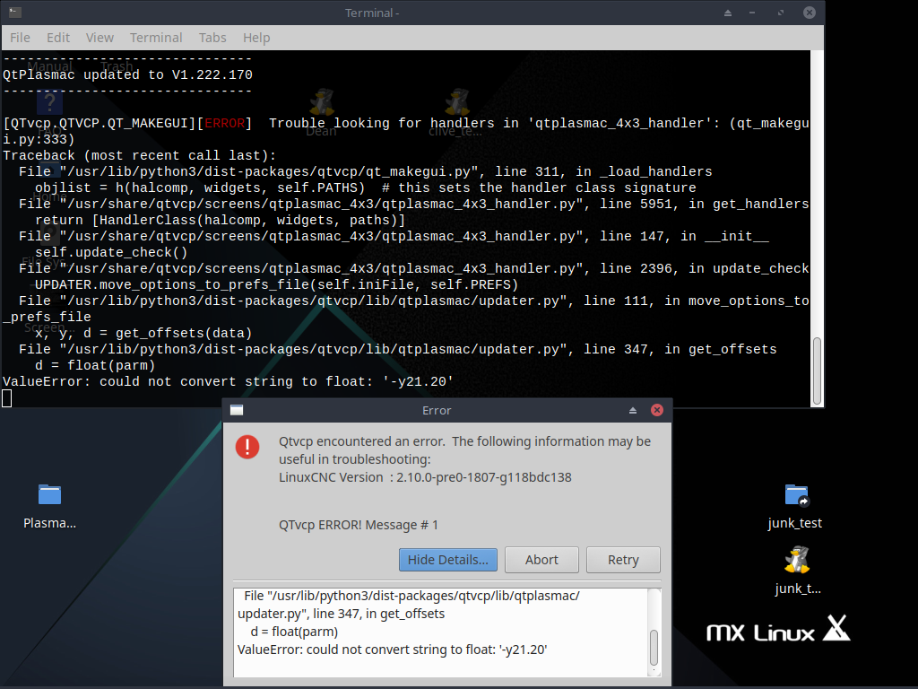

OK I had another drive with a slightly older version but the same version of linuxcnc so I swapped it out in case it failed which it did.

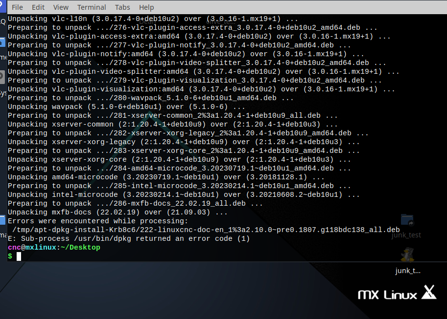

Do you have a copy of the original config that you could compress and post here?
Was the apt error before the QtPlasmaC startup error?
If so it may pay to remove the linuxcnc-doc-en package and try sudo apt update, sudo apt dist-upgrade again before trying to run QtPlasmaC.
13 Aug 2023 00:29 #277778 by phillc54
Replied by phillc54 on topic Updating to latest Version QTPlasmaC
It looks like you have either LASER_OFFSET, CAMERA_OFFSET, or OFFSET_PROBING with an odd Y value.
It shows as -y21.20, I think it should be y-21.20
13 Aug 2023 08:42 #277804 by Clive S
Replied by Clive S on topic Updating to latest Version QTPlasmaC
Yes you are correct well spotted this is from the older version drive that I had.

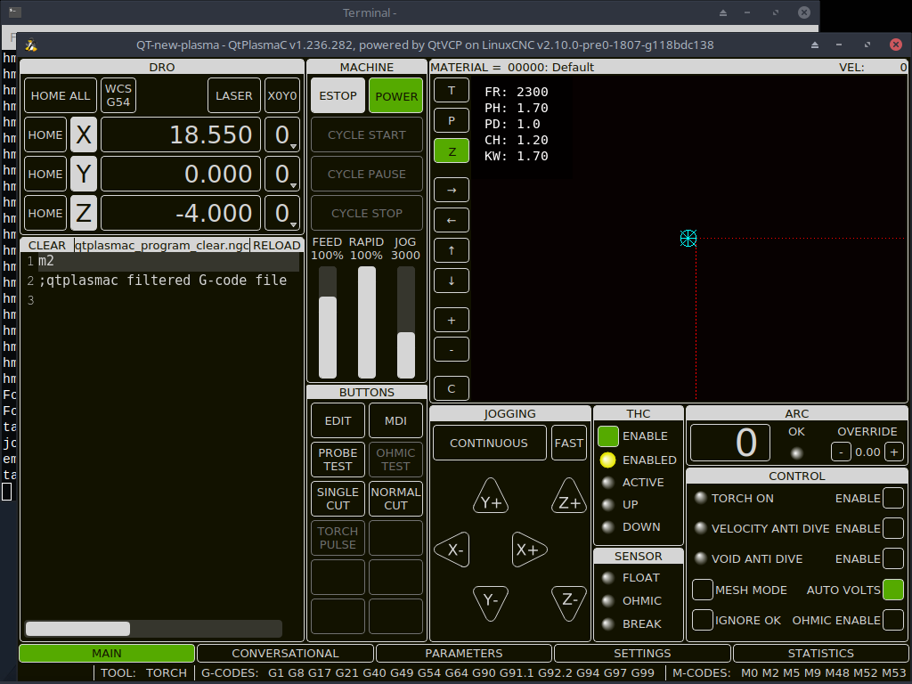

It has now booted and looks ok.   Is this the latest?
If so I will update with the drive I use. Thanks.
13 Aug 2023 09:13 #277806 by phillc54
Yes Clive, that is the latest.
We will add a check for errors like that one.
