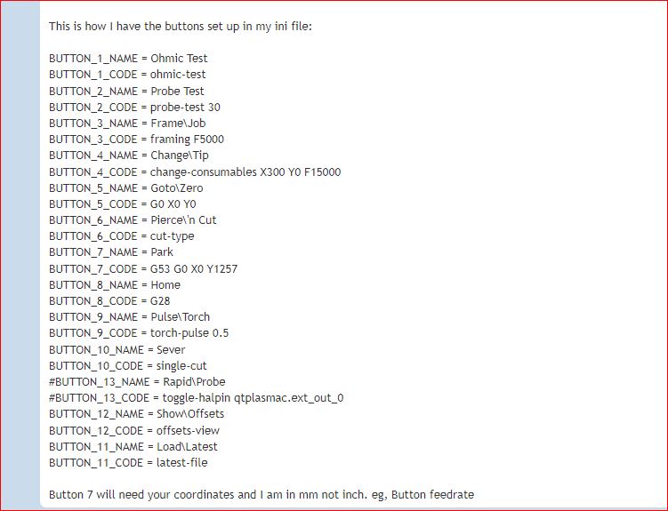

Hi
Is there are list of the custom buttons that can be used when setting up QTPlasmaC. The manual does not show a list.
I have had success in adding buttons on my table but some seem to fail due to wording, so I hope a list will show what which button can be added with the correct wording.
Thanks for your time.
Tom V

I have a list as it was shown on RodW video some worked other like button 8 got an error from hitting the limit switch. My way of looking at it is they are built in to QTPlasmaC and stored in the screen Pref file when added. I was hopping there was a list with correct structure to enter so they would work correctly.

If G28 hit a limit switch, then you have not got your limits set properly as they should never be hit. Adjust your home_offset to set home a bit further away from them. Perhaps your better performing motors just need some minor settings changes...
Its possible your max acceleration is a bit too high for the motor to obey so a bit of overrun on decelleration occurs
(G28 is X0,Y0 in machine coordinates)
The buttons can be whatever you like and are very flexible.

The valid commands should be listed here:
linuxcnc.org/docs/2.9/html/plasma/qtplas...:custom-user-buttons
Can you post the ones you are having issues with.

When I do the home all button it homes fine but using the button posted above (home G28) it moves to the home position and hits the limits and stops as there are no following actions to move it away from the switch as in the INI file.
Thanks for the list Phillc I will setup and use the ones I want. Still learning how the manuals are written, clicking on the list name moves to the explanations/structure.
I will look at the Max acceleration value, it seems to move correctly under the G1 command
I will get there soon with your help.(: (: (:

G28 is not really a move to home position command. On my table for moving to home position I have two user buttons...
X and Y axes:Z axis:
You could combine them on one button so Z moves to home first then X and Y move:You need to make sure the correct joints are selected to suit the axes, mine is XYYZ.
X and Y axes:
G53 G0 X{JOINT_0 HOME} Y{JOINT_1 HOME}G53 G0 Z{JOINT_3 HOME}You could combine them on one button so Z moves to home first then X and Y move:
G53 G0 Z{JOINT_3 HOME} \ G53 G0 X{JOINT_0 HOME} Y{JOINT_1 HOME}Please Log in or Create an account to join the conversation.

My home button has always worked as it should. Ok small change I remove the button for the G28. The Park button was changed to G1 X1 Y1 from the X0 Y0 so now it does not run into the limit switches. The Frame button works great, I'm happy, little slow but getting there.
