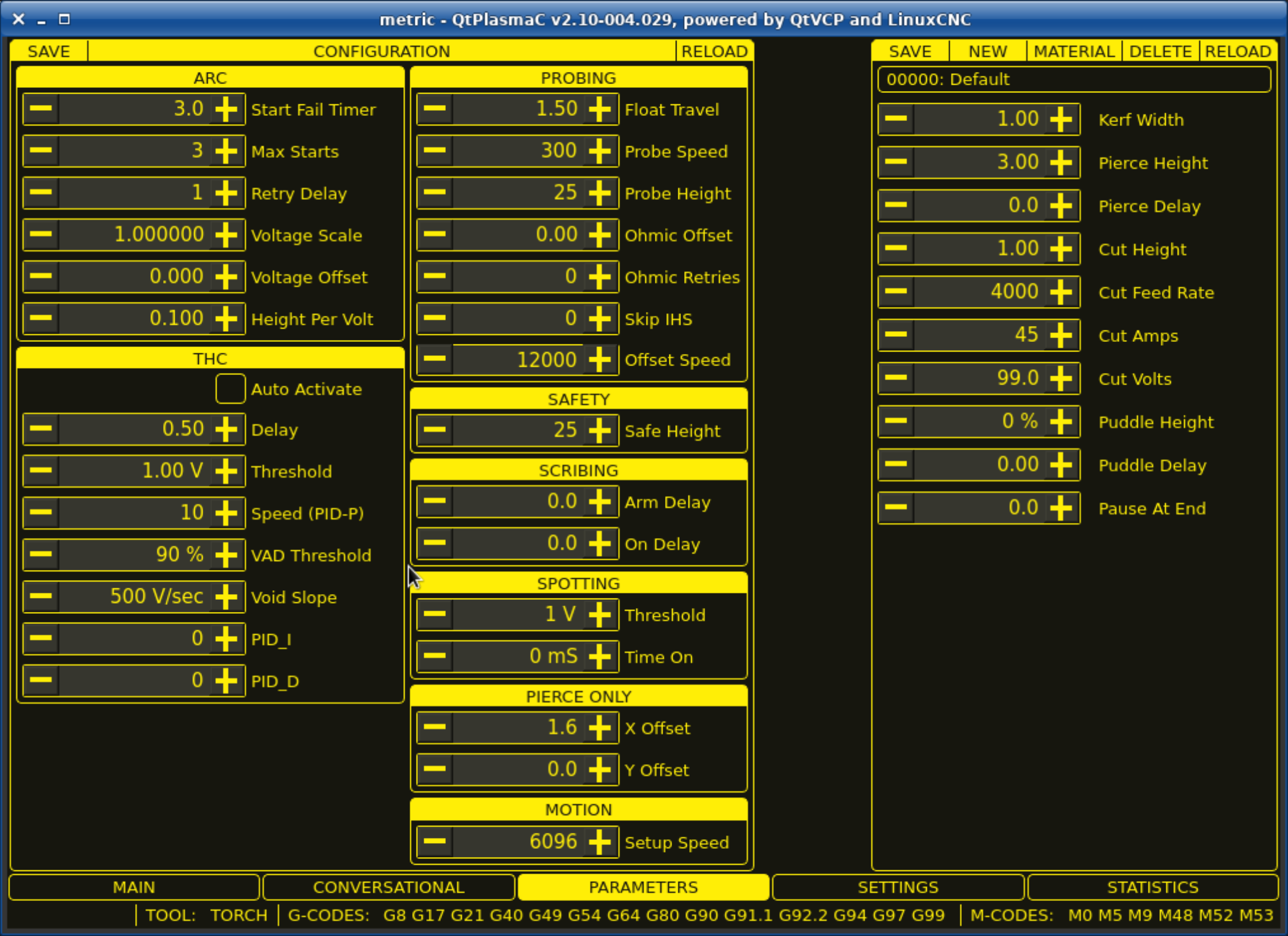

Replied by Deveraux on topic QtPlasmac Offset probing optimization
I updated a few days ago (currently on the latest masterbranch build).
But no matter what the offset speed option is not visible for me.
Im on 4:3 display layout and my probe Offsets are negative values (-30 x axis -20 y).
Any ideas whats wrong ?

- phillc54
- Posts: 5711
- Thank you received: 2100
29 Feb 2024 22:53 #294806
by phillc54
Replied by phillc54 on topic QtPlasmac Offset probing optimization
- Deveraux
- Posts: 38
- Thank you received: 8
01 Mar 2024 07:34 #294822
by Deveraux
Another question solved you sir are brillant. Thanks
