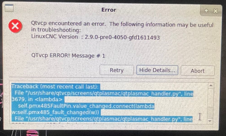

PMX485 Error was created by grijalvap

Oh my; 1.0.40 is from Jun 15, 2021. Tons has changed since then. Features added, bugs squished, etc. I use the serial comms with my powerMax pretty regularly. No issues. I suggest you update the works (might take a backup before you do, of course).
Replied by snowgoer540 on topic PMX485 Error
QTPlasmaC version is 1.0.40

I did Update and it is working with out problems now, this was the only machine not updated, i realized when posted.
