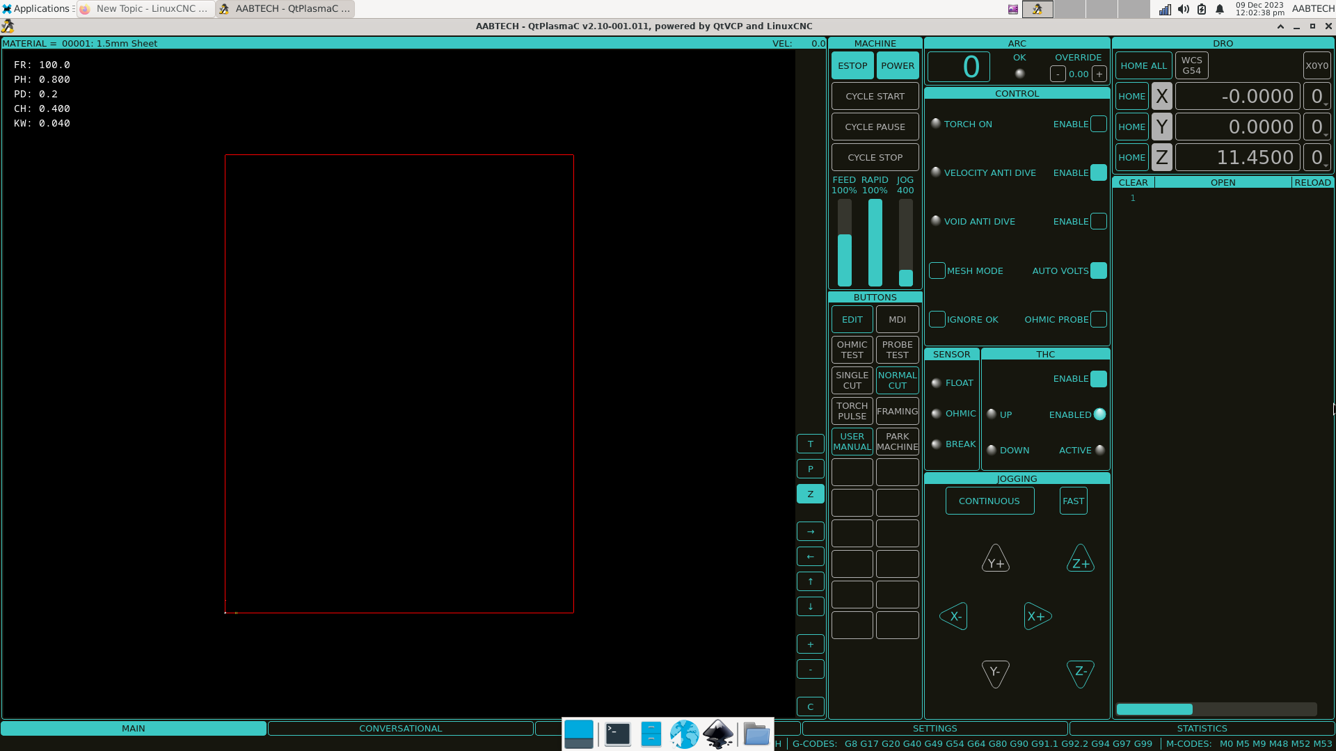

recently i change my Y AXIS wiring. at first i use to wire Y AXIS Motor 1&2 step & dir together to the board but now i tandem my Y Axis but my Y Axis do not move if i open QtPlasmaC my Y Axis look gray.
09 Dec 2023 12:16 #287649 by phillc54
Replied by phillc54 on topic Tandem StepGen
It will be grayed out until the machine is homed.

10 Dec 2023 09:56 #287747 by aabtech
Replied by aabtech on topic Tandem StepGen
Thanks very much. After homing all it worked.
