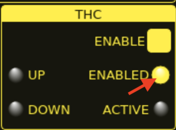

We have a system that the customer uses run from line regularly and he reports that the THC does not work at all. The Gcode includes the THC enable and it is enabled on the Gui but there is no reaction to the voltage changes.
The mode is set to 1.
This is the beginning of the file but they started it somewhere down the line.

Can you get a screenshot of the settings page and main page when using run from line?

I am not near the machine at the moment but I just tested on my machine and there is no problem with the THC enable. I will first have to see if that machine needs to be updated.
The main screen has:
Torch Enable = On
Velocity Anti Dive = On
Auto Volts = On
THC Enable = On
THC Enable Led = Off
Up/Down and Active Leds = Off
Torch Enable = On
Auto Volts = On
THC Enable = On

05 Feb 2024 03:35 #292481

Phill the THC Enabled Led never comes on. Let me get the installation up to the latest code today and check again.

Is that only when doing run from line or also on a full job.
Is it possible that the machines cutting velocity does not reach the cut speed set in the parameters.

I never thought about that. The machine is a bit slow but this was cutting at about 900mm/m. I think I saw 3000mm velocity during jogging on the machine.
The THC never comes on by the looks of it
