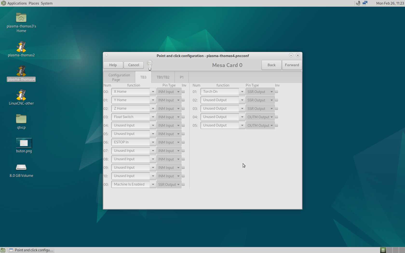

22 Feb 2024 11:21 - 22 Feb 2024 18:27 #293972 by Plasmanfm
Replied by Plasmanfm on topic E-Stop
Hallo phillc54
I set the E-Stop via the LinuxCNC Pncconf.Wizard
and in plasma-juergen.hal:
net estop-out => iocontrol.0.emc-enable-in
Attachments the qtplasmac_custom.py
my thank´s
and king regard
Juergen

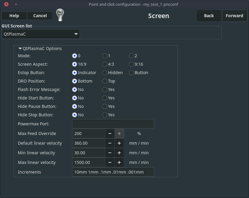

25 Feb 2024 09:45 #294350 by phillc54
Replied by phillc54 on topic E-Stop
Yes but I need to know what type of estop button.
Warning: Spoiler!

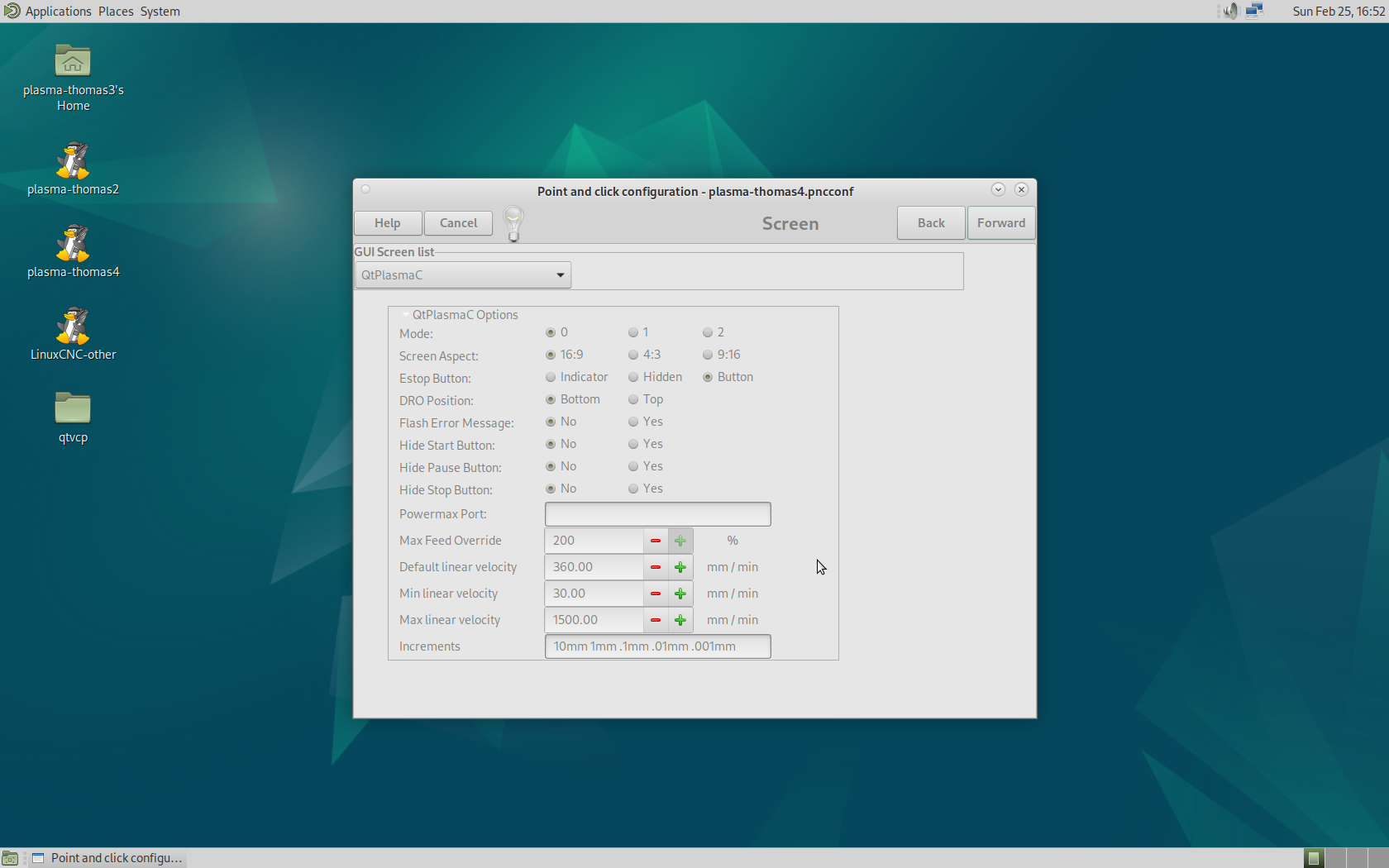

25 Feb 2024 16:21 - 25 Feb 2024 16:23 #294393 by Plasmanfm
Hallo phillc54
The button is set via the Linuxcnc Pncconf Wizardsee
see attachment
King regarde
and thank’s
Juergen
Last edit: 25 Feb 2024 16:23 by Plasmanfm.
26 Feb 2024 00:57 #294477 by phillc54
OK, so the GUI ESTOP is a button.

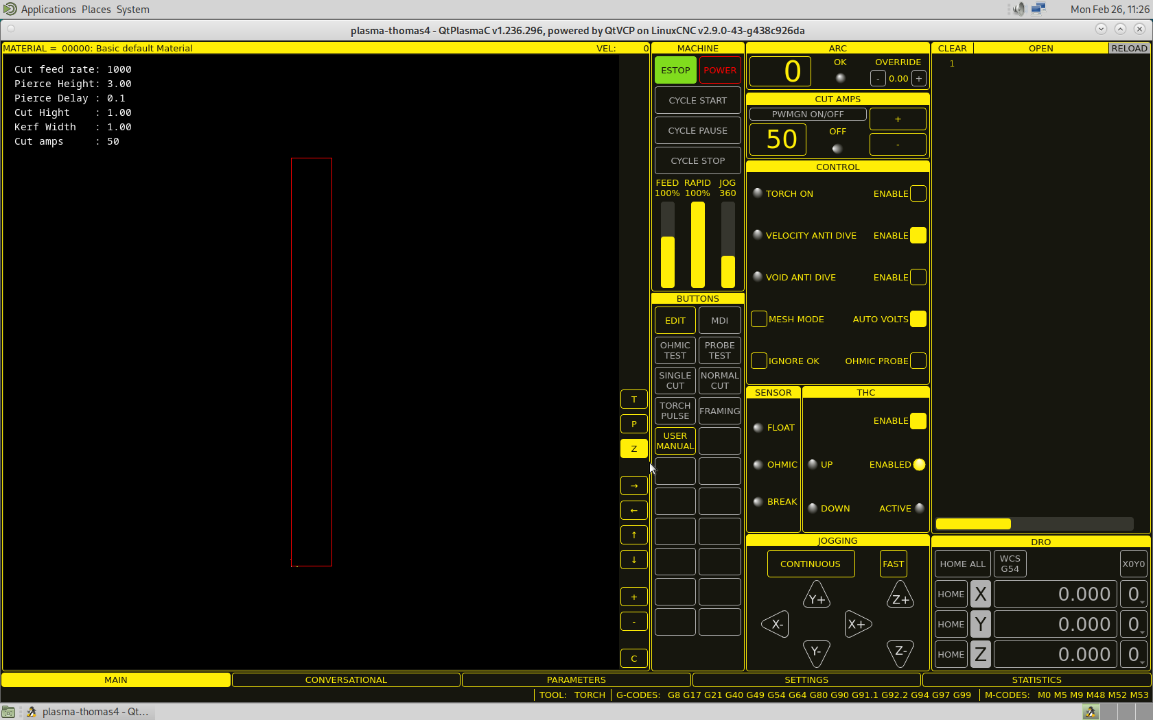

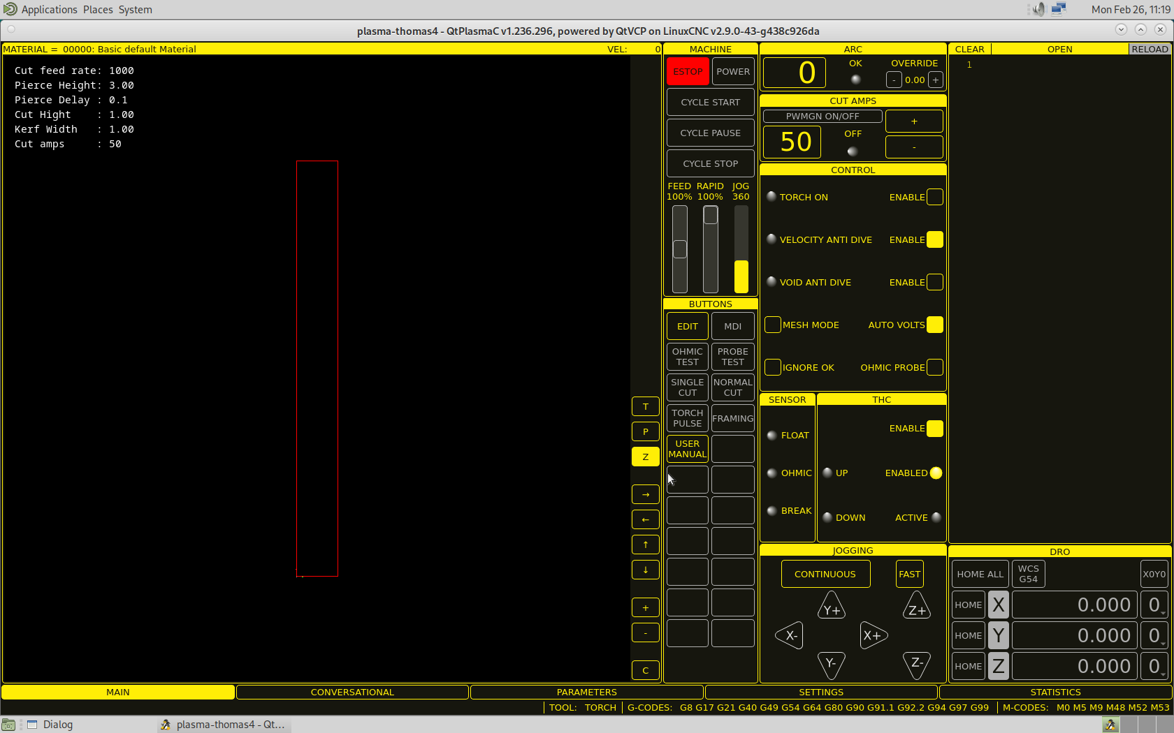

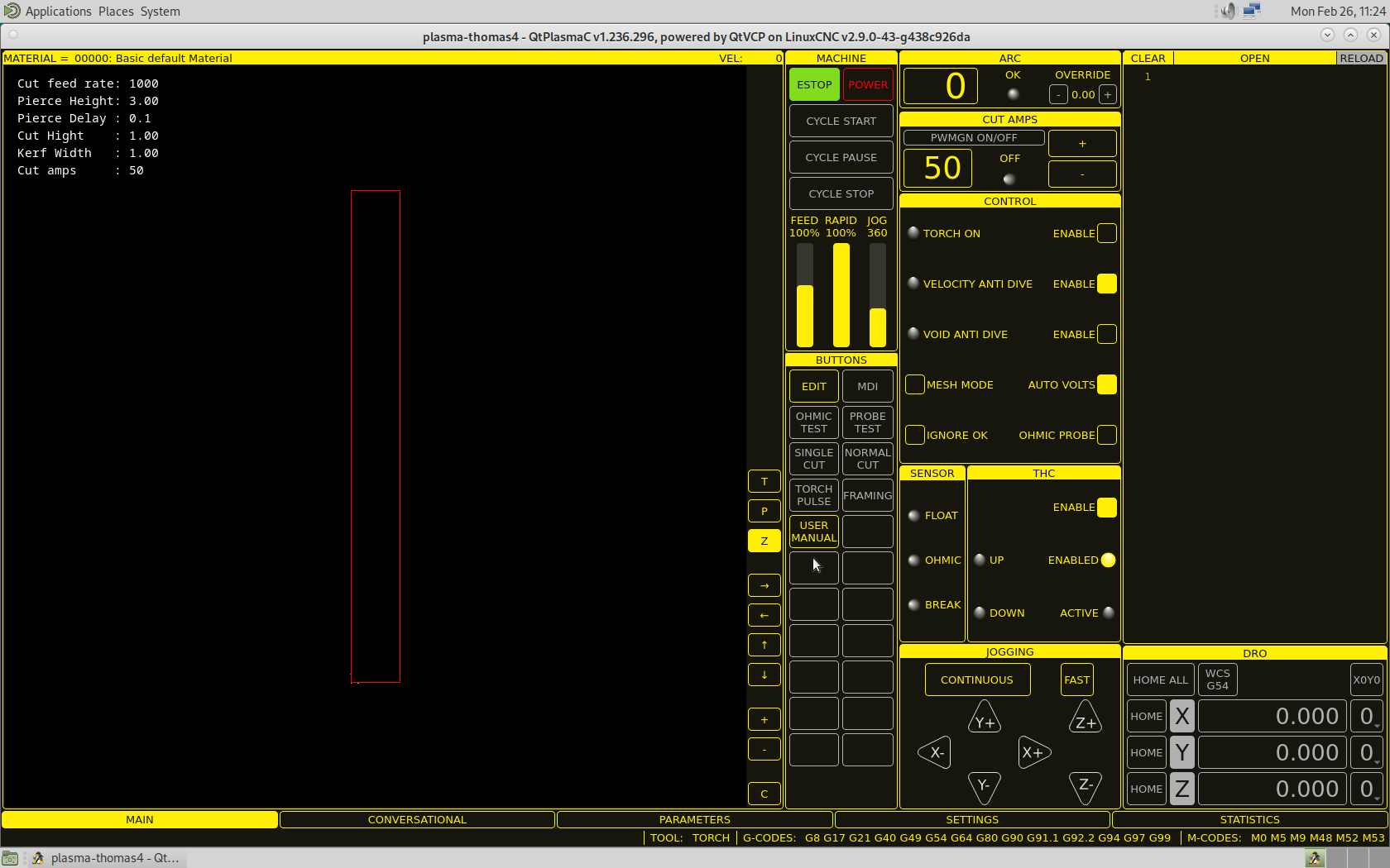

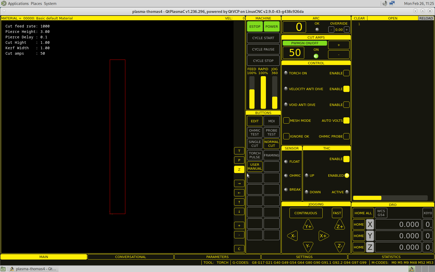

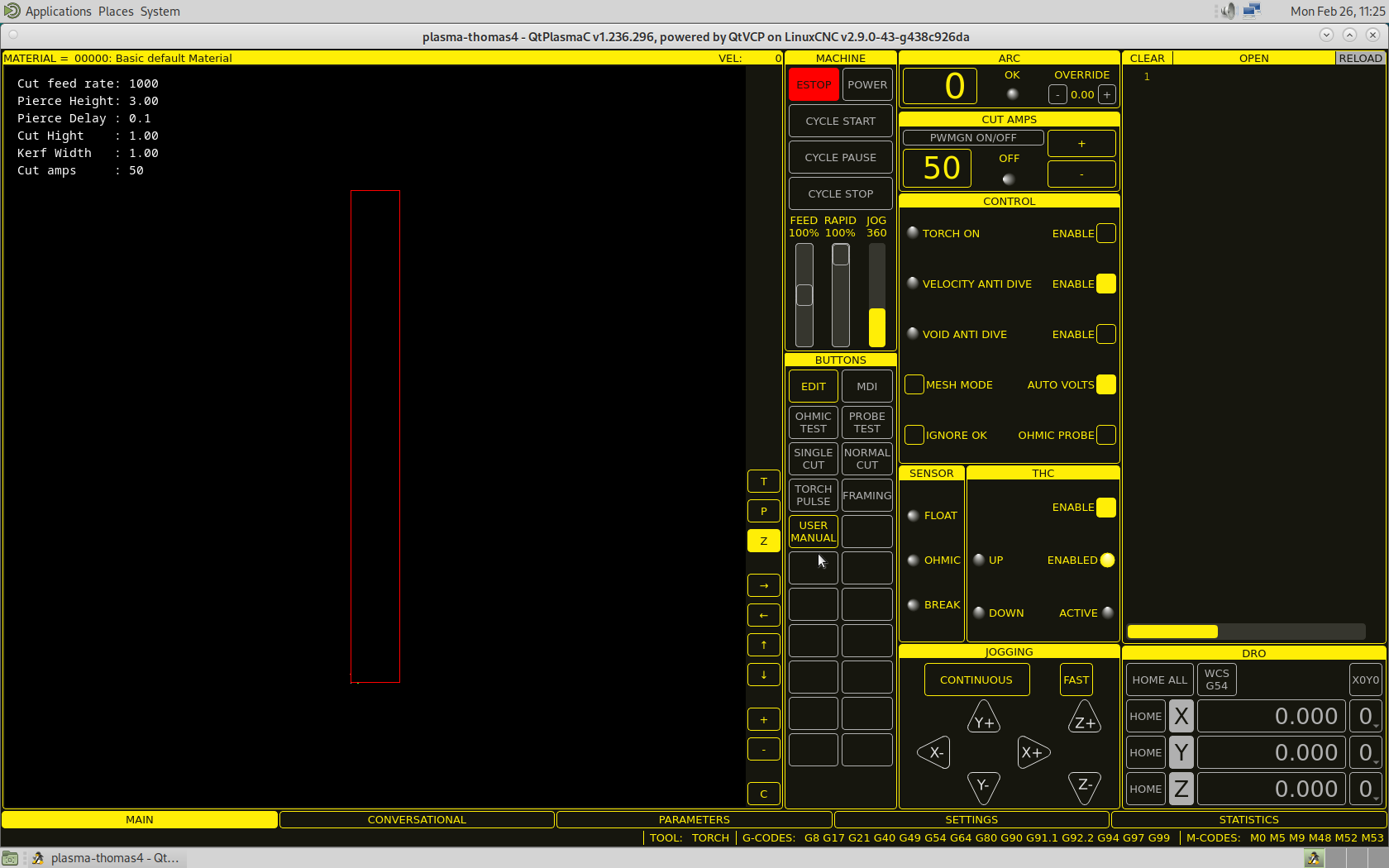

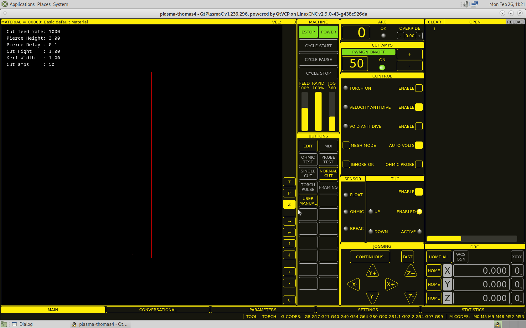

26 Feb 2024 10:05 - 26 Feb 2024 11:08 #294491 by Plasmanfm
Hallo phillc54The color is changed
Everything is as normalwith the difference of colorsPower on is greenPower off is red
Start Program Press the E-Stop Button goes green
you can switch the program in on by using the power button" E-Stop green Power Button green the Programm runing "
If you press the E-Stop E-Stop and Power Button goes red !
The logic is that something is on, it is green, something is off, it is red E-Stop presses red E-Stop reset green
step 1,2,3  Everything is correct without an external E-Stop.
With e-stop installed with e-stop 2,3,4
The internal e-stop is always green when the external e-stop is not pressed
that's not ok it should be red and after pressing it should turn green
If the external e-stop presses, it the internal e-stop red, that's ok
after reset is the internal e-stop green !
but I want be internal e-stop red and after pressing internal e-stop then only green !!
King regarde and
thank’s
Juergen
Last edit: 26 Feb 2024 11:08 by Plasmanfm.
