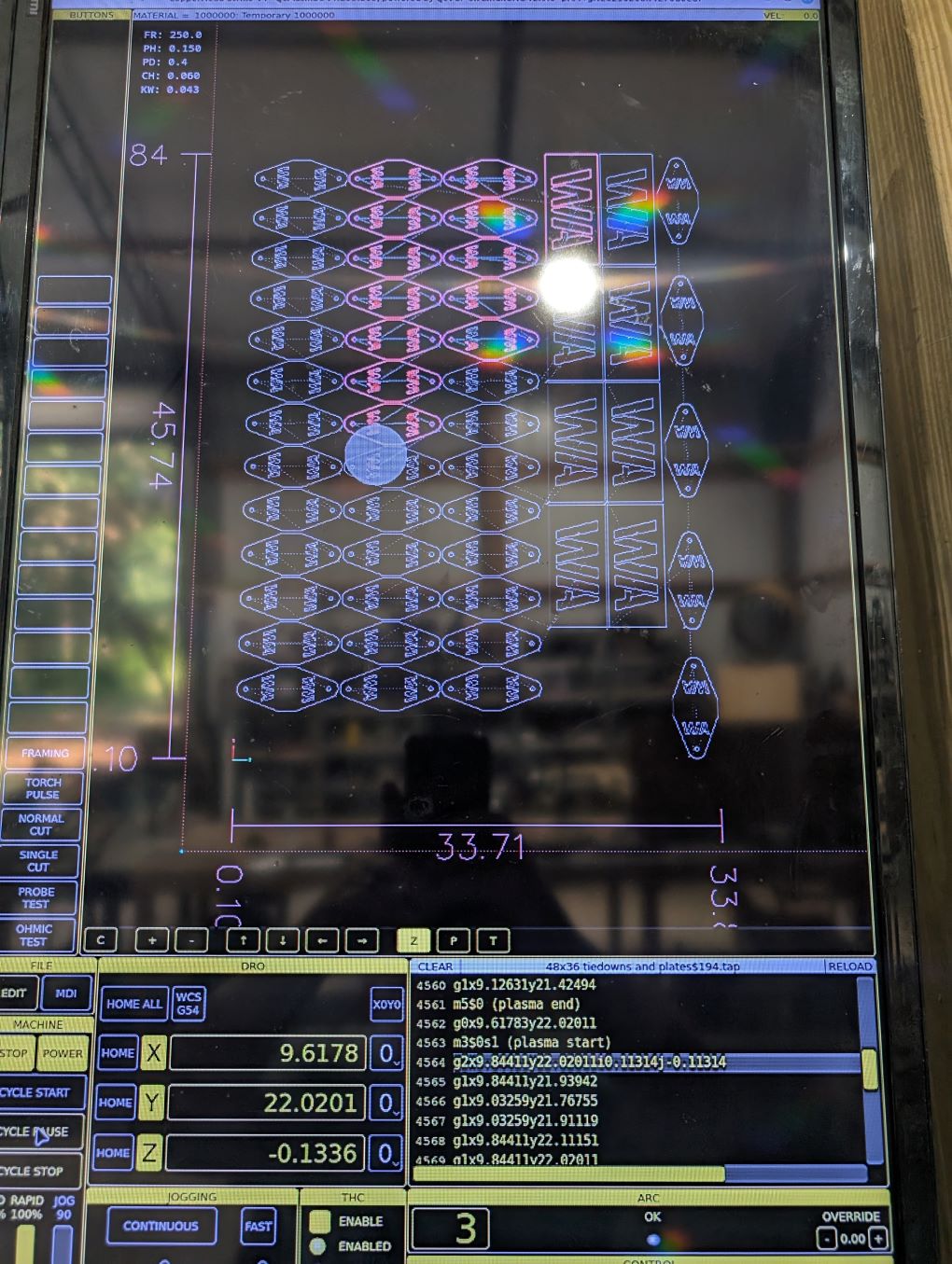

So, we ran our first production run using the 7i96s, THCad2 and QTPlasmac, and it was like jumping in a Cadillac after driving a pinto. Night and day between Mach4 and linuxcnc. Soo happy I invested in switching electronics over and making the switch.
Couple of issues I encountered and would like to get corrected.
I don't think i have my Z set correctly no issues in cutting or height control, When the machine is homed for the first program run, it runs up to the Z+ Prox / Z home from their it drops down to I'm guessing an offset I put in. it than drops down about 2 inches and zeros the Z drive. not a big deal but when I'm trying to line the torch up it won't go below 0.00 is it better to let the Z axis home off the probe or an upper limit.
On Probe it does this weird little double probe you can watch it come off the probe switch than go back to it than proceeds to cut height. is this normal or am I missing something in the settings?

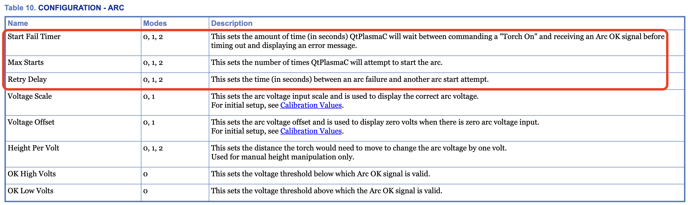

Randomly had no arc signal from the Hypertherm 65. this was closer to the end of the program about 45 minutes into cutting. I'm guessing it was a Hypertherm issue as I turned it off reseated the CPC port and it came back no issues but eventually did it again. I'm running Mode 1 in QTPlasmac which I believed was the setting when there is a separate ARC ok Signal?
During that no arc ok phase I also noticed that QTPlasmac will attempt three times to fire the torch after the third round of that it powers off with the screen switch and resets the program. Is this normal if it is, is there a way to change the number of rounds it will go through before resetting the whole program.
Yes it is and can be set in the config tab, so can time between retries. Do not forget to save after changing.
Not sure what you mean by resetting, the program should go into pause mode after the failed attempts.
linuxcnc.org/docs/devel/html/plasma/qtpl...lasma:parameters-tab

30 May 2024 14:19 #301845 by FlaredFins
Replied by FlaredFins on topic Random Questions on setup
I Planned on digging more into the manual today. a lot of features I think I saw during cutting and some items I would like to change if it's possible for my screen layout.
By resetting I mean instead of a pause it takes you back to line 1 of the G-code. I'm going to look into what Tommy wrote in his post.
On the Probe item. I have some confusion and it will probably be cleared up when I get my Z axis set correctly. But what happens when there are conflicts in your post vs what is set in parameters. Which supersedes the other. qtplasmac or the Gcode in the file?

30 May 2024 14:29 #301847 by FlaredFins
Another question I left out yesterday not an issue but more of curiosity. while cutting I noticed one of the plates showing in red that it had been cut already and then it went back to white like it hadn't been cut yet. this is more than likely in the manual but thought I'd ask. Is this also part of cut recovery so as long as it is still red that's how far back you can go for cut recovery?

30 May 2024 17:35 #301863 by tommylight
Replied by tommylight on topic Random Questions on setup
If something is already cut and it goes to cut it again, it has nothing to do with LinuxCNC, but everything to do with the CAM used as there are two layers of the same thing there.
Hard to spot as multiple paths/layers can not be seen in 2D.
30 May 2024 18:06 #301871 by FlaredFins
it didn't cut it again; it just removed the red highlighted lines as it progressed through the G-code.
