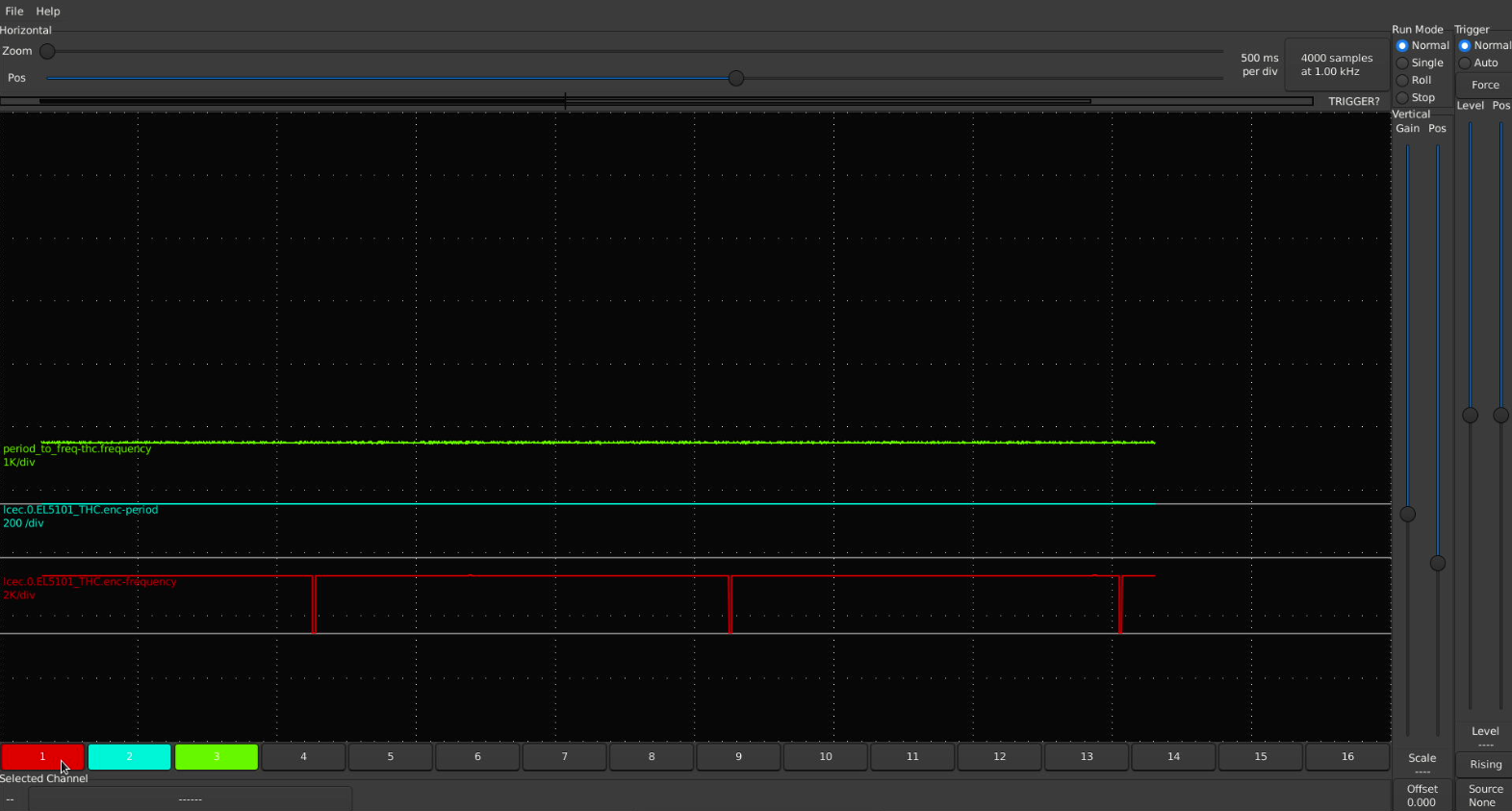

Yes, it consistently appears to be around 10ms.

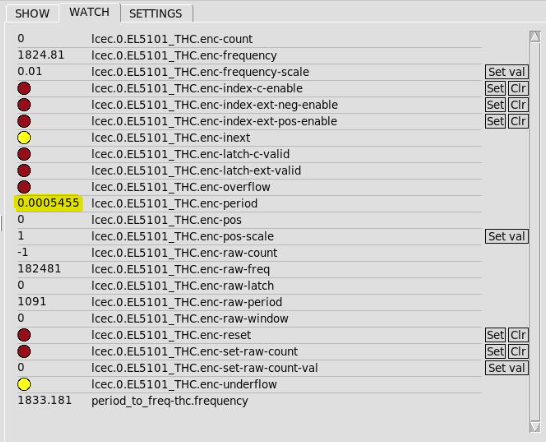

However, I believe I’ve found a workaround. I have noticed, that the EL5101 outputs the encoder period which is an absolutely stable signal. So I wrote a custom component to calculate the frequency based on it, which in turn can be used in PlasmaC. In the attached Halscope screenshot, you can see the troublesome frequency signal with drops from the EL5101 in red, the encoder period in cyan, and the calculated frequency in green.
loadrt period_to_freq names=period_to_freq-thc
addf period_to_freq-thc servo-thread
net measured-period-thc lcec.0.EL5101_THC.enc-period => period_to_freq-thc.period-in
net plasmac:arc-voltage-in <= period_to_freq-thc.frequencyPlease Log in or Create an account to join the conversation.

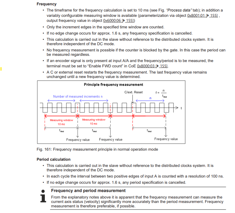

I looked through the EL5101 docs and - did I get it right? - it measures frequency by counting number of edge rises during a 10 ms window? Could be where 10 ms comes from. Seems low resolution also, frequency will be in steps of 100 Hz.

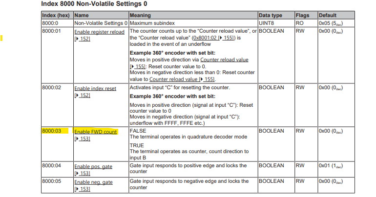

Yes, indeed. However since the drops seem to be random, I am not sure if it is related.
The manual also states that no frequency measurement is possible if the counter is blocked by the gate, but that in this case the period can be measured regardless.
And further: If an encoder signal is only present at input A/A and the frequency/period is to be measured, the terminal must be set to “Enable FWD count” in CoE 0x8000:03 [} 155].

If the pulse length method works for you it is even better. 100 ns resolution between two rising edges gives 0.1 Hz resolution and seems to be updated every cycle.
