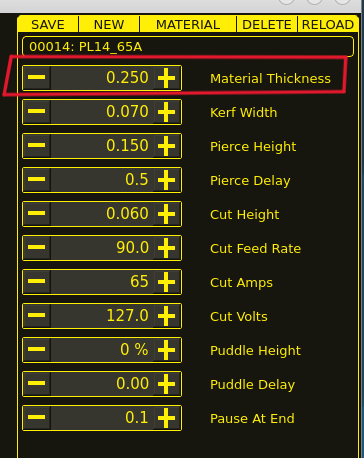

I would like to suggest a feature to fine tune ohmic probing.
Problem: When I set the probe height to an optimal setting for a thin steel setting, it will be too low for thicker steel, and set for thick steel it has excess travel.
My solution would be to add the material thickness to the plasmac.probe-start-height.
Keep the probe height setting function the same, but add a new setting into each material entry for material thickness.
To try to see if it would work, I used the puddle jump delay setting and used the sum2 function to add that number to the probe height. It seemed to work as expected.
With material thickness added the probe height should be more consistent with the top of the material.
This is the code I added to the custom_postgui.hal file.
unlinkp plasmac.probe-start-height
unlinkp qtplasmac.probe_start_height-f
unlinkp qtplasmac.puddle_jump_delay-f
net material-thick sum2.0.in0 <= qtplasmac.puddle_jump_delay-f
net probe-start-height sum2.0.in1 <= qtplasmac.probe_start_height-f
net probe-material-height sum2.0.out => plasmac.probe-start-heightPlease Log in or Create an account to join the conversation.

I have added the Material Thickness parameter option for Ohmic Probe with Material Height.
The updated files are in the attached qtvcp folder. It needs to be placed into your working machine config directory.
Also the attached custom_postgui.hal must also be in your machine config folder.
The qtplasmac-imperial_material.cfg file has the material thickness added, it has the settings for a Hypertherm Powermax 85.
Snowgoer, I'm not sure if the custom_postgui file is the proper place to do the hal pin linking. If you have time to review the changes and add it to the source code, I would appreciate it. Otherwise I can try to figure out git and do a pull request.

I should probably mention how it's set up. You will have a spinbox for Slat Height in the Probing section, and a spinbox for Thickness in the Material section of the Parameters tab. If you set BOTH the Slat Height AND the Material Thickness, then the probe start height will change based on the material thickness.
If either Slat Height OR Material Thickness are 0, then it will default to Probe Height. A high level recommendation I have (I have not tested this in practice, yet) would be to set Probe Height to 0. When Probe Height is 0, the probe movement will begin at probe speed from the current Z position. In most, if not all, cases while running a program, this would start a 5mm (0.197") below Z maximum height, as the g-code filter automagically adds these moves by default. That means that if you forgot to set a material thickness, your probe would start from the highest point possible, and it would probably be obvious that you need to fix it, and it would be the "safest" option.
