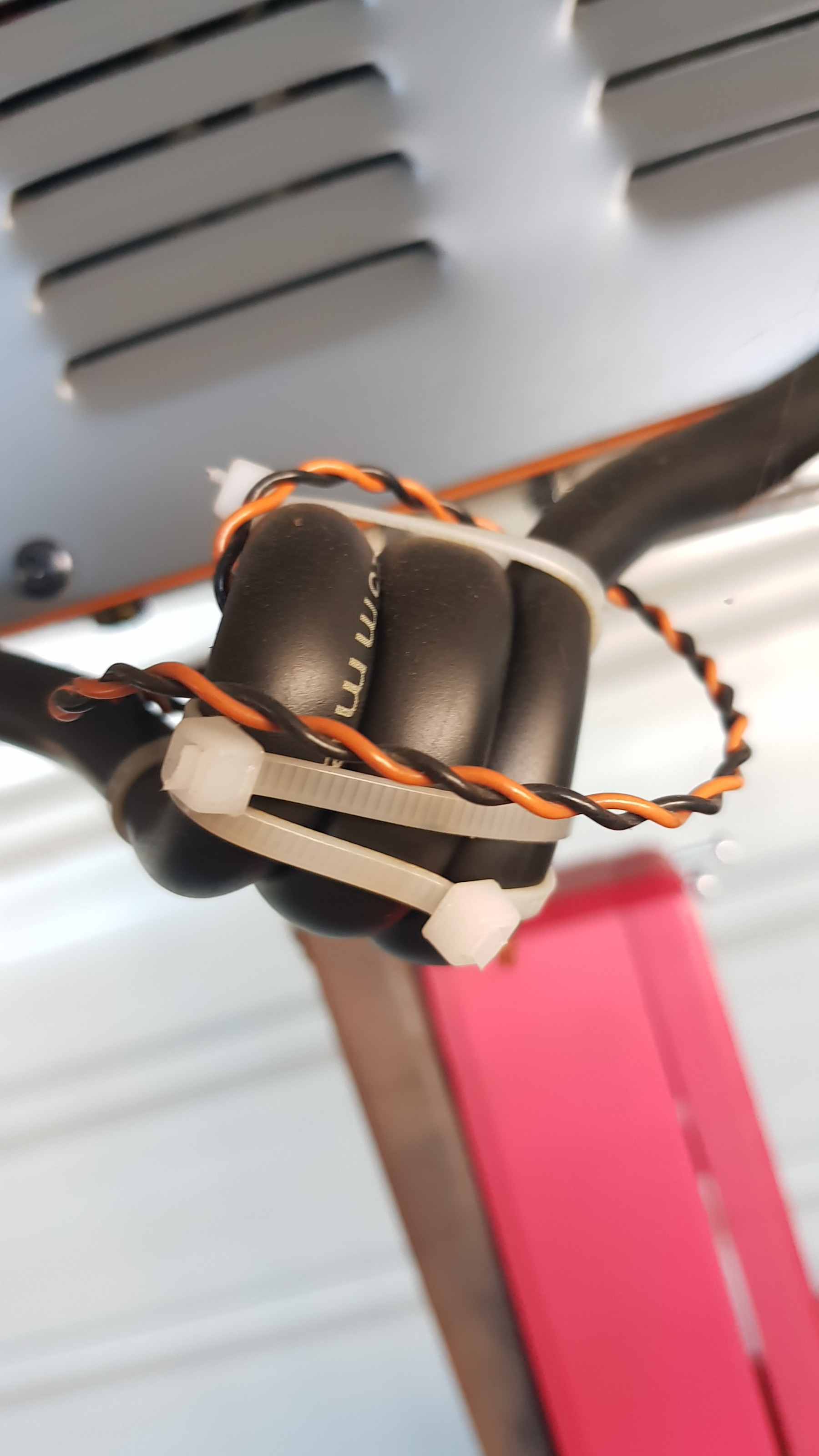

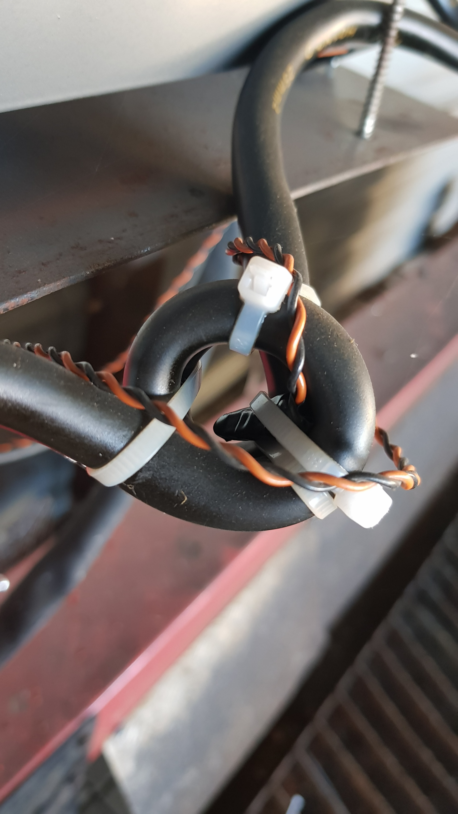

Replied by tommylight on topic QTPlasmac pierce delay handling

Aforementioned docs references:
Reed relay:
linuxcnc.org/docs/devel/html/plasma/qtpl...l#plasma:reed-arc-ok
Contact loading schematic:
linuxcnc.org/docs/devel/html/plasma/qtpl...tact-load-schematics
Calculations:
linuxcnc.org/docs/devel/html/plasma/qtpl...asma:qt-contact-load
Reed relay:
Calculations:
