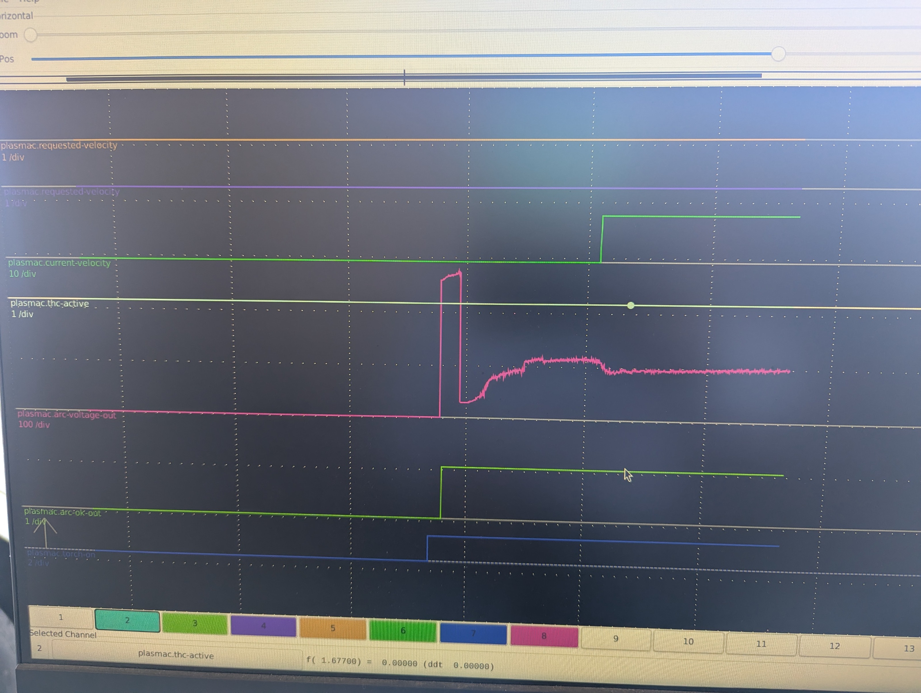

I took the follwing HALSCOPE trace where:
1)torch on triggers,
2)probe voltage goes to 260 for piercing, then falls, then recovers to around 94v
3)Arc OK signal goes to true
4)Pierce delay elapses
5)Movement starts
6)THC active never goes up and of course no correction
as Far as I can see voltage is "stable" once cut starts and there is no variation that could lead to deactivation as the tresholds are LOW=39 HIGH 990 (for testing purposes), samples 10 and threshold voltage 10.
has anyone had this issue or any lead on what to look at?

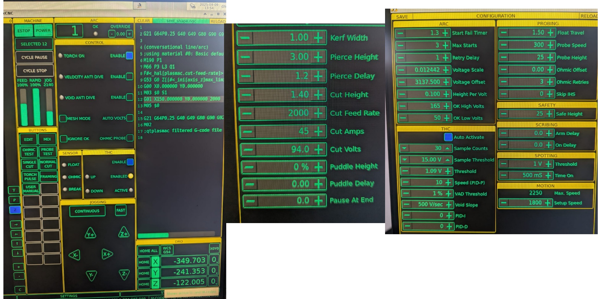

In the meantime, disable:
-auto volts
-void sense/void lock
-set the arcok high to 160V
-set the arcok low to 60V
-set VAD to 60-65%
-set the cut voltage to (in your case) 100V
-set the feed rate to 2000mm/m
-set the jog speed to roughly 2000mm/m
-press F9 to fire the torch
-press an arrow key to jog
-watch the LED's on screen for arcok/up/down
Material for testing, 2-3mm thick, current set to 40-60A
Make some test cuts, check the under side of the cuts for dross and how easy it is to remove it, adjust feed rate/ air pressure (only while air is ON) and cut voltage till you get nice clean cuts with little dross.

Hello Tommy thanks for your response, yesterday in follow up to your suggestion I set the parameters as I will show in the pictures below and I have some updates:For the first time THC stayed enabled during the cut, this happened around once every 5-8 tries, dint have the chance to validate it worked properly but that is some progress.*Something that i was not doing before is to set same speed in material table as well as in the G1 command of the G code idk yet if that has something to do with it, please see the next items.*Normal behaviour in my setup is that screen always went black for a second or two right after the pierce, it was so consistent that thought it was a feature of the GUI, yesterday noticed only a few runs where the screen did not go black, some of those matched the times where THC remained enabled. I checked and seems that the black screen is rather an issue caused potentially by EMI?*Changed plasma source settings to increase pilot arc and I could see the screen going black more violently. i.e. with flickering before going black.I am making some improvements to grounding to see if this helps, do you have any recommendations to make the arc ok, feature more resilient? in case that it is emi or do you have any other idea thanks.

Its an odd looking voltage plot.
I would look at the time after arc ok the THC is activated. To me it looks like it needs to be 2 seconds. I just can't see the setting I'm looking for.
Early activation could be disabled by the big fluctuations in voltage.
