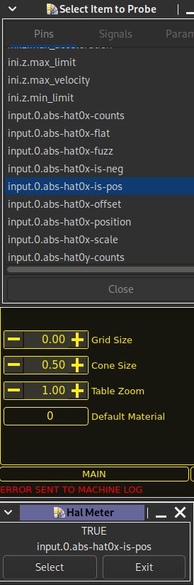

xbox controller
I was using a xbox controller which I setup now with pncconf, checked the pins and signals in halmeter, they are working.
Checked my hal, seems to be ok, but the thing will not jog , am I missing something (activate in Gui?)

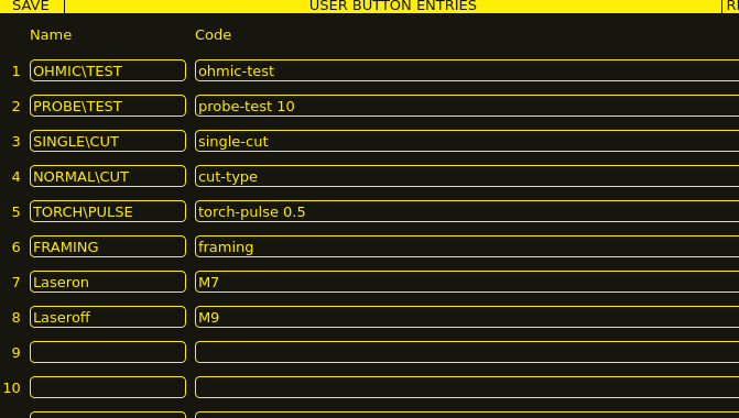

User Button
My crosslaser is connected to the mist I think 06 pin, and it works with offset setting etc.
I wanted to turn it on with a user button M7 on M9 off , did not work, I was not able to find in the documentation which commands are needed or possible in user button setup fields.

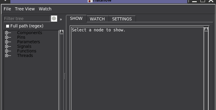

color change
is it possible to change the color of the hallshow?
the tree is so dark , I changed the linux debian theme already but it did not help.

#connect mdi commands to button presses
net xbox-a halui.mdi-command-00
net xbox-b halui.mdi-command-01
net xbox-x halui.mdi-command-02
BUTTON_10_NAME = Laser\ON
BUTTON_10_CODE = M7
BUTTON_10_IMAGE =
BUTTON_11_NAME = Laser\OFF
BUTTON_11_CODE = M9
BUTTON_11_IMAGE =
BUTTON_12_NAME = Move\Reset
BUTTON_12_CODE = o<offsetmove> call
[HALUI]
MDI_COMMAND = M7
MDI_COMMAND = M9
MDI_COMMAND = o<offsetmove> call
