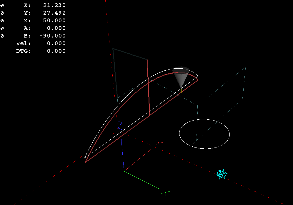

This is information to set up Plasma Rotary cutting.
Attached a modified post processor for sheetcam rotary. Rename the file extension from txt to scpost.
1. This postprocessor does not use a touch off or probe function. Probing for tube cutting is not a better option in practical way.
(In my case probing can be activated by selecting a gui screen button, this will trigger the THC2 component probe function, but i don't use probing when cutting tubes.)
2. It uses G64P0.05 for optimal accuracy during cutting.
(G64P0.01 up to G64P0.04 will result in bad rotation movement's (shocking) during corner rotation when cutting square tubes)
3. It set's the plasma power "S" in the g-code when a laser tool is used.
4. important : the Z axis zero point is located at center point of the main chuck. When zeroing your z axis on top of the profile, for example a square tube 100x100mm your z axis is at 50mm when on top of the profile, the z-axis value (50mm) can be included the cutting distance about 3-4mm, no problem.
5. Included is a 100x100mm draftsight dxf template file (flatten tube layout) that correspondent's with the sheetcam square tube layout 100x100mm, corner radius 5mm.
6. Attached picture is the output in linuxcnc. In this example you see probe was used. The probe has offset the actual cutting pat'h a little.
7. Example g-code output

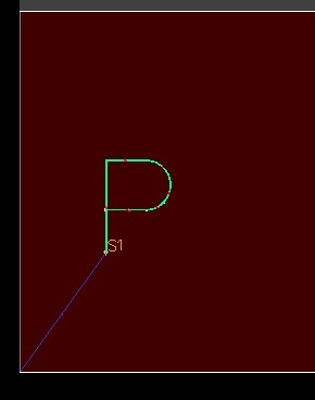

01 Dec 2020 06:54 #190750 by marcolagares
Replied by marcolagares on topic Linuxcnc plasma rotary
Hi Grotius,
Many thank´s for sharing your work. I was testing your post doing a P (see attach) and i got it mirrored.
I used the rigth hand rule (see attach) to configurate the rotary axis pointing thumb to the chuck.
Since is my 1st time doing this application what i am missing here? Machine setup, Sheetcam setup?
Thank´s in advance.
