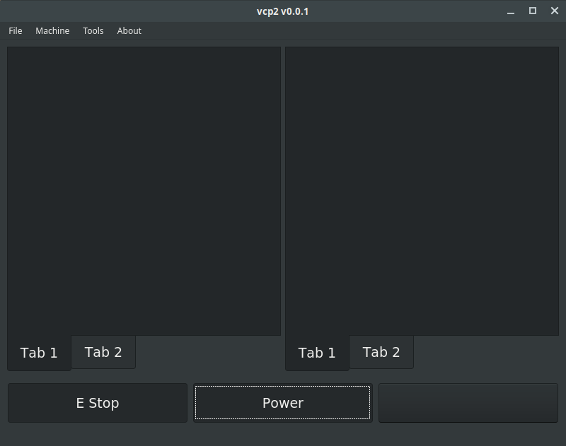

Hello,
I am hoping I am posting in a thread that makes sense.
I installed on Linux Mint 19.1 Cinnamon and seemed to be having some minor issues and was hoping maybe by chance you guys might have a simple answer for me. Not new to Linux but am new to Qt and Py.
What happens is I install the 3 buttons... E Stop, Power Home All and they work fine. But....
Since I am running Cinnamon the Gtk themes are involved and the theme takes over the styling of the buttons. So, whatever color is set in the theme, the buttons have the default colors pertaining to that theme. It's kinda funny and kinda frustrating.
I thought the QtPy would override the styles given the qss files. But it appears not so much.
It took me a few days to get my system dialed in so that the plugins finally showed up and now this is the only issue I cannot seem to get past.
Any ideas or help would be most appreciated.
Fyi... I am a 30 year CNC controls engineer specializing in Fanuc, Siemens, and Heidenhain so I will not try to bore you with dumb questions. And if you have any questions regarding CNC technology feel free to rob my brain. If I do not know, I can assure you without fail I know someone who does.
Thank you in advance and I hope to hear from you soon.

Well, never mind. If all else fails, read more. The theme for windows is set in the ini file. Problem solved.

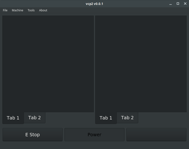

03 May 2020 18:39 #166548
by helmholtz
Replied by helmholtz on topic QtPyVCP Tutorial
I'm having a hard time getting the CSS file to be applied when following the tutorial. Any changes I make to the 'style.qss' file are ignored. In fact it seems like the current Mint system theme is applied to the VCP instead. anything that I can try to force the CSS? thanks!

04 May 2020 10:15 #166627
by KCJ
Replied by KCJ on topic QtPyVCP Tutorial
Do you have the correct QSS file specified in the YAML file?
If so it will override any system theme.
