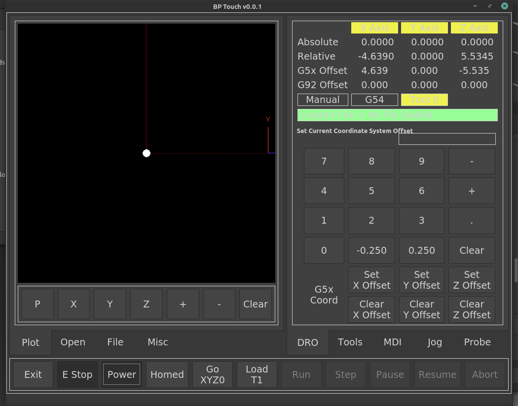

I guess I am not entirely sure what the problem you are having is. Is the QSS not being applied? If so make sure there are no syntax errors in your style sheet, as that will prevent it from loading, but it should throw errors indicating the problem.
You can try using the --stylesheet option when launching QtPyVCP and passing the full path to the QSS file and see if that works. Run qtpyvcp -h for help on how to use the option.
The qt5ct plugin warnings you are seeing are completely unrelated to QtPyVCP. This is the Qt System settings plugin, used for setting global fonts, icon sets etc. I don't know why it prints those messages, but they are talking about the QTPyVCP style sheet.

To clarify, the QSS files are being ignored when the VCP loads. It does not matter what VCP is chosen. I have not edited any of the files. In all cases the Mint system theme overrides any and all style settings within the VCP. I've attached a screenshot of one of the sample vcp files.
again, I've not edited or changed anything. I hope this makes sense.
