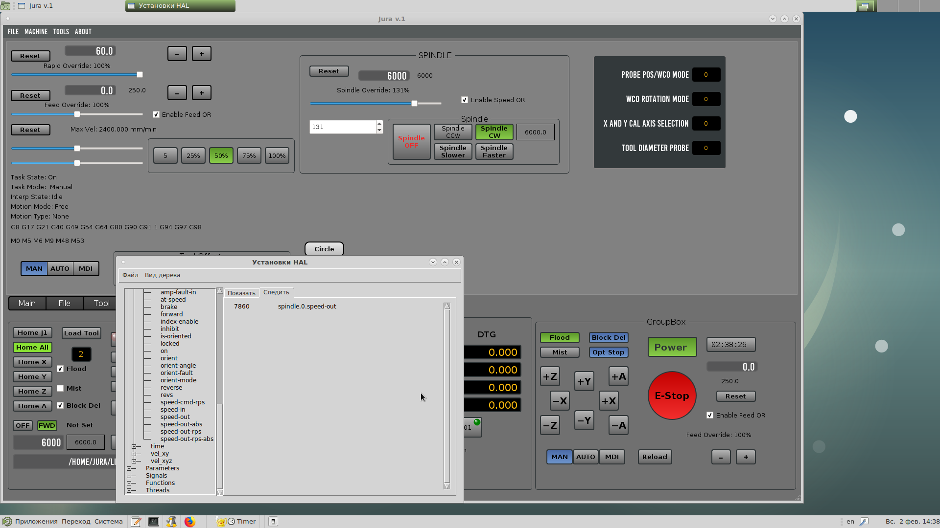

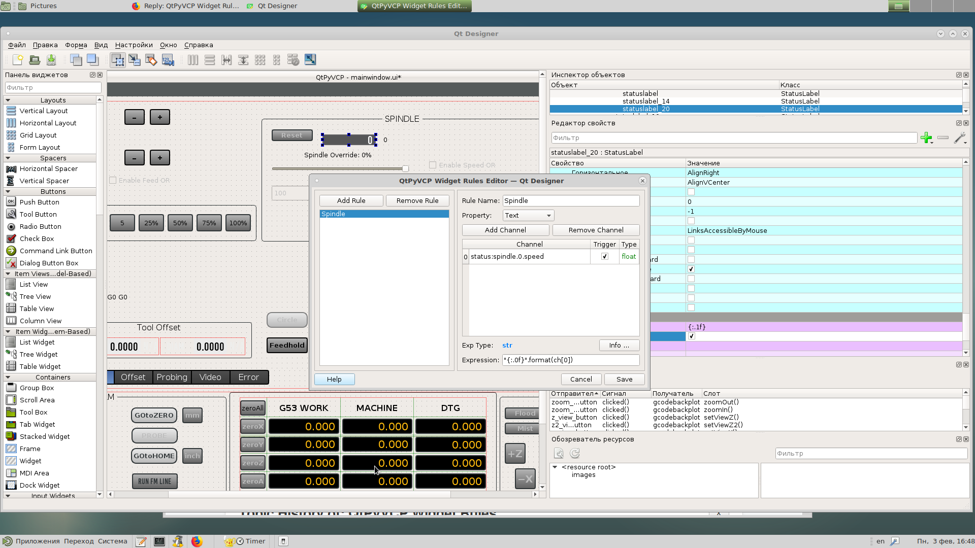

Hello. When adding spindle speed with the slider, the speed in hal show changes, but not in the indicator. Can this be fixed with Widget Rules?

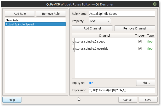

hottabich, yes, you can do almost anything with rules!
The `status:spindle.0.speed` value is the programmed spindle speed (always matches the value of the last S word in gcode). So to get the actual commanded spindle speed you need to multiply by the spindle override, which is available as `status:spindle.0.override`.
Thanks, it works!
