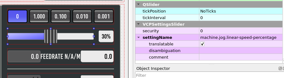

I was able to connect my MPG & selector to halui.axis.jog-speed so now I've got a physical adjustment for jog speed. Same thing for FRO, SRO, and RRO.
Problem is that while the FRO, SRO, and RRO UI sliders and status DRO's are all responding to external inputs (i.e. move on screen with my encoders), the on-screen jog adjustment does not respond to external inputs.
Even though I have not connected to any of the qtpyvcp exported hal pins the overrides mentioned still work on screen. Nor did I put anything in the post-gui hal file. They just seem to work ok.
I'd like to connect the jog slider as well. How can I do this?

Connect to machine.jog.linear-speed-percentage in postgui? Is that pin name exposed to hal like qtpyvcp.rapid-override-reset?
Reason I ask is that I didn't see any qtpyvcp jog related pins exposed in halshow.

Sorry if I wasn't clear but I've already got the hal pins exported in my custom_config.yml file. Same config as from the post you linked.
That's what I was referring to earlier when I wrote that I can see the qtpyvcp RRO/SRO/MVO reset pins in halshow.
It's the jog slider that doesn't appear to have an exported hal pin connection.

ok so the other overrides are coded and exposed already the jog percentage slider is not, so will need to expose it probably in the back end to make it easy to access, need to see what is needed there to accomplish.

try this in the postgui hal file, but with your naming for the net input of course, this is just generic:
# *** Set Line Below for ui Jog Slider hal connection ***
net linear-jog-speed-external-input => qtpyvcp.machine.jog.linear-speed-percentage

Thanks, but no joy.
LCNC throws up with 'pin doesn't exist'
Looking at halshow there are only three exposed override-related pins:
qtpyvcp.feed-override.reset
qtpyvcp.rapid-override.reset
qtpyvcp.spindle-override.reset
On the other hand, what I don't understand is if only the xxx.override.reset pins are exposed, why do the RRO/FRO/SRO status dro's displays and sliders follow external inputs?
My (naive) common-sense tells me only the reset function should work as there's no obvious connection between halui.xxx-override.counts (in) ot halui.xxx-override.value (out).

The plot thickens...
It looks like rapid/feed/max-vel/spindle overrides are linked(?) to value changes in machine_actions.py and spindle_actions.py
def _rapid_override_bindOk(value=100, widget=None):
# This will work for any widget
STATUS.task_state.onValueChanged(lambda: _rapid_override_ok(widget=widget))
try:
# these will only work for QSlider or QSpinBox
widget.setMinimum(0)
widget.setMaximum(100)
try:
widget.setSliderPosition(100)
STATUS.rapidrate.onValueChanged(
lambda v: widget.setSliderPosition(v * 100))
except AttributeError:
lambda v: widget.setValue(v * 100))
widget.setValue(100)
rapid_override.set(100)
pass
except:
LOG.exception('Error in rapid_override bindOk')
rapid_override.set.ok = rapid_override.reset.ok = _rapid_override_ok
rapid_override.set.bindOk = rapid_override.reset.bindOk = _rapid_override_bindOk
But the jog-override section of machine_actions.py doesn't appear to have the same 'onValueChanged' functions:
I don't understand python, but it looks like the jog control was written differently than the other overrides.
Warning: Spoiler!
try:
try:
pass
except:
Warning: Spoiler!
def _jog_speed_slider_bindOk(widget): try:# these will only work for QSlider or QSpinBoxwidget.setMinimum(0)widget.setMaximum(100)widget.setValue((jog.linear_speed.getValue() / jog.max_linear_speed) * 100) # jog.linear_speed.connect(lambda v: widget.setValue(v * 100))except AttributeError:pass def _jog_angular_speed_slider_bindOk(widget): try:# these will only work for QSlider or QSpinBoxwidget.setMinimum(0)widget.setMaximum(100)widget.setValue((jog.angular_speed.getValue() / jog.max_angular_speed) * 100) # jog.linear_speed.connect(lambda v: widget.setValue(v * 100))except AttributeError:pass jog.set_linear_speed.ok = jog.set_angular_speed.ok = lambda *a, **k: Truejog.set_linear_speed.bindOk = jog.set_angular_speed.bindOk = lambda *a, **k: True jog.set_linear_speed_percentage.ok = lambda *a, **k: Truejog.set_linear_speed_percentage.bindOk = _jog_speed_slider_bindOk jog.set_angular_speed_percentage.ok = lambda *a, **k: Truejog.set_angular_speed_percentage.bindOk = _jog_angular_speed_slider_bindOk
