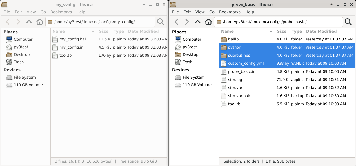

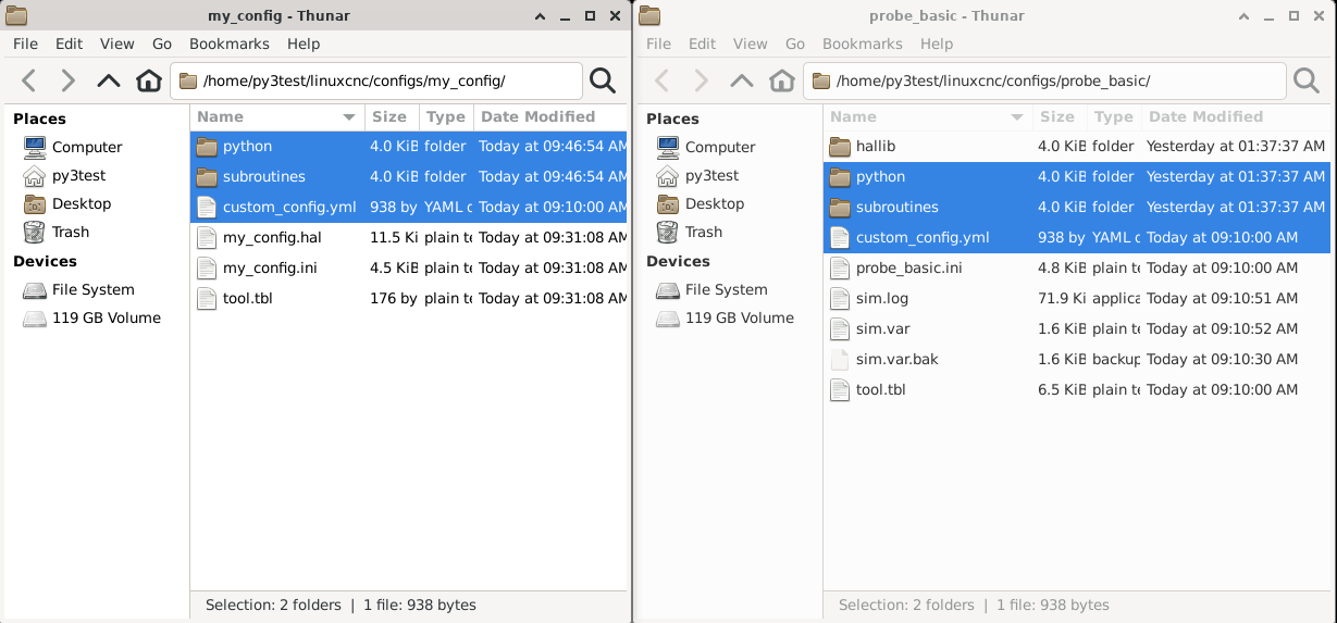

Step 3: In the Linuxcnc config folder, there should now be a config folder from the output of Pncconf, there should also be the probe_basic config folder. Both will be used for copying required files over to the new machine config folder. Open two windows in the file tree, the new Pncconf folder and the probe_basic config folder. Copy the highlighted files shown below from the probe basic config folder to the Pncconf config folder. Below you can see that I removed any unnecessary files and folders from what would be a basic installation for converting to probe basic. If you have a special case for having certain files then please use your discretion in leaving the required files for your use. What is shown will be the minimum starting point for the config conversion for Probe Basic:

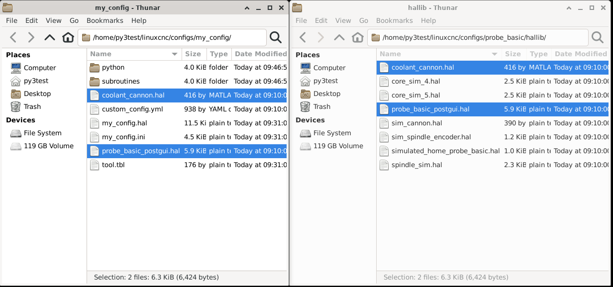

Step 4: In the probe_basic config folder, open the hallib folder. Copy over the three highlighted folders and file shown in the image below to the new Pncconfig folder.
Open the hallib folder in the Probe Basic Sim config directory, Copy over the two highlighted files as shown in the below image:

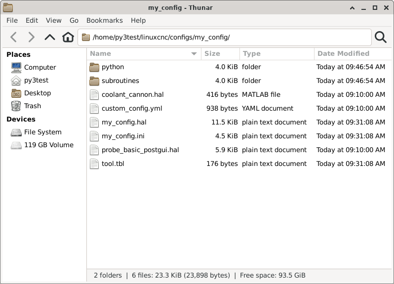

Your config folder should now look like this and have the required files in it:

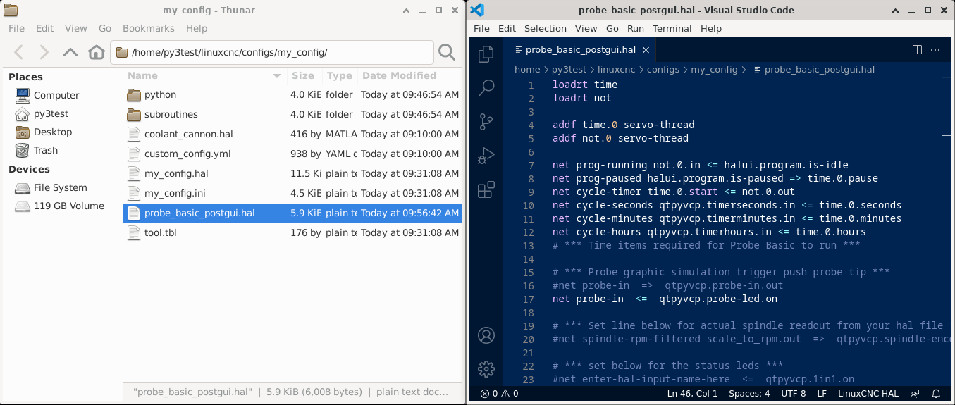

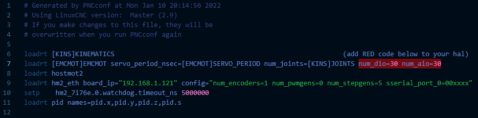

Step 6: Editing the hal file. In the text editor, open your Pncconf hal file, show in the example as my_linuxCNC_machine.hal. Probe basic uses dio and aio for its various subroutines and macros, the count of these needs to be added to the hal file by editing/adding to the line as shown in the below image:
Step 7: Editing the probe_basic_postgui.hal file. The two edits below should be used to convert from the sim required file to your machine postgui halfile. ***NOTE only one postgui halfile can be used so any post gui hal entries you may need should be incorporated into this file or there will be conflicts. The first edit is to comment out or delete the line:
net probe-in => qtpyvcp.probe-in.out
(This line is only used in sim for development of probing routines and cannot be used in a machine configuration)
The second edit is to remove the connection to the spindle encoder if one is not used. If you are using a spindle encoder, you can edit this line to match the output from your configuration file which will give you the option in probe basic to select it as the spindle speed DRO rpm source. The user selection to change between software calculated rpm display and actual encoder display is on the settings page in probe basic. To comment out and leave in the file for future use simply enter the # symbol in front of the line as shown below.
#net spindle-rpm-filtered scale_to_rpm.out => qtpyvcp.spindle-encoder-rpm.in
As long as the information you entered in the Pncconf config builder is correct, this should now give you a working probe basic installation that will run your machine.
