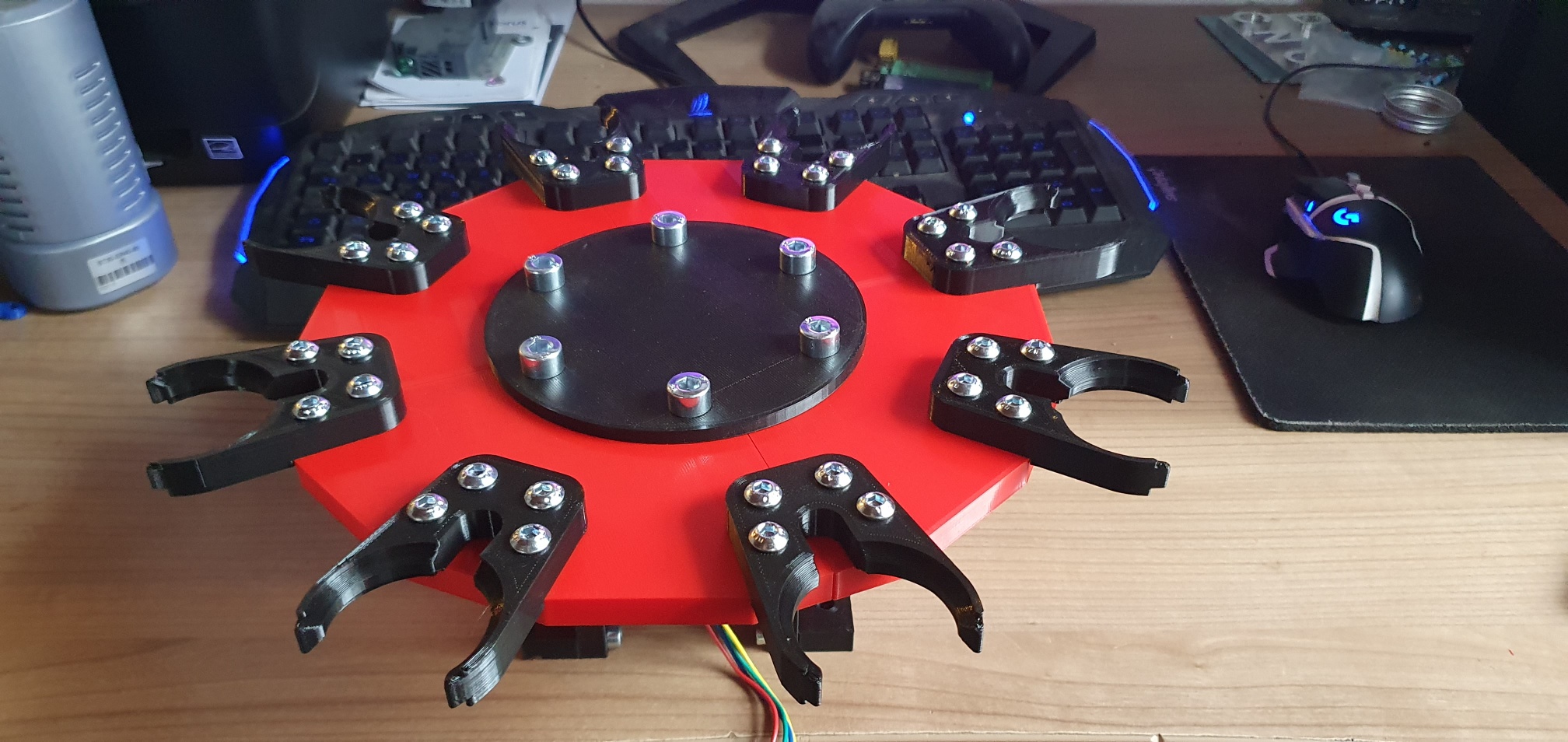

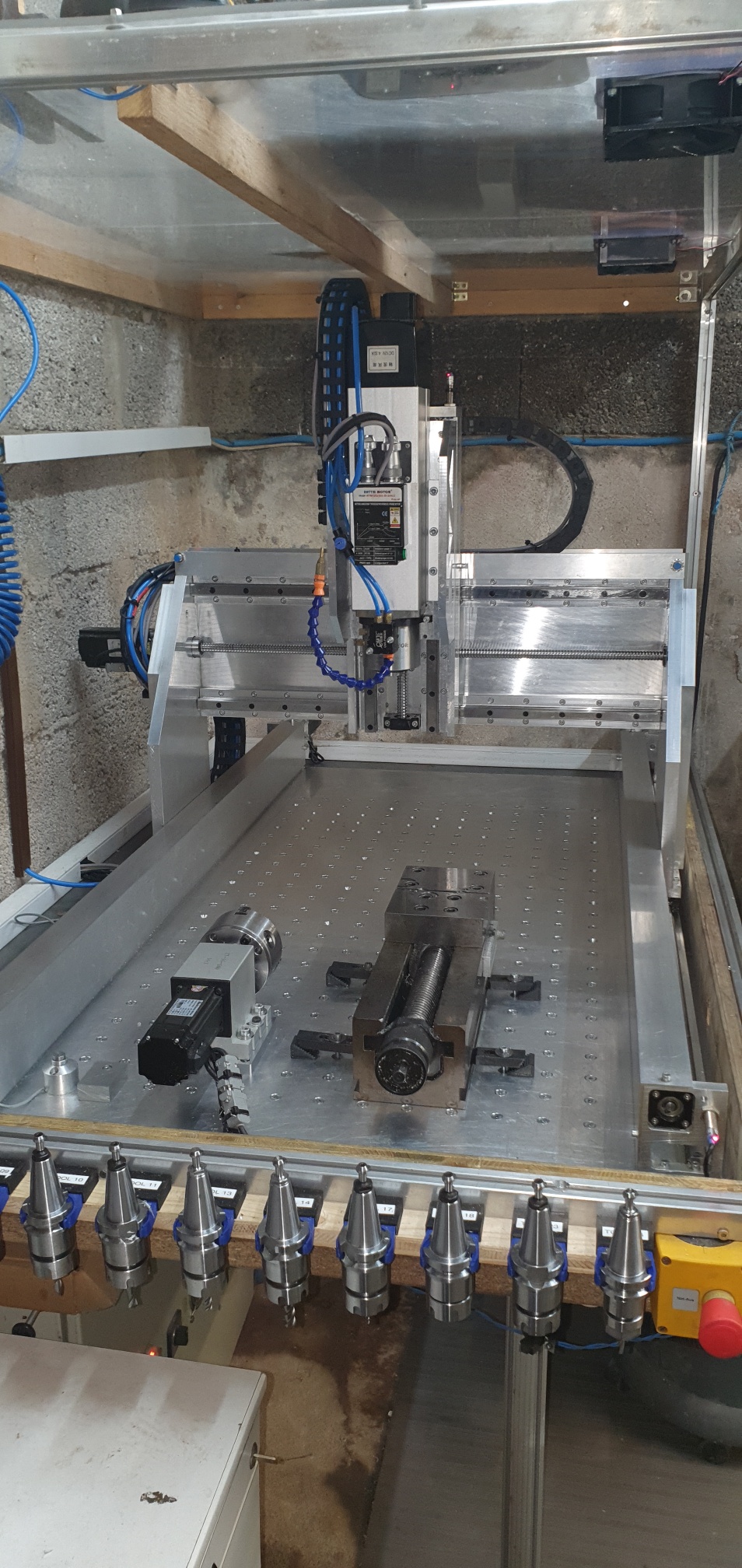

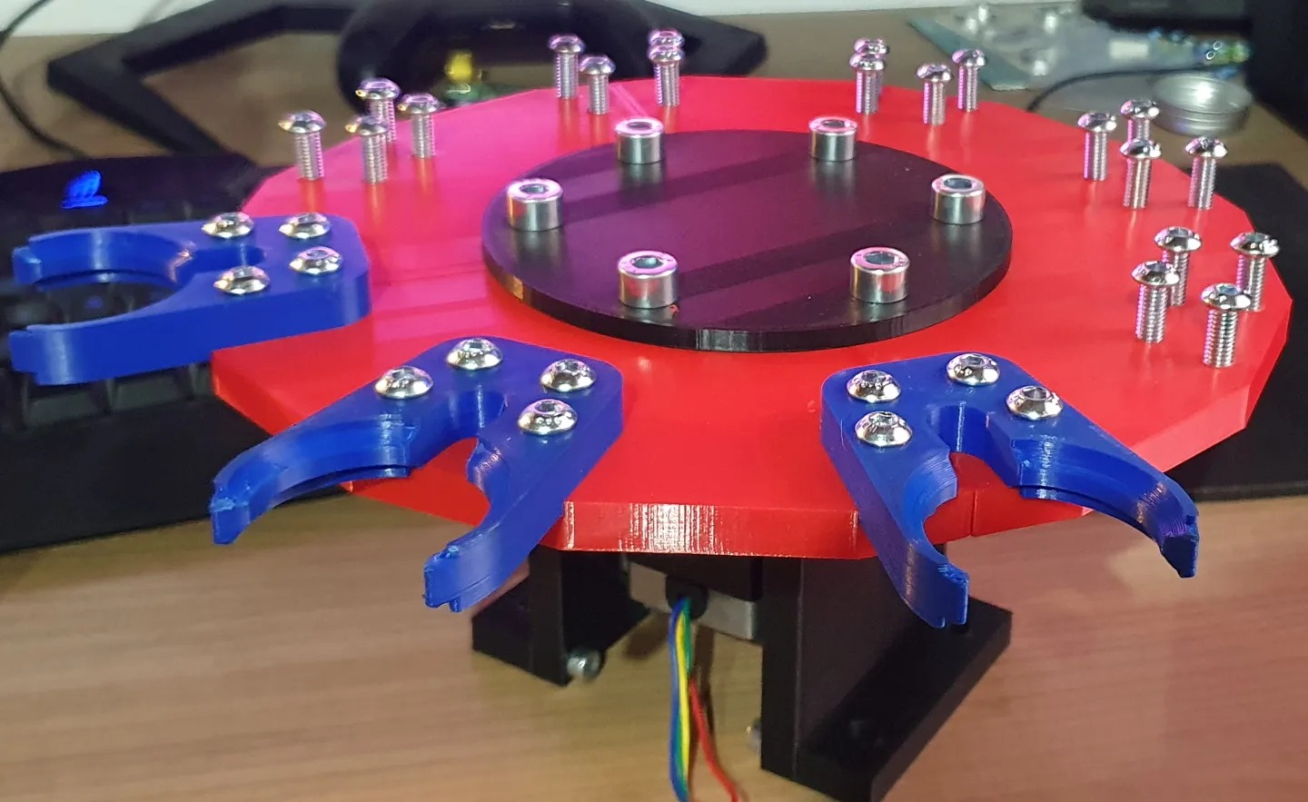

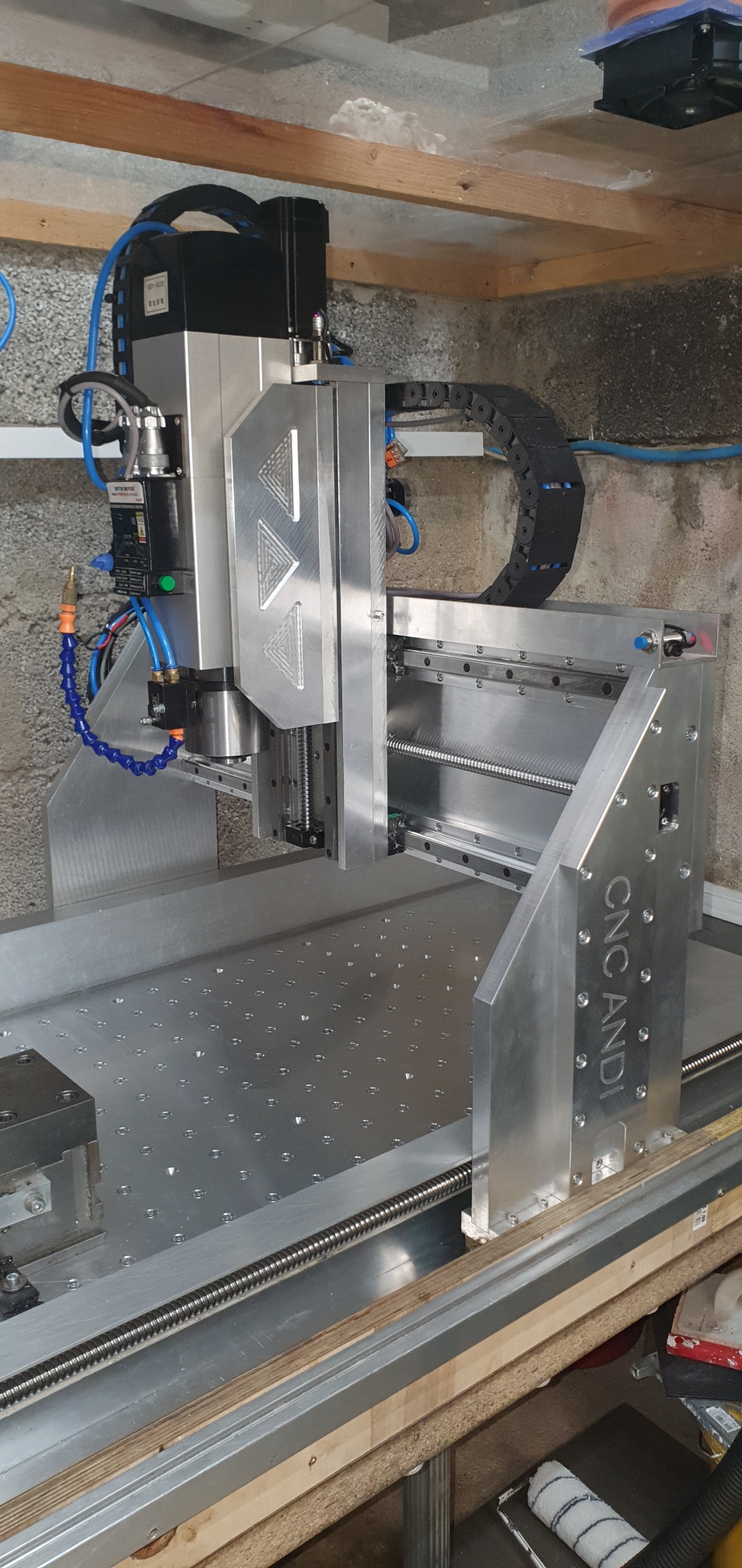

Hello thanks for your post.
The toolchanger is driven by a Stepper Motor.
The Atc has a fixed position.
By Bt30 spindle will pick up the tool.
Move to toolchange position in g53 z0 , Z down, Y +, unclamp, z up, clamp, toolchanger rotate, unclamp, z down, clamp, Y -, toolchangeposition g53 z0
I think my spindle have 2 sensors for clamped oder unclamped tool.
see the pictures for my spindle, machine and toolchanger....
the toolchanger will be placed on the back site of the machine...

You appear to have a rack-type tool changer already. Is it working, and what GUI are you using now?
Is your intention simply to change from the rack-type to a carousel-type?

yes, it´s my prototype and all parts are 3D printed...if this toolchanger works fine i will mill all parts in alloy...
but now it´s time to configure this thing...
but i don´t now how. so i need much help to realize this.
i will make a deal with you... help me to get this to work fine and i will give you the complete projekt as an .step
