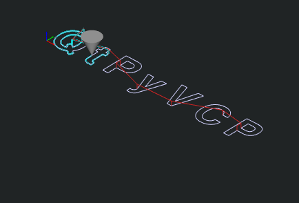

Another issue I have is that the “cone” that represents the tool does not follow the toolpath displayed in the gui…the tool path works correctly and the work coordinates correlates to the location of the toolpath correctly, but the representative cone just kind of moves around out in space on the screen not following the graphical tool path…is this a known issue as well?
29 Nov 2023 05:27 #286752 by Lcvette
Replied by Lcvette on topic Probe basic—Help with a few issues
Not that i am aware of, i do not see any of this behavior, do you have any offsets set? maybe take a shot of your offsets page or try clearing the offsets, then setting a new wcs then load the program?
