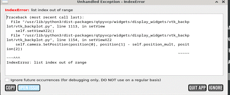

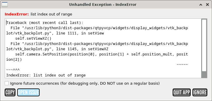

26 Jun 2024 11:48 #303826
by Anton
Replied by Anton on topic ProbeBasic backplot issue?
Hello,
when I start the probe_basic_lathe simulation and change the view, I get an error in the file vtk_backplot.py.
I have installed the latest LCNC 2.9 ISO.

27 Jun 2024 14:23 #303901
by Lcvette
Replied by Lcvette on topic ProbeBasic backplot issue?
i can verify, taking a look! thanks for the report!Hello,

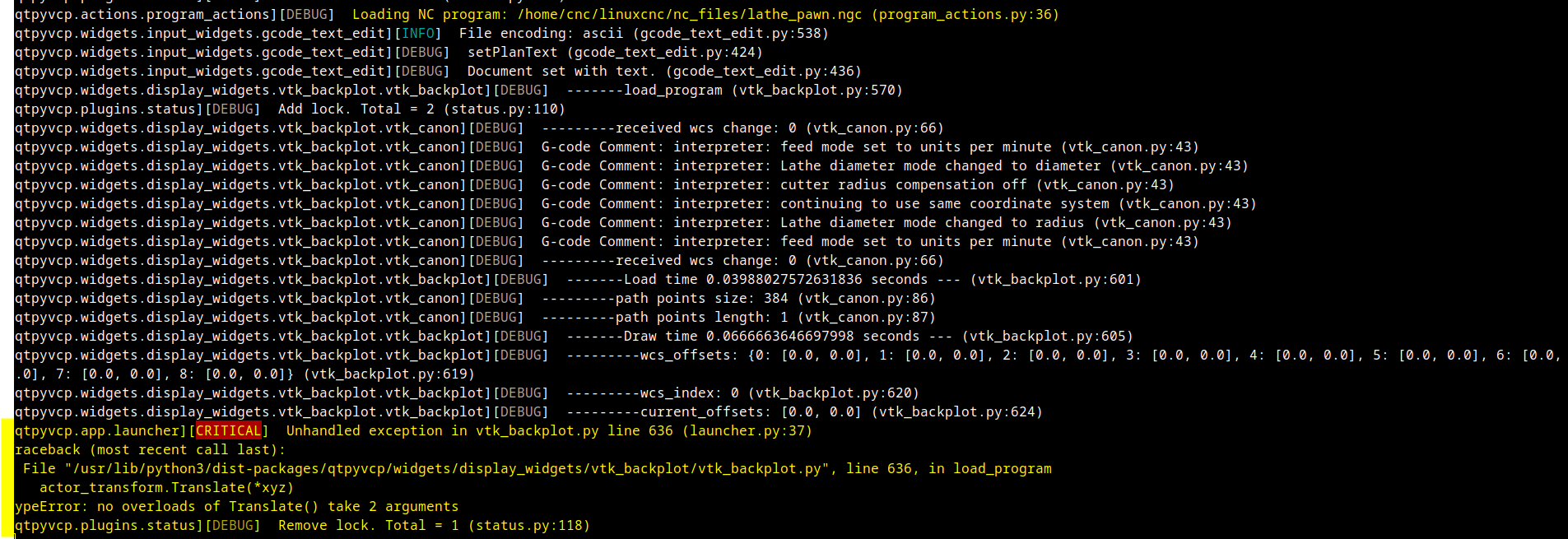

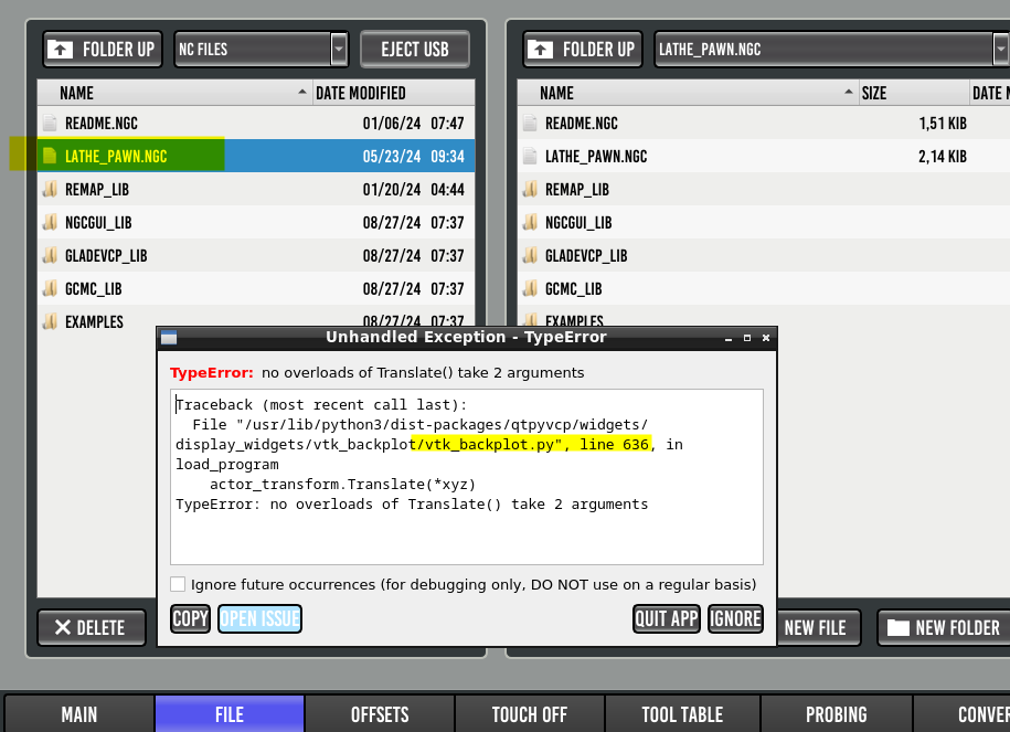

07 Sep 2024 15:36 - 07 Sep 2024 16:58 #309587
by MrStupid
Replied by MrStupid on topic ProbeBasic backplot issue?
Error when trying to open a standard pawn turning file. This error appears only in the turning configuration.
In the milling configuration, there are no problems when starting 3D_Chips.ngc. Pls, help me.
Debian 12.6 + linuxcnc 2.9.3 from .deb install + probe basic apt install
