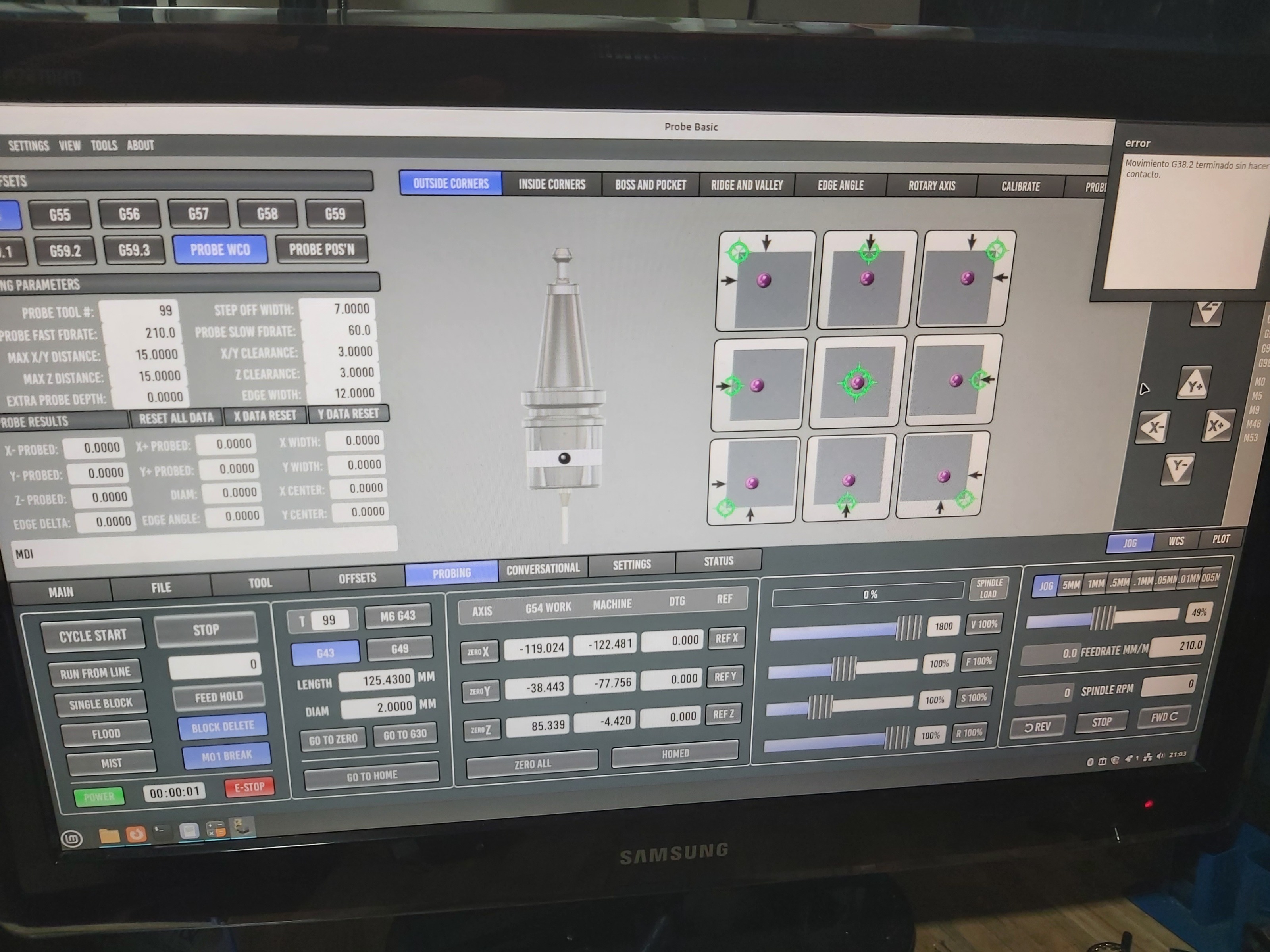

Hi, in probe basic when the 3d probe can't finish or I cancel it, the axes don't move until I bring the machine home.
Is there a way to not have to do homing so that the axes keep moving?

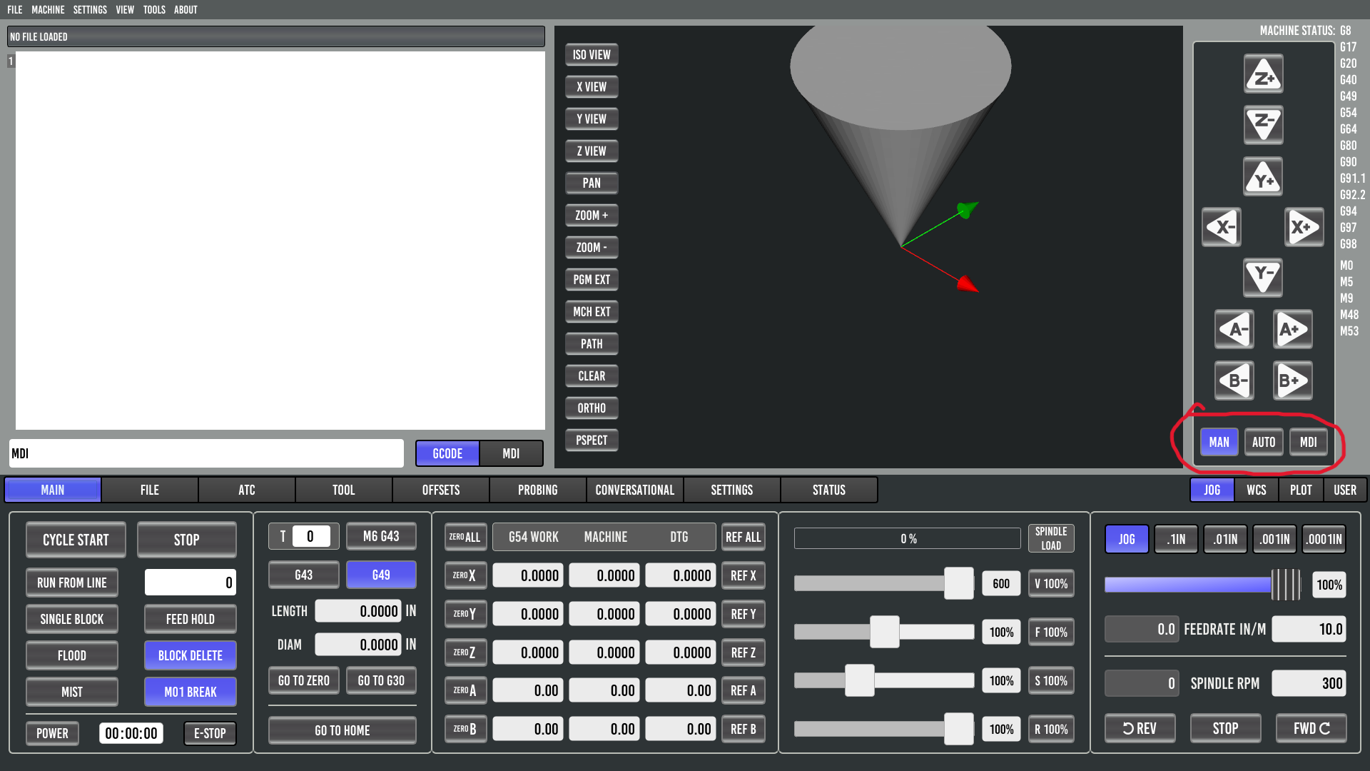

26 Sep 2024 20:13 #310852
by spumco
"JOG" is not a mode. Even if the on-screen jog button is highlighted, LCNC can still be in MDI or Auto mode.
It looks like your screen has been edited to remove the mode indicator-buttons... or you've got a different version.
I've circled the mode buttons in the attached pic. You can also open halshow, and under 'halui' add the various mode indicators to the watch list to see what mode LCNC is in.
If, after a subroutine is aborted, LCNC is in Auto mode, you won't be able to jog regardless if the GUI's 'jog' button appears active.
Replied by spumco on topic Probe cancellation does not move the axes.
Are you changing back to manual mode to enable jogging? When it doesnt complete a subroutine it will be in auto mode.
jog mode is activated.
- Ismacr63
- Posts: 174
- Thank you received: 11
26 Sep 2024 20:38 #310854
by Ismacr63
Replied by Ismacr63 on topic Probe cancellation does not move the axes.
I don't know why those modes aren't shown in my version. I just downloaded it, followed the installation instructions and it looked like this.
How can I add them?
How can I add them?

- Lcvette
- Posts: 1682
- Thank you received: 784
27 Sep 2024 11:35 #310880
by Lcvette
Replied by Lcvette on topic Probe cancellation does not move the axes.
you are not in full screen mode, hit F11 to allow the display to correctly fit the screen.
