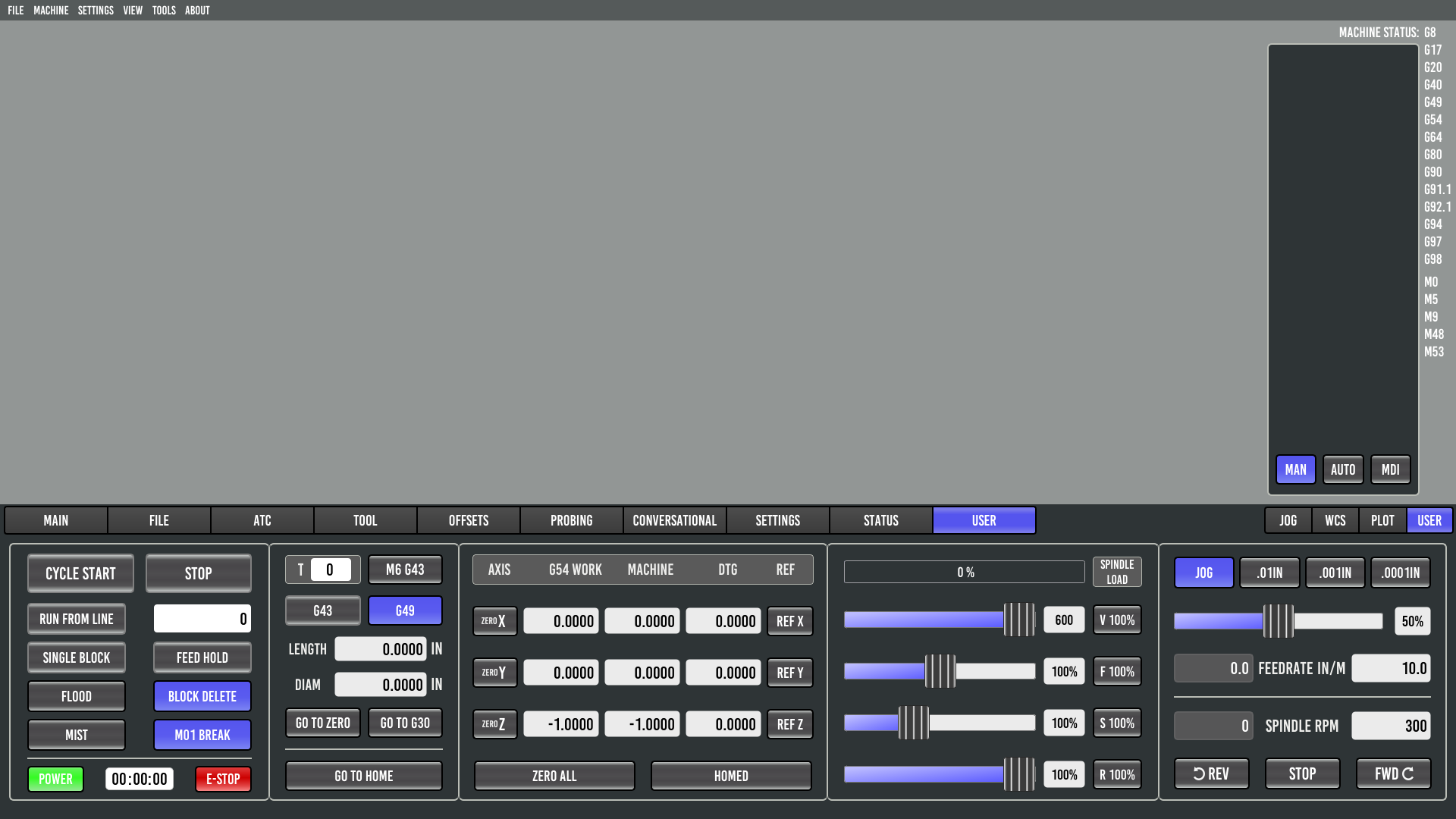

09 Oct 2024 11:46 - 09 Oct 2024 12:03 #311639
by FedX
Replied by FedX on topic Installing older version of ProbeBasic on buster and linuxcnc 2.8
I'm trying to switch to the newer version but with my own screen i built back than..
I installed the dev version of ProbeBasic and exchanged the probe_basic.ui with my own. If i use the launcher probe_basic_mill_designer.sh it opens my screen and luckily it looks quite promising so far. Its only missng two attributes "referenceType" and "axis".
But if i want to test the sceen and open the desktop starter probe basic mill it shows the standard UI. Regarding to the documentation this should run LinuxCNC with the UI changes i made shouldn't it? Where is the GUI of probe basic located?
And is paramsaver not available anymore with linuxCNC 2.9? It seems that it cannot load it.
Ok just found out that the shortcut for probe basic mill just uses the ui which is in python3/dist-packages/probe_basic
i thought the dev edition runs a virtual enviroment ?
Last edit: 09 Oct 2024 12:03 by FedX.
