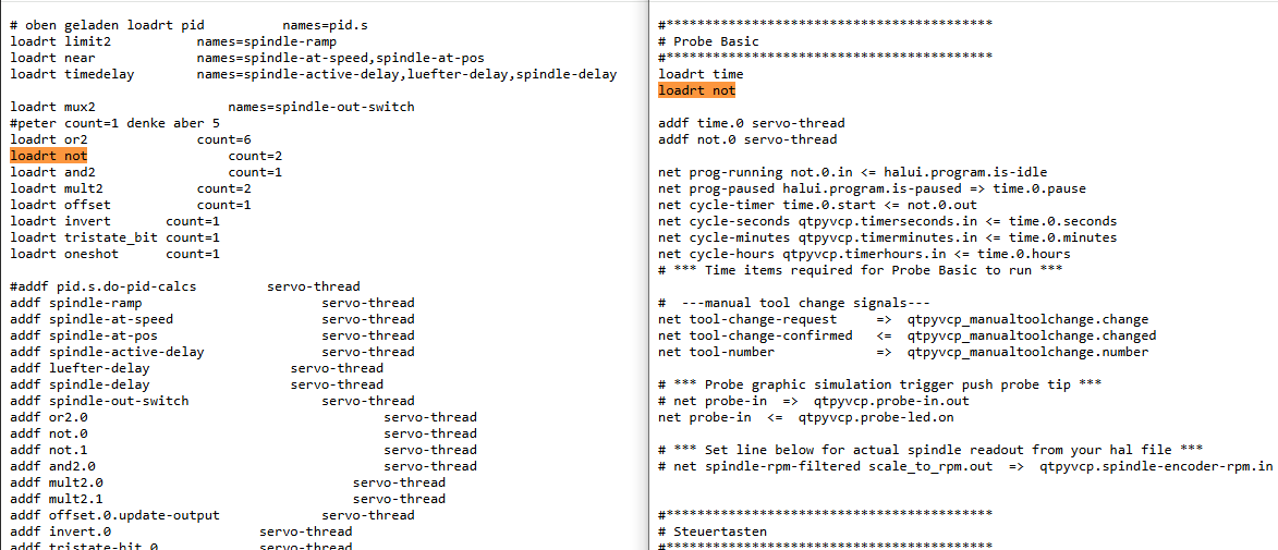

[qtpyvcp.app.launcher][[36mINFO[0m] Loading POSTGUI_HALFILE: /home/cnc/linuxcnc/configs/Black_Phanter/postgui.hal (launcher.py:98)
not: already exists
not
^^^ already exists, looks like maybe you are trying to load it twice in different locations
not: already exists
not

17 Dec 2024 13:05 #316857
by Lcvette
Replied by Lcvette on topic Probe Basic do not start
- Blume
- Posts: 42
17 Dec 2024 20:27 #316886
by Blume
Replied by Blume on topic Probe Basic do not start
Thank you very much !!! know it works
