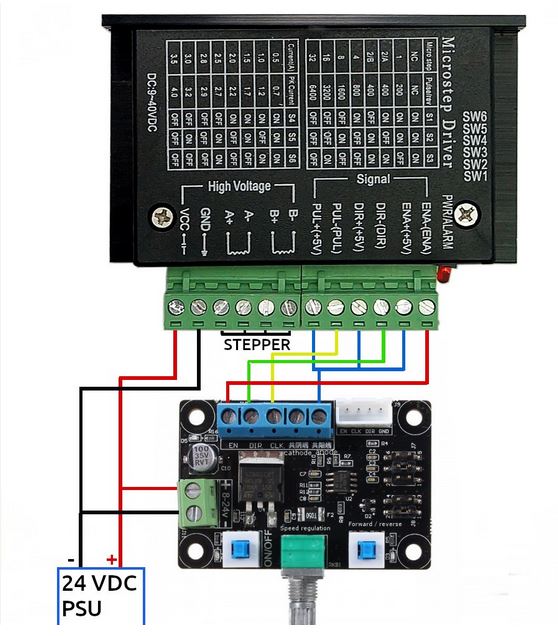

That's how it works for the MESA, but the MKS OSC stepgen board works a bit differently.
I think it's continuously sending pulses and just switches the drive by the enabled signal.
If I remove the EN wire, it just starts running.
Maybe disconnect the EN wire and just toggle the CLK wire with the on/off relay? (that's the pulse signal)
Last edit: 01 May 2025 17:23 by IB_CnC.

Why are you using the stepgen board?

i think because the carousel comp stepgen output setup is a bit more daunting. at least i haven't found a bunch of folks using it. i think spumco is the only person i know running it

Probe basic was prepared to control a dumb motor FWD and REV just by two outputs.
I didn't know so I bought a stepper motor with gearbox and driver because at first I wasn't considering the geneva wheel.
Started out with the MESA stepgen but later on I thought might as well keep that for a future rotary axis, as the small PCB is 10 bucks + 2x a relay, so thats why I set it up like this.

If so, using a stepgen (if possible without joint/axis) and setting the scaling and steps/unit with the FWD/REW outputs from carousel to stepgen should work in hal...

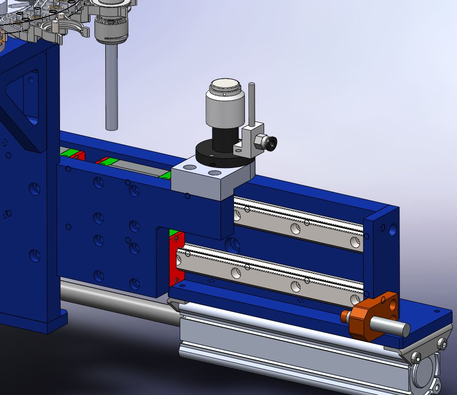

Im at the point now where the carousel extends, gets detected, spindle moves to clearance height, spindle unclamps the tool etc..
All 5 sensors are working, Carousel Home, Carousel Index, Carousel IN position, Carousel OUT position and the Spindle Tool Clamped and Tool Released sensors.
Now its time to program the final movements, placing and removing a tool from a pocket.
Will be a little different probably compared to other carousel toolchangers where the carousel moving in and out takes the tool from the spindle.
When no tool is loaded it has to move down, clamp the tool, moving to the right to take a tool from the pocket, carousel retract, spindle up again and resume.
Or with a loaded tool it has to move in front of the carousel, moving to the left into the pocket, unclamp, up, rotate to new tool, down again etc.
Should be fun, hopefully it won't get fooked. :-D

Made the first toolchanges today!
Altough, taking a tool from the ATC is not yet working optimally.
I was customizing the M21 and M22 subroutines to get it working, but in the end found ''toolchange.ngc' which is also playing a part.
I probably need to add some movements specific to my atc to toolchange.ngc instead of to the M22 subroutine.
Other than that pretty happy it's doing its job!
