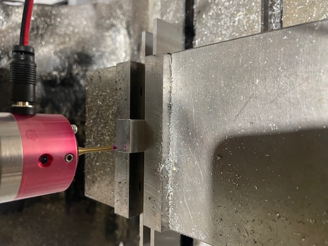

Thank you I got it working. Today I attempted to probe a top left outside corner and noticed that when the routine went to probe the "Y" side the probe does not move over enough to the positive X to probe the material. It does like it should when it probes the X. It does the same on all outside corners. It probes the center position just fine. I attached a pic of the probe start position and where it fails to move over enough. Any ides on what to look for?
- Lcvette
- Posts: 1683
- Thank you received: 784
9 months 1 week ago #341978
by Lcvette
Replied by Lcvette on topic Probe Basic Stable error
Step off width.
Read the probe help on the probing page for explanations on how probing settings works.

pretty sure i have all the setting correct as that was my first suspicion. I have already calibrated the probe and used it to find the center and z height of the stock.. I don't think that would have been possible with bad values? Or am i wrong? I will check again tomorrow. I used the original PB for several years so I am pretty familiar. Also, the pictures are confusing; the second pic the probe had already completed the x measurement and moved into position for the Y. the probe did step off the correct .3" in the x direction.

.3 pretty small unless you have it real close to the corner when you start. Do you have the probe tip diameter set in the tool table?
Do the other corners behave the same?
