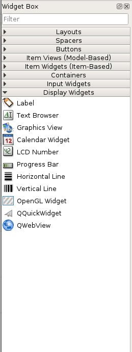

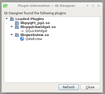

07 Feb 2020 04:10 - 07 Feb 2020 04:11 #156690 by prochj51
Replied by prochj51 on topic Qtvcp is missing on linuxcnc environment
Ok,
so I download the qtvcp from the repository and put into
correct place.
Then I followed the manual for including the widgets into a designer.
The plugin seems to be loaded
But now the problem is, that I cannot see the widgets in the widget box
on the left side of the designer.
Thank you very much for any ideas!
Jiri

07 Feb 2020 07:45 #156696 by cmorley
Replied by cmorley on topic Qtvcp is missing on linuxcnc environment
What version of linuxcnc are you using?
Qtvcp is available in 2.8 or master.
have you seen this README:
github.com/LinuxCNC/linuxcnc/tree/master...ython/qtvcp/designer
Chris

07 Feb 2020 09:48 #156704 by persei8
Replied by persei8 on topic Qtvcp is missing on linuxcnc environment
qtvcp is included with the master branch distributions. To get the latest, check out buildbot.linuxcnc.org/ and follow the directions there. Since you have stretch, use the stretch package. Read the file that Chris mentioned as well as linuxcnc.org/docs/2.8/html/gui/qtvcp.html to get designer to work. One problem I had, (it may be fixed now, I don't know) is that I had to add the following to my .xsessionrc file:
export EMC2_HOME=/usr
if [ -d $HOME/.local/bin ]; then
export PATH="$HOME/.local/bin:$PATH"
fi
PS
Although the buildbot page says to use sudo apt-get install linuxcnc, it should be sudo apt-get install linuxcnc-uspace
HTH
07 Feb 2020 17:31 #156718 by cmorley
But can't it also work on 2.7? I checked and I have all necessary libraries listed
in readme you sent and every module seems to be in correct folder.
Sorry. no Qtvcp requires 2.8 or better to work.
I requires changes to other code in linuxcnc.
Chris
