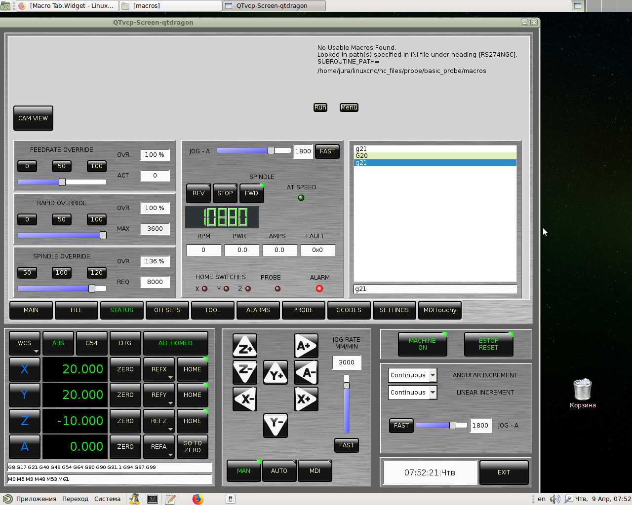

I have three files: go_to_zero.ngc, go_to_home.ngc, auto_tool_zero.ngc.
I put it in the macros folder along the path home / jura / linuxcnc / nc_files / probe / basic_probe /macros. I create an OWord file there. I am at a loss with pictures. What am i doing wrong
please comment. Added by svg icon tab.

So here is how to get one of your file to be found by the tab widget. Note the magic comments:
I see I need to work on the image displaying - the images are not scaled properly when I tested.
; MACROCOMMAND=
; MACRODEFAULTS=
; MACROIMAGE=go_to_zero
; will jog the machine to zero
o<go_to_zero> sub
o<100> if [#5422 LT 0]
G0 Z0
G0 X0 Y0
o<100> else if [#5422 GE 0]
G0 X0 Y0
G0 Z0
o<100> endif
o<go_to_zero> endsub
M2I see I need to work on the image displaying - the images are not scaled properly when I tested.

What size icon_tab.svg is needed? OWord first and second line must beat
empty? Sorry, but I don’t know English, but with google translate I understand
a lot less. I work purely by intuition. Thank you very much.
Last edit: 09 Apr 2020 08:43 by hottabich.
- Posts: 7368
- Thank you received: 2181
09 Apr 2020 08:28 #163341
Replied by cmorley on topic Macro Tab.Widget
The three lines are required so macroTab knows this is an oword designed for macroTab.
The first and second lines are empty because your oword does not require input.
The icon is supposed to scale to size but that seems to be a bug.
