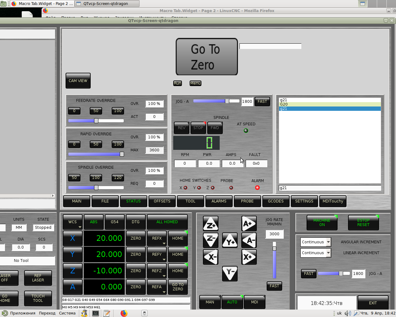

Replied by hottabich on topic Macro Tab.Widget
There is no menu.

Replied by cmorley on topic Macro Tab.Widget
The files need to be in the right path.
put the files in the same folder the others were in
Files here: home / jura / linuxcnc / nc_files / probe / basic_probe / macros
Like this?
home / jura / linuxcnc / nc_files / probe / basic_probe / macros / go_to_home.ngc
Is there an error message in the terminal related to macroTabs?
The folder you posted does not have the modified files I added.
It works if you put so / home / jura / linuxcnc / nc_files / macros. But what about probe?
macroTabs searches based on INI:
[RS274NGC]
SUBROUTINE_PATH =
The problem looks like you added the PNG file but not the NGC files.
in the files I posted, I changed both
[RS274NGC]
SUBROUTINE_PATH =
Everything works!!! I foolishly registered in the QWord file in the macros folder, but I need it in ngc.
I wonder at your patience. Thank you so much. I did not understand the manual.
