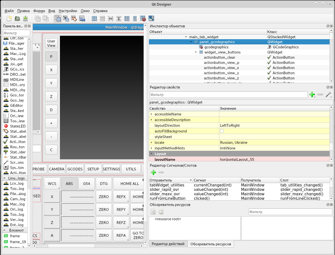

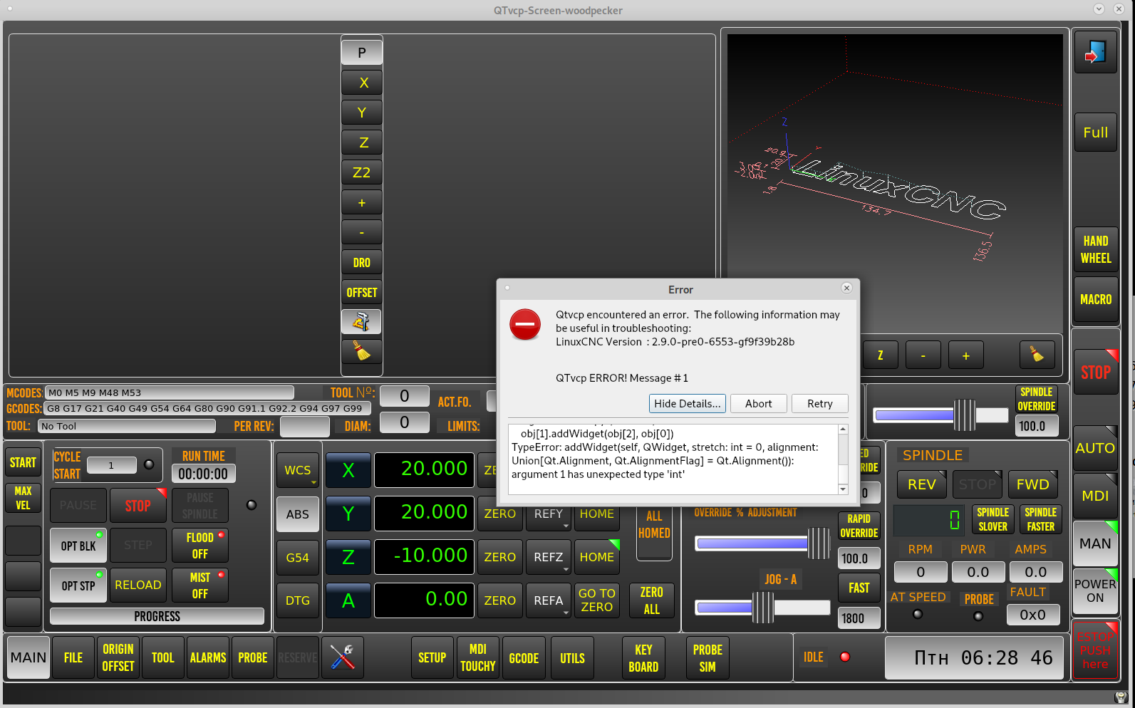

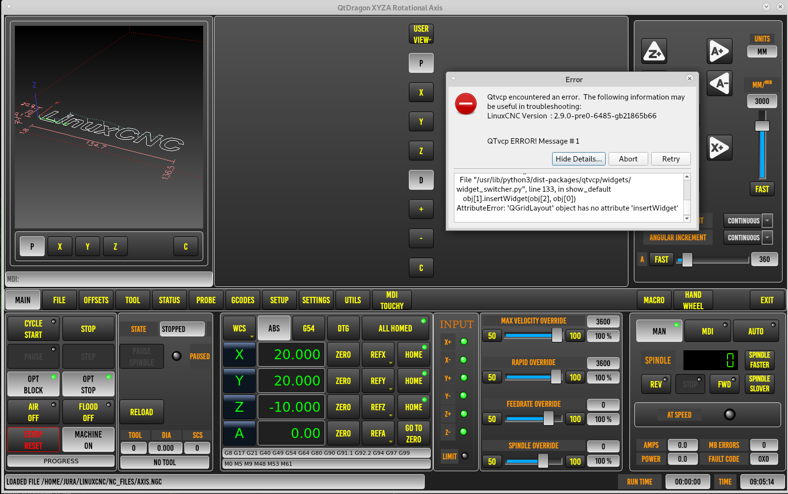

Linuxcnc 2.9.0 QtDragon. Please tell me how to register widgetswitcher. No return of gcodegraphics, error as in the screenshot. Thank you.
- Posts: 7368
- Thank you received: 2181
03 Jun 2022 01:25 #244481
Replied by cmorley on topic Сustomization QTvcp
looks like a bug in widget switcher
'insertWidget'
should be:
'addWidget'
I'll push the fix.
'insertWidget'
should be:
'addWidget'
I'll push the fix.

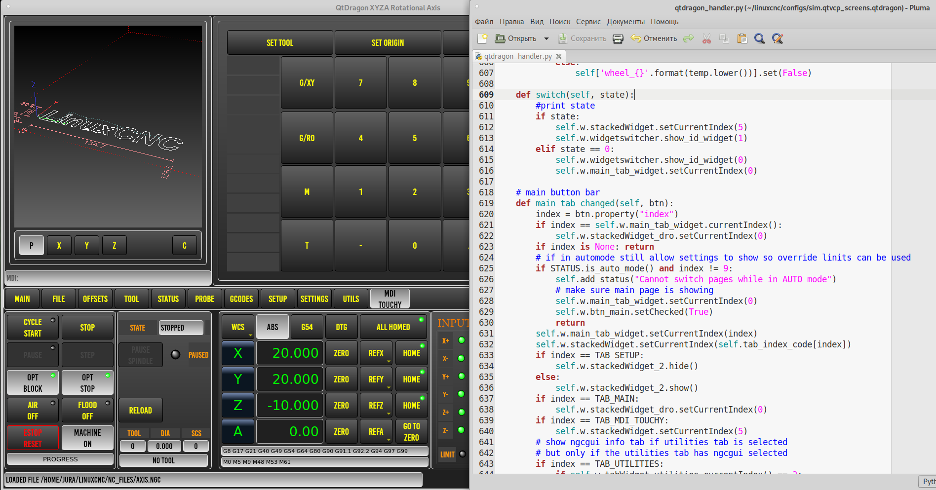

Everything is in order with the widget, everything works in the woodpecker. I am not writing correctly in the handler, but there is not enough knowledge. Please look at two files and tell me what I'm doing wrong?

Widgetswitcher.py please return to the original state after updating the error in the woodpecker.
- Posts: 7368
03 Jun 2022 04:47 #244486
Ok I reverted the change.
It seems Qgridlayout doesn't have the insertWidget function. QHorizontalLayout and QVerticalLayout do.
I'll look later to see if i can add code to handle QGrid
In the mean time just add a QVerticalLayout inside you QGridlayout, then add your widget.

03 Jun 2022 11:19 - 03 Jun 2022 11:20 #244509
by hottabich
Replied by hottabich on topic Сustomization QTvcp

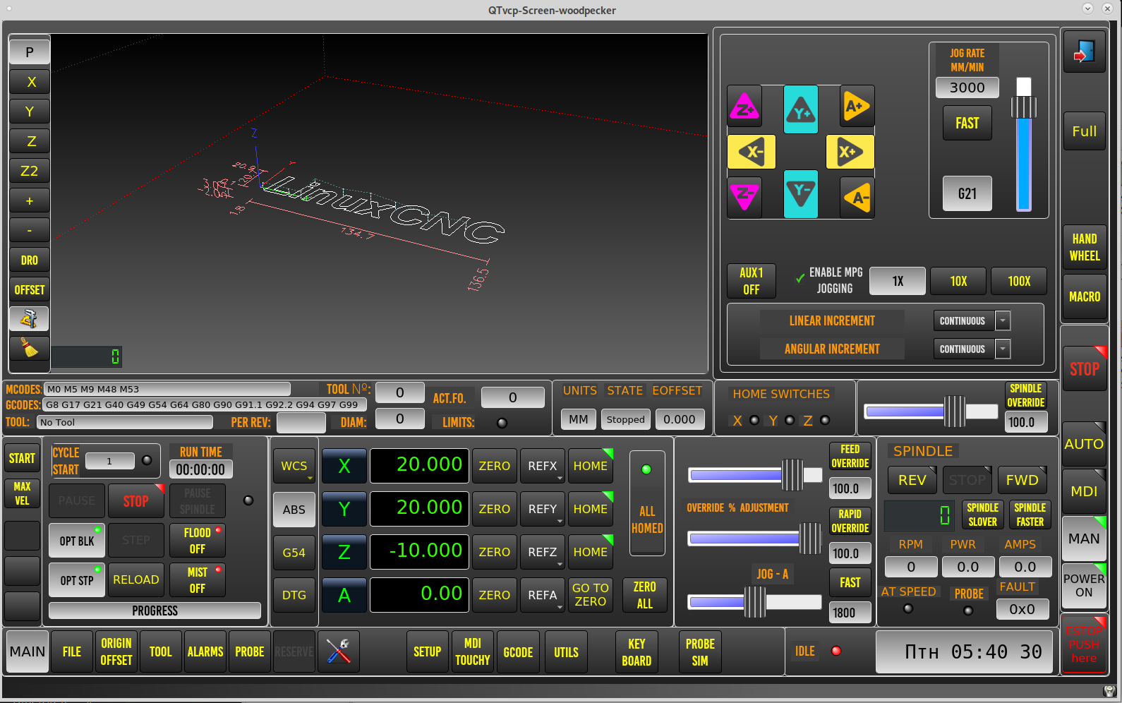

Thank you. Changed the main_tab_widget horizontal layout and it worked. Doesn't work with mesh.

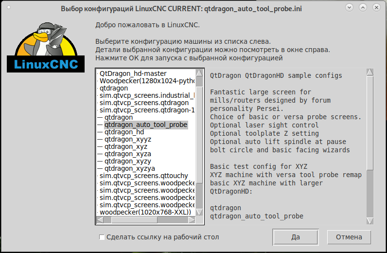

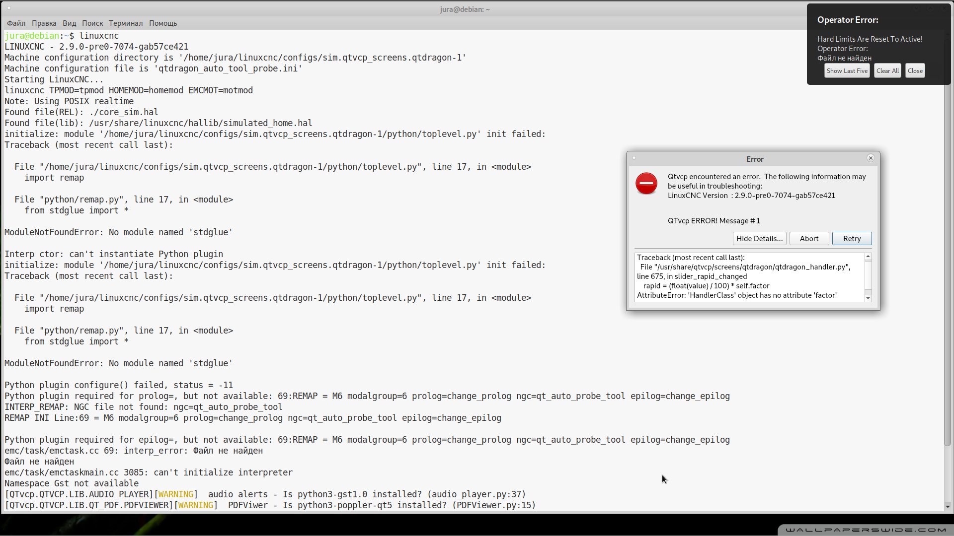

Error in qtdragon_auto_tool_probe. How to fix it? Thank you!
- Posts: 7368
18 Jul 2022 05:20 #247636
looks like it didn't find the stdglue file.
Make sure this:
SUBROUTINE_PATH = ../../../../nc_files/probe/basic_probe/macros:../../../../nc_files/remap-subroutines:../../../../nc_files/remap_lib
actually points to the require folders.
Make sure this:
