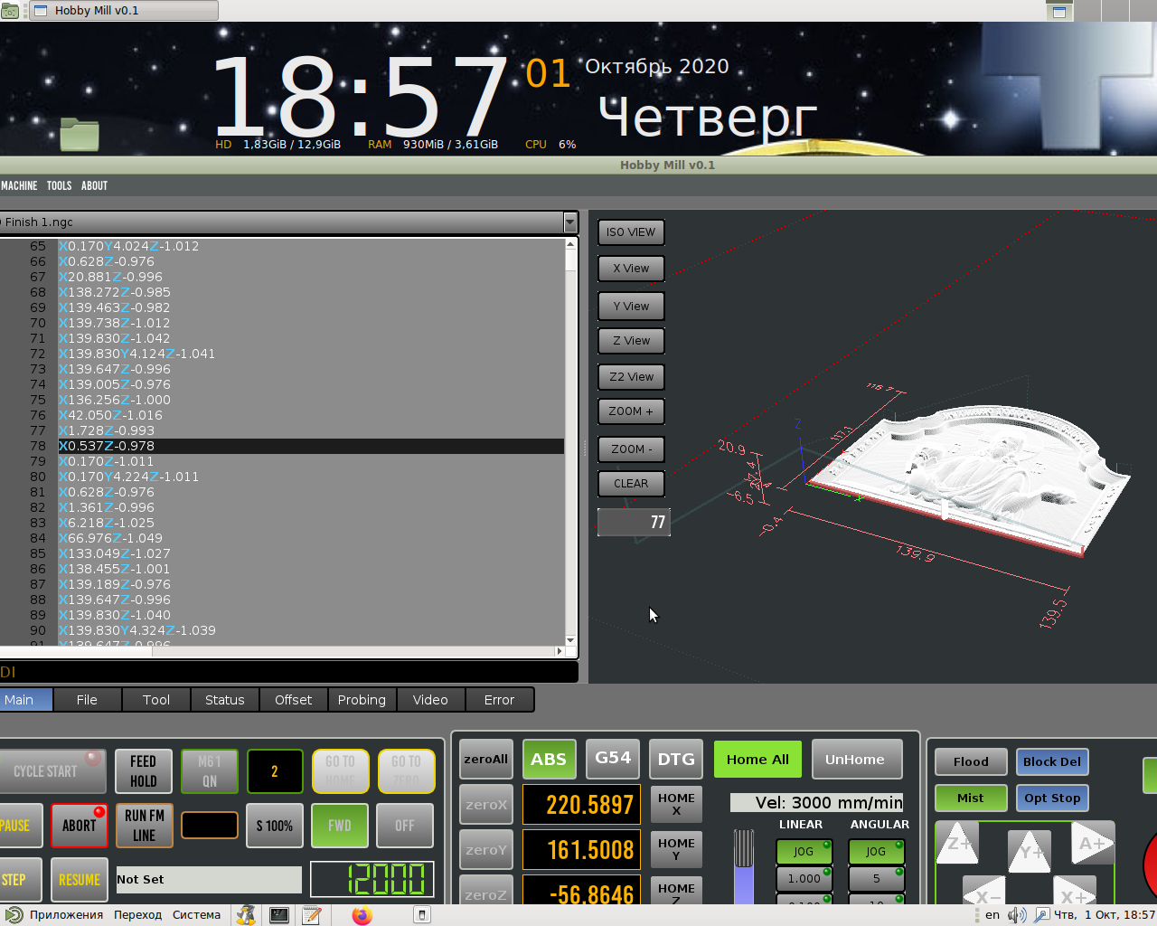

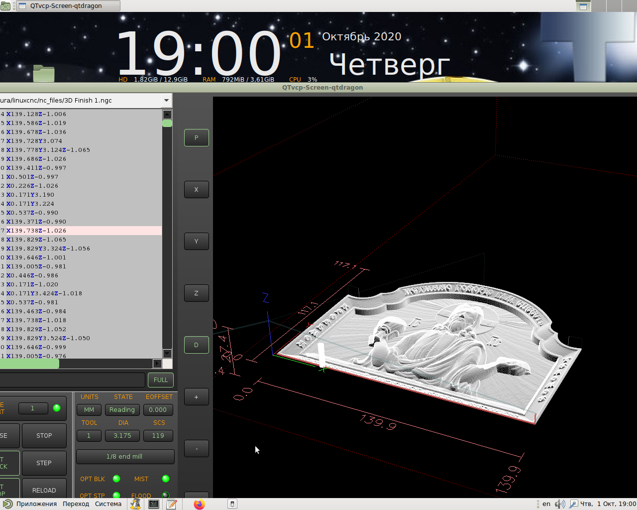

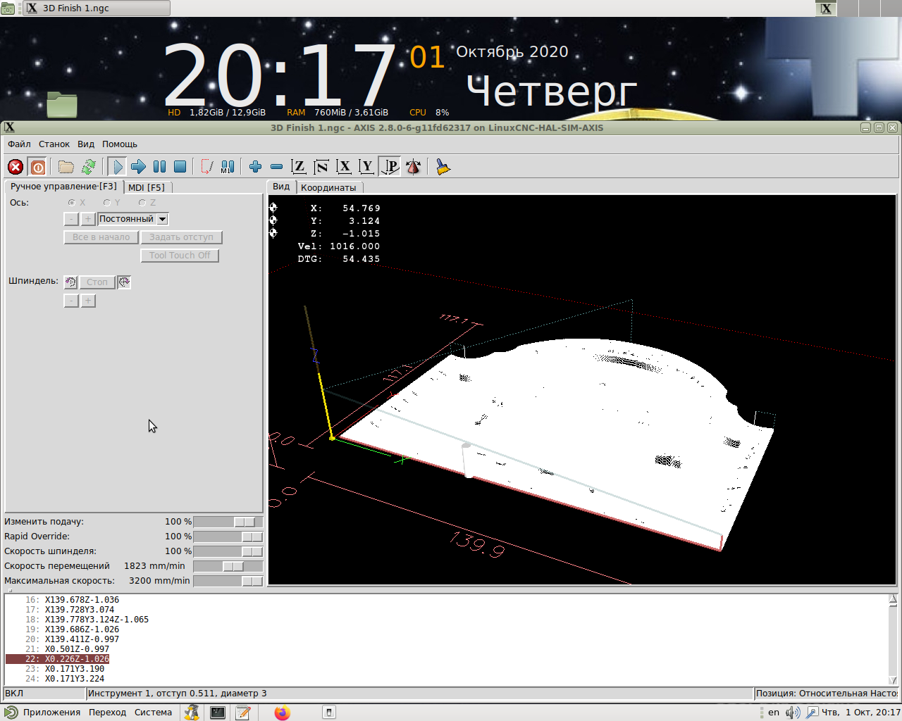

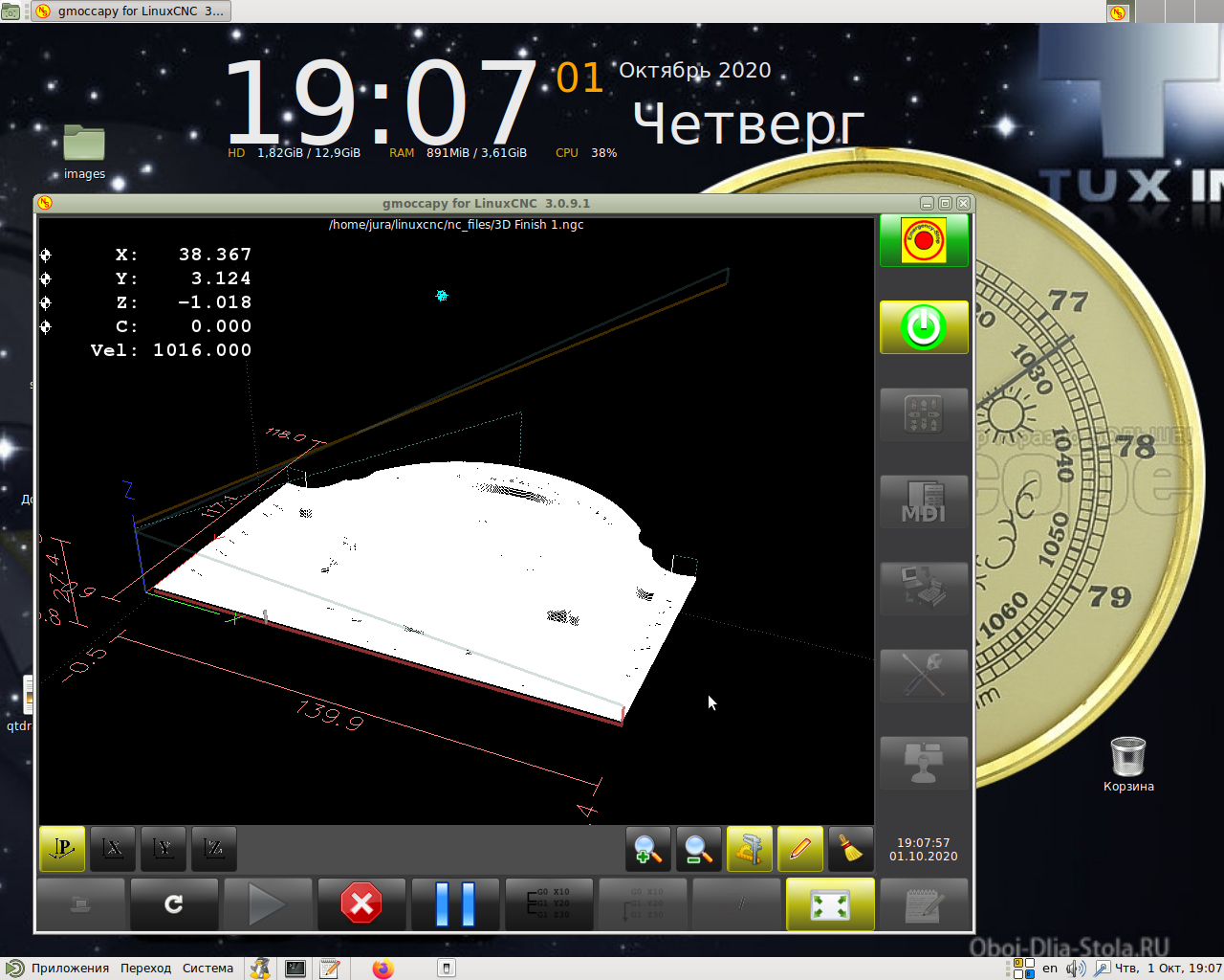

01 Oct 2020 13:01 #184501 by hottabich
Replied by hottabich on topic Any OPENGL wizards?
Hello! Raspberry Pi4 will be something. I would like to draw your attention to the processor load in different interfaces. VTK on embedded graphics does not start. Computer with core i3-530. File 5 MB.
