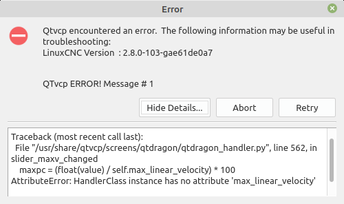

15 Nov 2020 07:47 - 15 Nov 2020 08:30 #189454
by JohnnyCNC
Replied by JohnnyCNC on topic QTDragon Slider Bar
I got the update last night and had a quick look. The jog rate slider looks and works good. I do get and error on startup but if I click retry it seems to work fine. I haven't had a chance to look and see if it is something on my end.
This is getting better all the time. Thank You.
John
Edit:
Looks like this is what was being discussed above.
John
Edit:
Last edit: 15 Nov 2020 08:30 by JohnnyCNC.
- Posts: 7368
- Thank you received: 2181
15 Nov 2020 15:29 #189480
Replied by cmorley on topic QTDragon Slider Bar
Sorry I guess I didn't test enough - I pushed a fix for that now.
- JohnnyCNC
- Posts: 572
- Thank you received: 115
15 Nov 2020 19:30 #189489
by JohnnyCNC
Thanks Chris. I fixed it for the time being. I'm good until the update.
