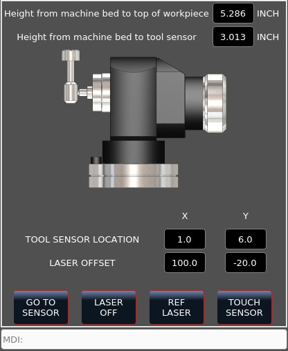

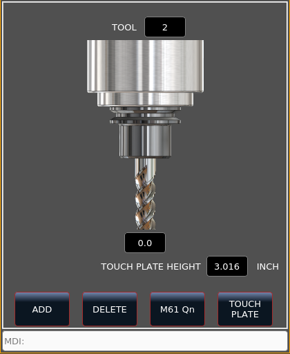

On this screen I don't understand why the "Height from the bed to the top of the work piece" field would be here. The top of the workpiece would be constantly changing with each part. I don't see it being filled when I probe the top of the work. If it did then it would make sense so the operator could see the value. Also, wouldn't we be working from Z zero rather than from the bed since the machine doesn't really know where the bed is? That is unless we probe it and store the value somewhere. I think I stll have a lot to learn.
On this screen would it make sense to display the tool length as set in the tool table or as measured when touched off on the touch plate?
I have been playing with a M6 remap macro and it consistently thinks the top of the stock it .65 inches higher than it is. I can get that number to change buy changing some of the values on the above screens but I would have to lie on the value to hit the target. I'm pretty sure it is something I just don't understand. For now I would just like touch off the stock with my 3D probe to get the stock height. And to have zeros in the tool table for the Z measurement and touch off the on tool setter at each tool change and have it calculate the tool length. I have entered the length of the probe in the tool table for tool 99 but I am not sure that is being taken into account.

29 Dec 2020 22:53 #193484 by persei8
Replied by persei8 on topic QTDragon offsets question
QtDragon has 2 possible methods for setting Z0. The first is a touchplate, where a metal plate of known thickness is placed on top of the workpiece and then the tool is lowered until it touches the plate, triggering the probe signal. Z0 is set to probe height - plate thickness.
The second method uses a tool setter in a fixed position and a known height above the table where the probe signal will be triggered. In order to set Z0 to the top of the workpiece, it has to know how far above the table the probe trigger point is (tool setter height) and how far above the table the top of the workpiece is. This operation has to be done every time the tool is changed as the tool length is not saved. I realize that for an ATC or MTC, the operation is different, where each tool length is compared to a reference tool and stored in the tool table. I'm working with a simple collet spindle. HTH.
Jim
29 Dec 2020 22:59 #193485 by persei8
For touching off with a touch probe, whether you use the touchplate operation with thickness set to 0 or use a probing routine, the height from table to top of workpiece parameter is not taken into account and can be ignored. It is only for the tool setter.
Jim
Jim
The first method is how I have always done it until now.
Between what you and Chris are working on it sounds like a solution. Thank you both. I will gladly volunteer to do testing.
In my mind this would be the work flow:
I would do a one-time setup where I would enter the length of the probe in tool 99. Then with the spindle nose sitting on the sensor I would enter the ABS Z value into tool zero in the tool table.
Then for each setup I would probe the work for XYZ.
Then each time I put in a new tool in it would touch off on the sensor and record the tool length.
