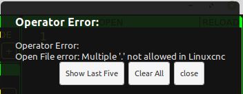

Not sure why, but all of the sudden I get this error when trying to open a file in QtPlasmaC:
Open File Error: Multiple '.' not allowed in Linuxcnc
Unsure if it's a QTVCP thing or a QtPlasmaC thing, I'd assume the first since I think QtPlasmaC is just using the widget.

13 Feb 2021 13:20 #198704
by snowgoer540
Replied by snowgoer540 on topic File Editor Open Error
It just says this:
If there is somewhere else to look, please let me know.

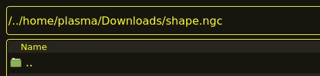

13 Feb 2021 13:33 - 13 Feb 2021 13:35 #198706
by snowgoer540
Ok, I figured out how to replicate it.
My path looks like this /../home/plasma/Downloads/
Clicking .. takes me up a level, but there is no way to delete the /../ in the path.
If I open a new SIM and do a file open, the path is just / and I can navigate to /home/plasma/Downloads. This allows me to open files.
If I click .. too many times to level up, it becomes /../ again, and every path from then forward is /../home/plasma/Downloads, and file open breaks.
Also noteworthy, you can keep clicking .. and get /../../../../../../ There is no way to delete these that I can tell.

- Posts: 7368
- Thank you received: 2181
13 Feb 2021 14:30 #198714
Replied by cmorley on topic File Editor Open Error
Ok I pushed a fix for the ../../../ problem which should fix loading.
The jumplist problem is stil amystery.
